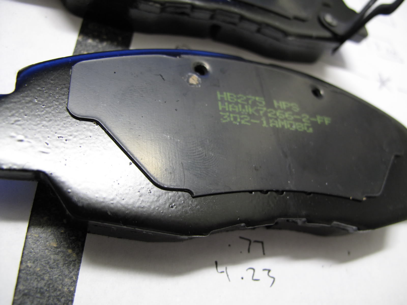

you're not suppose to put the OEM shims back on for the hps/hps+. they have their own vibration shim attached to the back and its already glued on.
like so:
