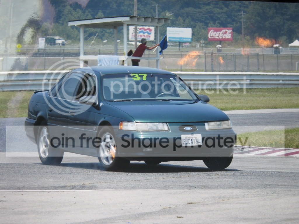

How's this for a brake fire?... This is one of my buddies at a SHO convention.
