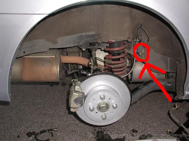

Old Dec 13, 2005
PunkingCivic's Avatar
I need TP for my bunghole
Posts: 7,103
Rep Power: 360
The bracket to the right with the brake line.
Use those bolts

^^Just to clearify, you mean the two bolts thats bolted to the frame?

Boilermaker1's Avatar
Jap-Euro Fusion
Posts: 13,151
From: Washington DC
Rep Power: 425
Clarified
The step thats often missed is RELEASE THE E-BRAKE. If you try to pull the drum with the e-brake on, it'll never come off.
Once the e-brake is off, you can probably just whack it with a mallet (a rubber one) and it should pop loose.
