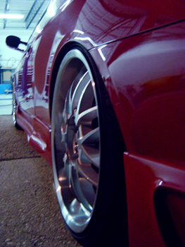

Anything else other than 3mm spacer you really need to get longer studs. I was ****in around one day and put 6mm (1/4in) spacers on th rear to see what it would look like. Cleared fine dropped around 3" w/19's w/trimmed rear lips. However, I would have never ran them with out changing the studs as I only got around 3 full turns.
