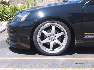

attached is a picture of a civic that has neuspeed race springs and 17" wheels, just like me. what tire size is that? is it 215/45? if they are, doesnt' look too bad to me and i might as well go for those.
oh by the way, thats a pic of yourinmyw0rld's car. lol, sorry if it bothers u for usin ur pic, but i remembered u had a similar setup to me.

Old Sep 21, 2003
BigDaddyHonda's Avatar
Joined: Apr 2001
Posts: 484
From: Tennessee, US
BigDaddyHonda is an unknown quantity at this point
If you use the Tire Calculator along with the specs of the tire that you are considering, you can find out a few things that might help you make your decision.
The 205/40-17 has only 3.23 inches of sidewall between your new rim & the road.
Going to a 215/40-17 only gives you a whopping 0.16 extra inches of protection/gap filler (3.39" sidewall)
To really make much difference lookswise & protectionwise, you would need to go with the 215/45-17 (3.82" sidewall). But you DO have to be careful about the offset on those wheels - I don't know what the minimum number is for a 7.5" wheel where a 215/45-17 tire won't rub. Do you have the offset of your new wheels?
You have one other choice that is less likely to rub, but still gives you a sidewall with some protection & looks (it has a 3.62" sidewall): 205/45-17 The selection of tires to choose from is a lot smaller, but you can still get Yokohama AVS ES100, Yoko Parada Spec2, Kumho
