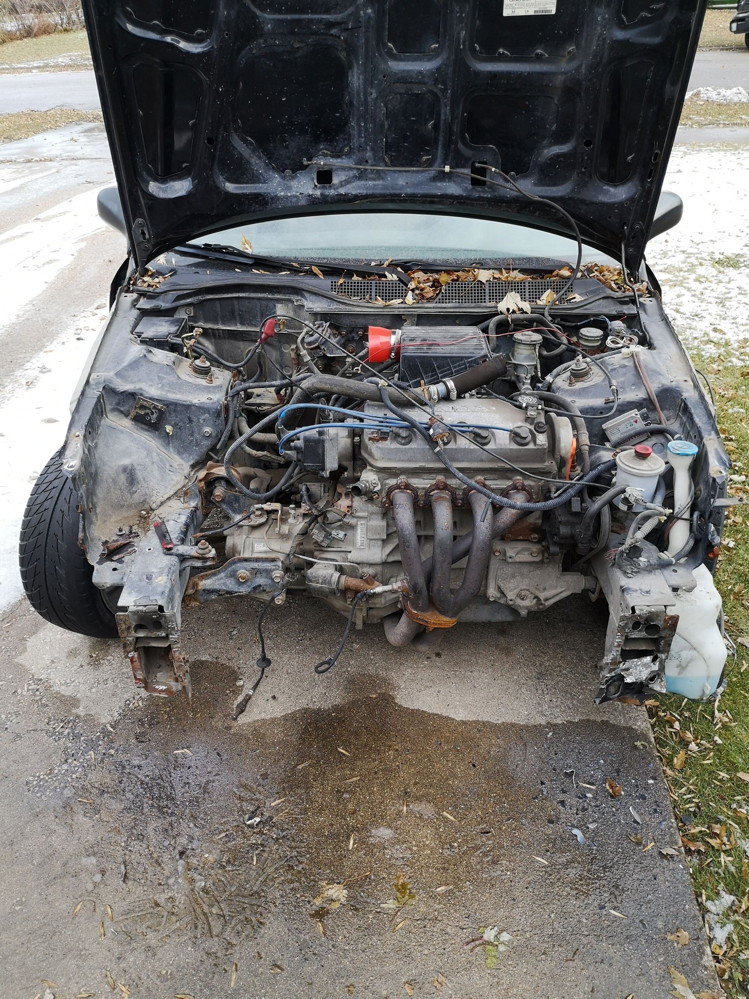

This is basically all I've done to the car since November 2019. The radiator support and bumper were damaged, so....why not cut it off? This should also make it easy to remove the engine if and when I decide to do that. I did get a B20 block and B16 VTEC head that are sitting in my garage currently.
Holy shitballs, you got your work cut out for you. I fully support your endeavor, and respect your admission to doing stupid fun things. I just ask one thing: listen to our advice (and toss that disclaimer around that you're doing unique/innovative stuff) and don't fight us when we say stuff. Particularly if we say something will be more expensive than its worth or will do more harm than good. Prolly one of our biggest pet peeves. Now, caveat there, if you tell us that you don't care about the price tag on doing [x], we'd be more welcome to your ideas. I don't want to deter you from taking on this project, just telling you how it is. That said, I'm excited to see where this goes.
Also a bit of an anecdote here: I started on this forum when I was 19 (now 36, 37 in November -- yeah, I've been here forever). First new car, didn't know **** for automotive work shy of doing oil changes, changing a tire, and doing disc brake pads (and assisting with brake shoes). Now, I'm probably one of the go-to people for advice on car work; I've done head gaskets, engine tear downs, headlight retrofits, just to name a few. All thanks to this forum and the amount of knowledge around here. Hell, on another car forum I'm on, I found one of my threads here linked over there as a "I followed this dude's DIY guide and it was straightforward and detailed as hell. Probably the best DIY out there!" and it was in regards to my tweeter install in a 10thgen civic hatch. Stick around, be active, make some internet stranger friends, and you'll be good to go.
edit: I guess it should be noted that a bit of my mechanical know-how should be credited to the Navy. Was in for 6 years from 03-09 and they trained me to be a mechanical engineer in a (shipboard) nuclear power plant. A lot of the mechanical theory translates well.

your tires... they seem to be mounted inverted...
Must be an optical illusion, because they're on the car normally. At least, that's something I didn't change since getting the car. Do you think they're directional and were mounted wrong?

there should be arrows in the sidewall pointing the right direction. if not visible, they might be on the other side

those treads should form a V shape with the point of the V pointing toward the ground when looking at it from the front. They're designed to toss water to the sides, not toward the center.
Just take a look at the rest of your tires, and see which ones with treads looking like / || \ instead of \ || / on the driver's side and swap them

https://www.firestonecompleteautocar...heir-benefits/
https://www.tirebuyer.com/education/directional-tires
water is evacuated from center to outside of tires, the way your tires are now, they will push water towards the center of the tires and aquaplaning.
(Bikes use reversed in front, cars use arrow tips going in first

Haha! Thankfully I've only driven it home after buying it. The previous owner was a strange one for sure, so the tires being wrong doesn't surprise me in the slightest. Nice catch folks!

not a huge issue if you were driving on dry pavement
