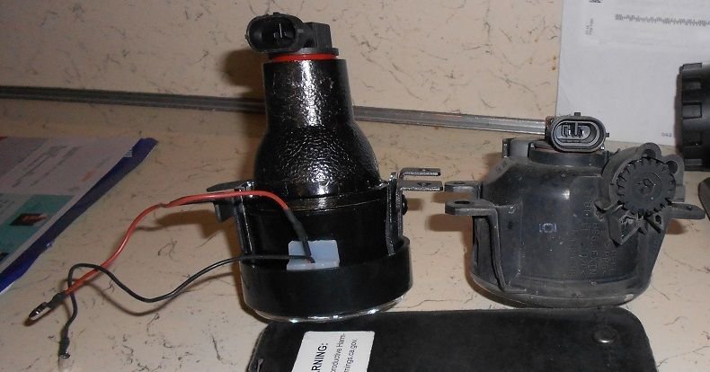

It was not plug and play, but they are in. Required cutting the plastic behind the original light out with a Harbor Freight oscillating tool, because the projectors are longer. Also lightly trimming the mounting pins so the bracket will set over them. Drilling the mounting bracket hole, where it goes onto the light, further back, to move the light back a bit more.Trimming the tail end of the bracket to allow for the moving of the bracket hole. Also needed to put spacers between the bracket and the light on each side, to spread the brackets far enough apart to set properly over the mounting pins and screw holes. The drivers side plastic tunnel, that touches the light had to be sanded a bit to allow the exterior trim to snap in place. The passenger side trim snapped in without modification.

Much deeper than the factory light
Projector fog lights

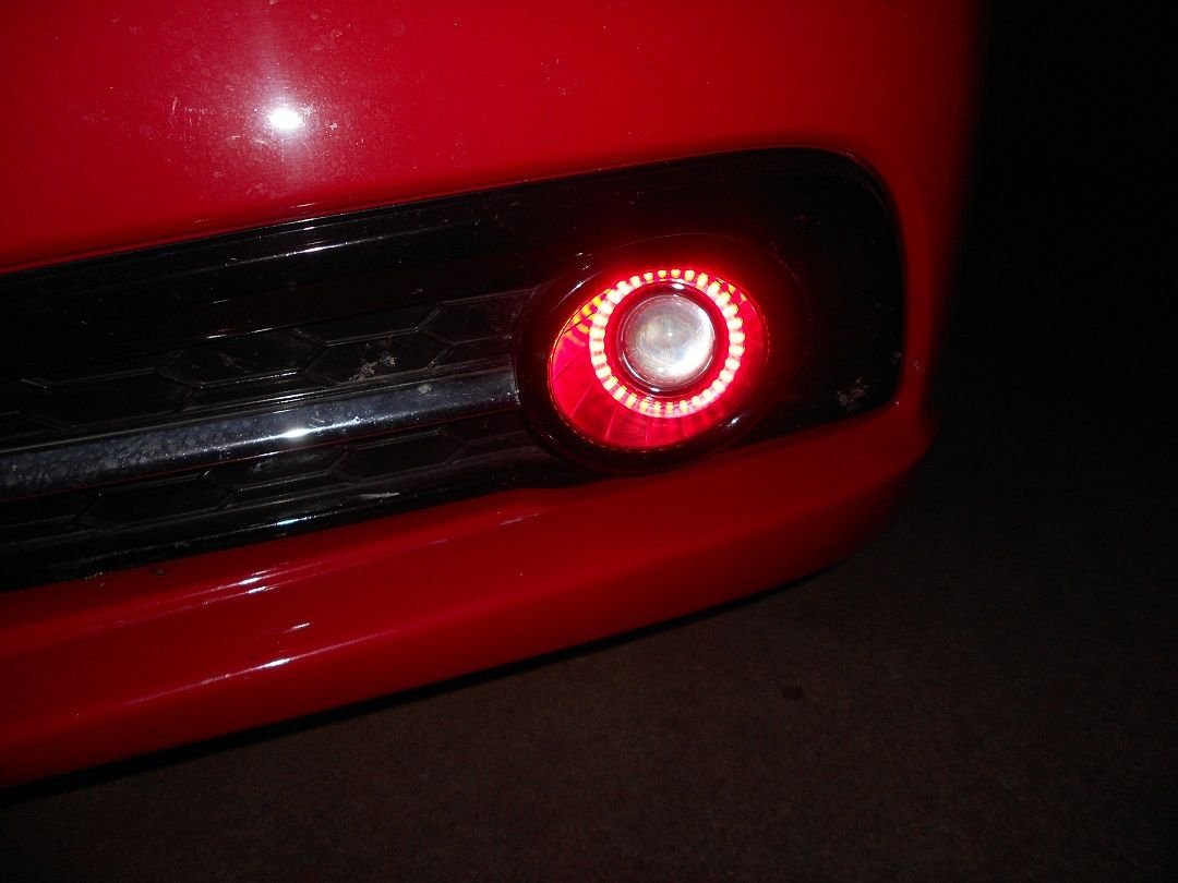

Close up of halo

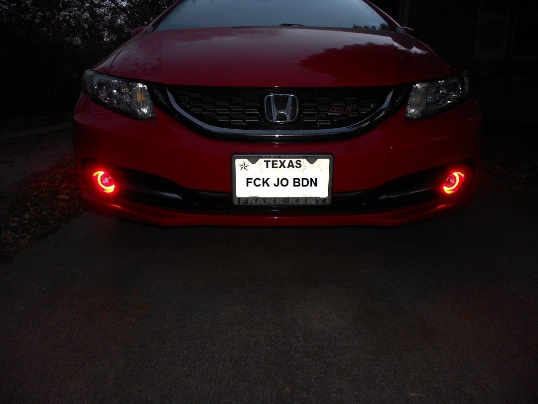

10th Gen Halo fog lights installed on a 9th Gen Si
