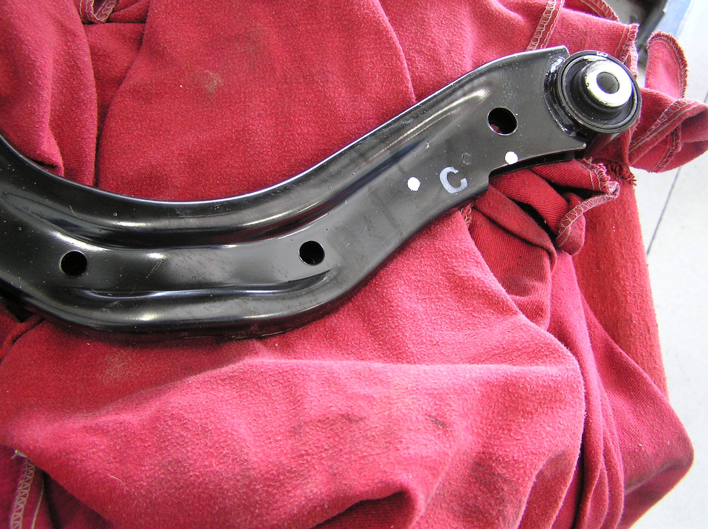

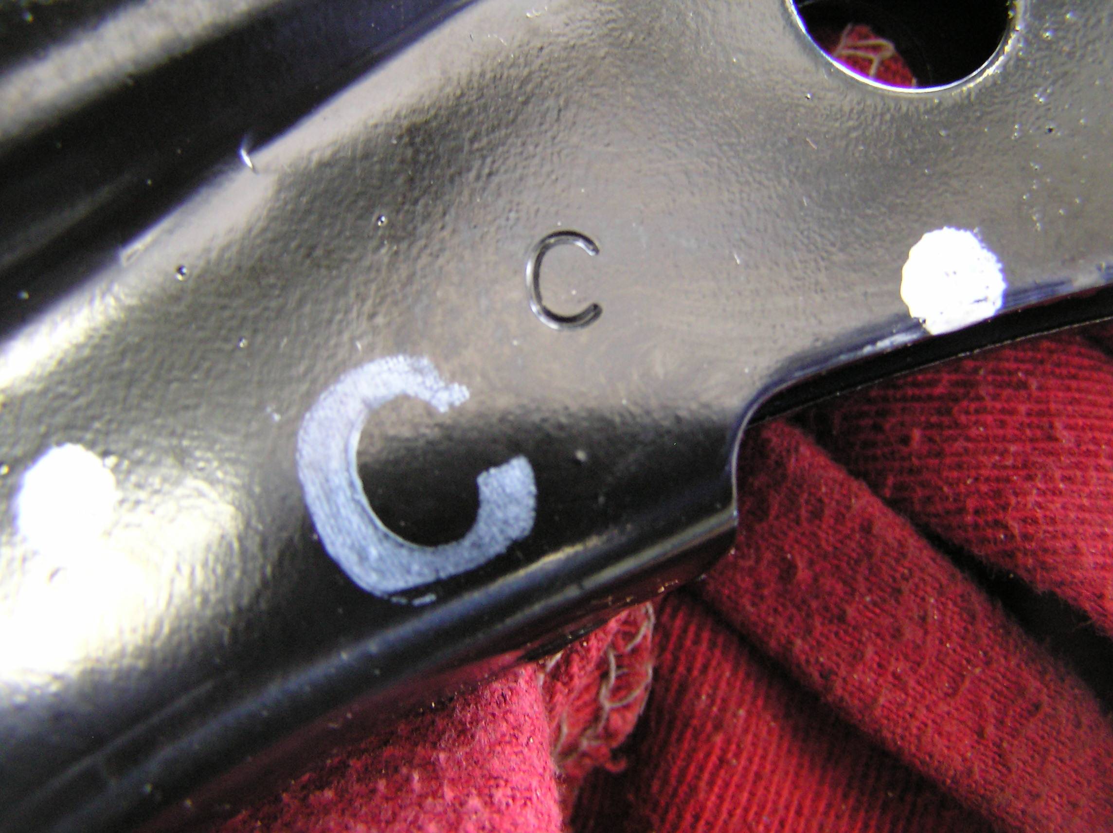

So, if you are going to modify,
First, see if your car already has the updated arms.
There is a "C" either stamped, or painted on the updated arms.
Each arm is only marked on one side, so you might have to hunt for it and wipe off dirt.
If they have already been done but you still get choppy tires, it might not be the cars fault. I have said this before, the arms only reduce the tendency, not eliminate it. Almost any car can develop choppy tire tread if conditions are right (or wrong? whatever).
I got a pic of this one that has both a stamp and paint as an example
(Warning: Freekin huge pics ahead)
