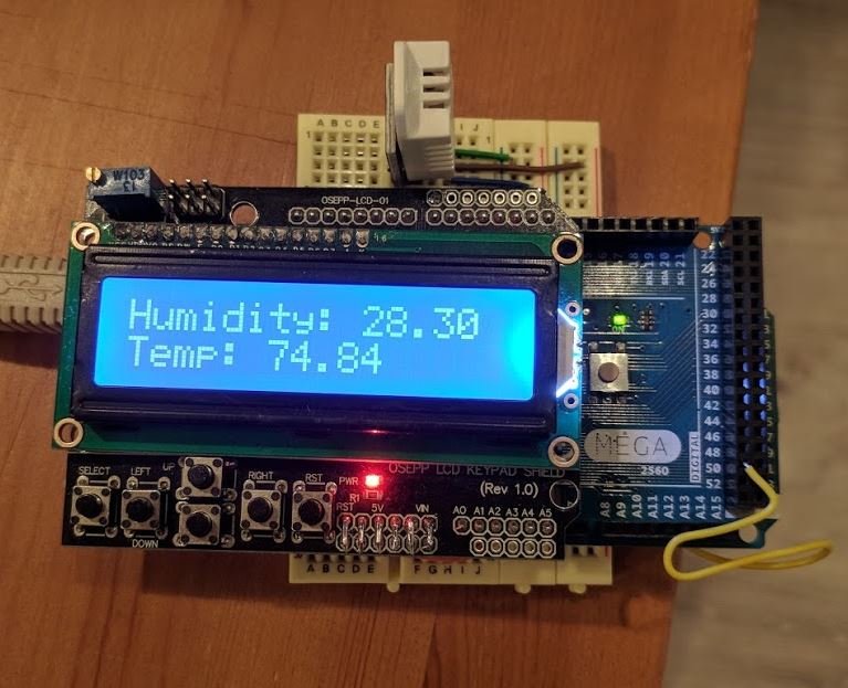

this is the process i use to recalibrate the sensor on my arduino. you might remove the sensor from the car and try recalibrating it with the method below.
Step one: Keep the DHT sensor at the condition of Temperature 50~60Celsius, humidity <10%RH for 2 hours;
Step two: Keep the DHT sensor at the condition of Temperature 20~30Celsius, humidity >70%RH for 5 hours.
it may or may not work, but it's free and worth trying. you can ignore the humidity part as your sensor is temperature only. i learned about recalibrating these on accident because i'm building an arduino to control a humidifier for my printer room. the process above did help with my little cheap DHT22 sensor, maybe it'll help you too.
