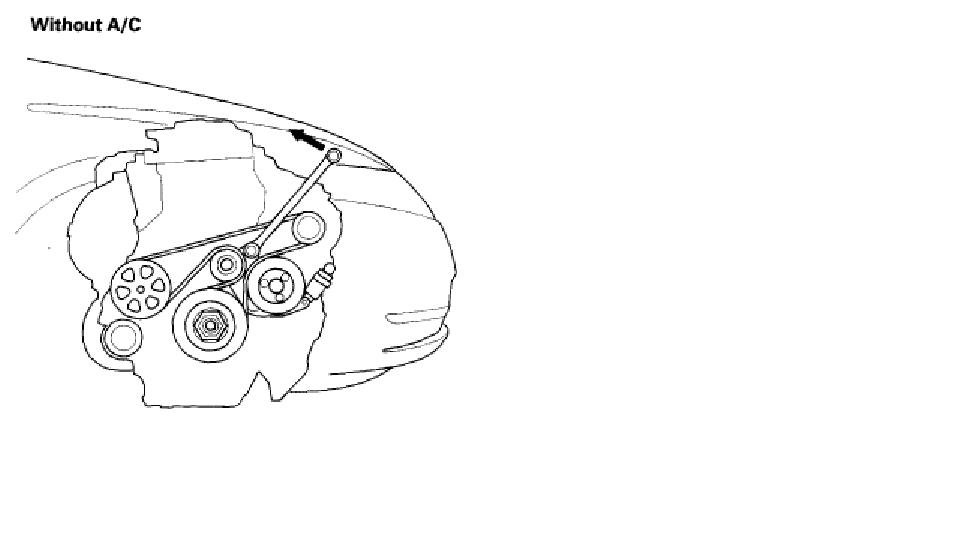

You can just use a shorter belt to bypass the compressor.
Ask for a belt for a DX version of your car -- without AC.
No need to remove or change anything other than the belt for this, leave the compressor alone.
Belt routing for no A/C:
Once the belt is removed, spin the compressor pulley and see if the pulley bearing is shot.
Nice. I'll probably go this route. Too late in year to drop $700 for AC I won't use. Thanks!

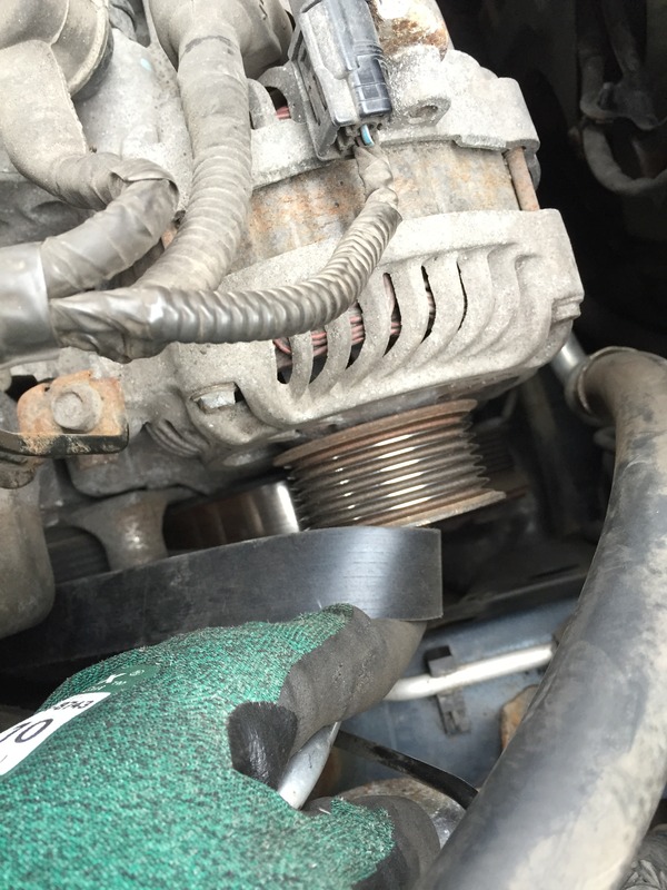

Well, I got the non a/c belt almost on but it seems too short... by a half inch or so.
What do you think? I'm moving the tensioner as far as I can and i still can't get it to go.

Looks like when the correct length belt isn't fully seated on all of the pulleys at the same time......or if it really is seated properly, then belt is too short.
Your picture does not show you having the tensioner pulled back, and if so the belt WILL NOT wrap around the pulleys like that.
You must apply steady pressure to the tensioner and it will retract very slowly as there is a damper attached to it (shock absorber) that makes it hard to move.
What belt brand and part number did you get?

I know. I don't have the tensioner pulled back for the picture. I figured it would be a lot closer to fitting without the tensioner pulled back. With the tensioner pushed up as far as I can, I'm still what seems to be 1/2" shy of getting it on.
I'm taking the car in to Honda for the airbag recall Tuesday. They are going to put the shorter belt on (or at least try). All I have to do is get the old belt back on... Why couldn't Honda use the standard 14-15mm for the tensioner. FN 19mm isn't easy to find. I was using a 19mm 3/8" driver ratchet with a cheater bar... It broke.
Time to go to Harbor Freight for a couple cheap 19mm wrenches.
