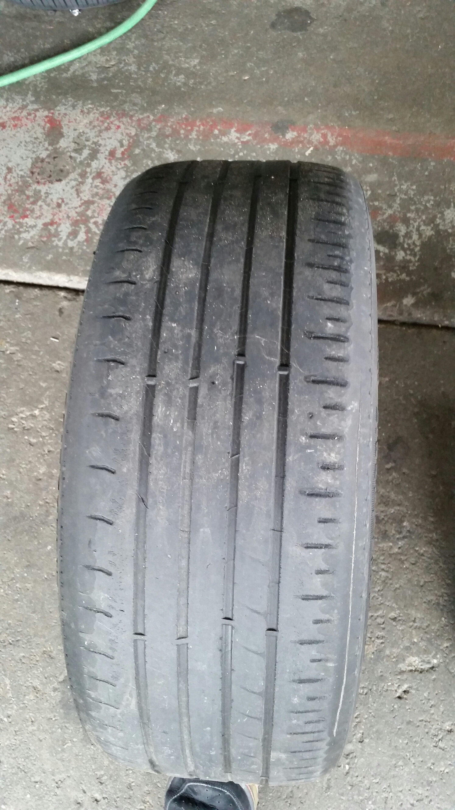

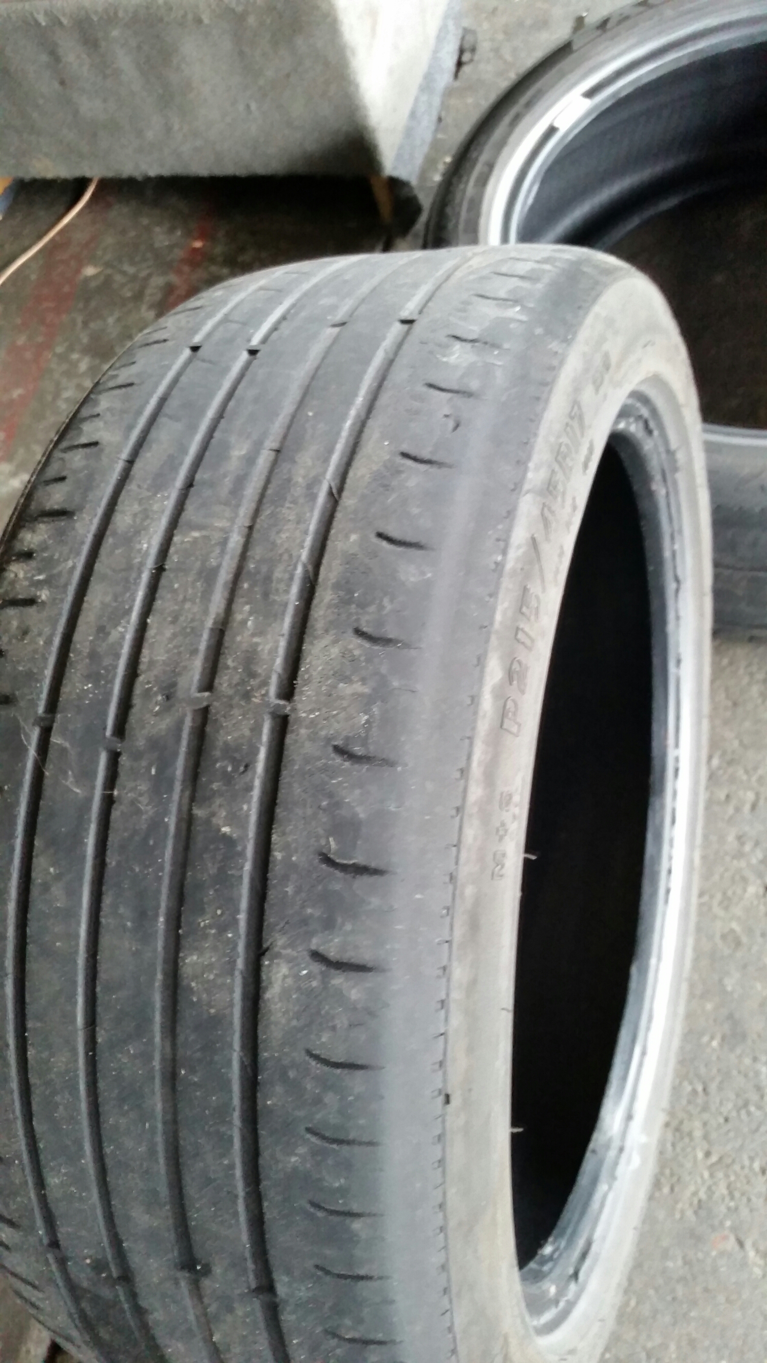

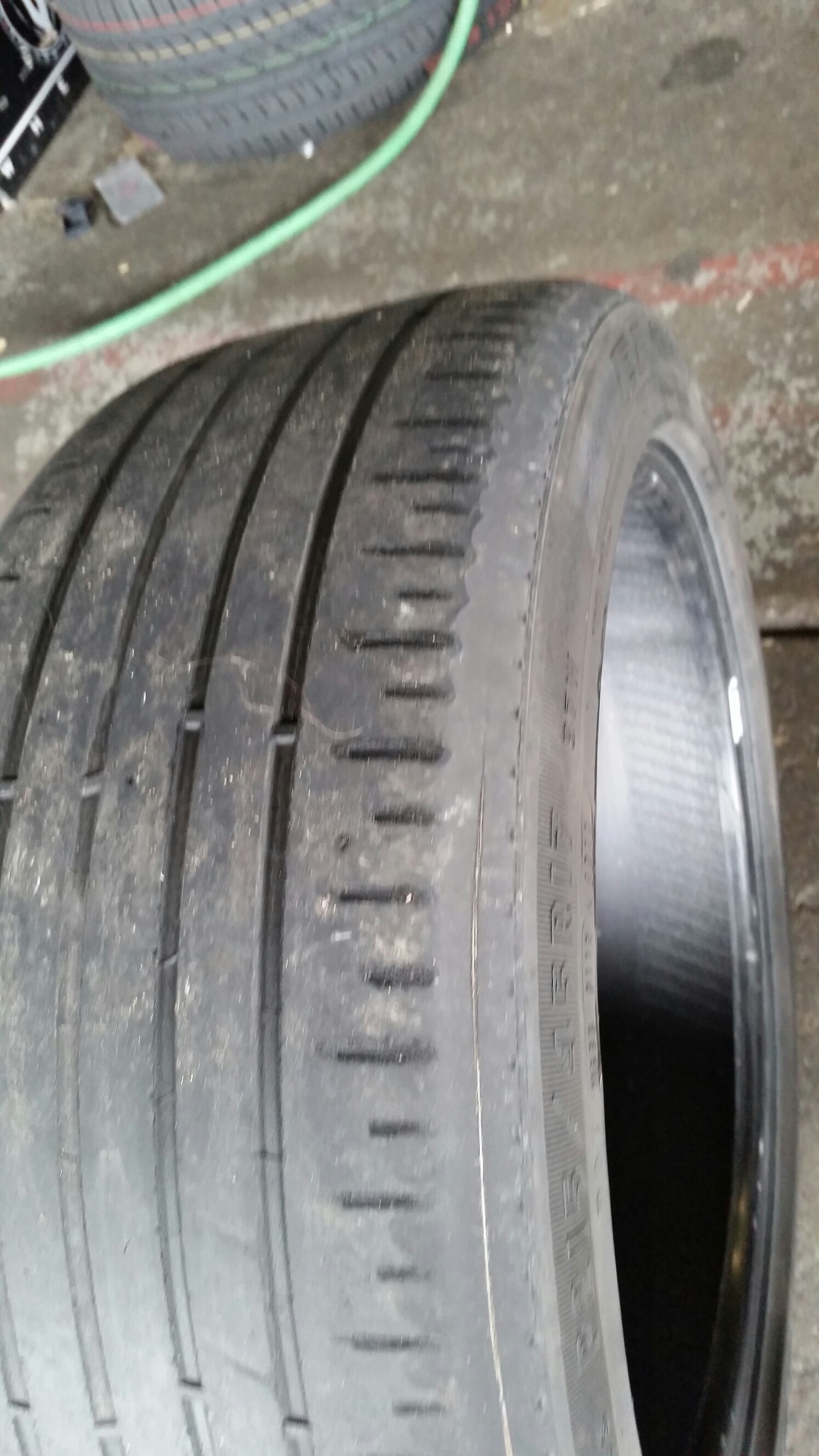

So I recently had to get 2 new front tires on my 2006 civic si .... and when doing so I was advised that I get a front end inspection immediately due to the wear on my tires ....I was pointed out that it wasn't wearing down evenly... any suggestions would be much appreciated.

Front AND rear inspection....
4 wheel alignment needs to be done too, if the suspension doesn't have other obvious problems.
Where did you get the new tires?

that seem to be more than alignments - it's rubbing against something.
Take to a shop ASAP to inspect what is going on down there.

It's not rubbing on anything its wearing down on the inside & the outside of the tire more rapidly.

Re: Front wheel tire tread issue's
Looks like the first tire has worn down to the wear bars pretty even all the way across plus some extra wear on the inboard edge..... might be a little "toed out".
Other 2 show some inboard edge wear too.
The cars do wear inboard edges a little more due to negative camber in the design (especially in the rear), but incorrect toe adjustment will aggravate that in a bad way.
Even if the alignment were perfect:
Underinflation eats both edges of a tire,
Too long on the front eats both edges, plus they wear about triple the rate of the rear tires (lack of tire rotation maintenance)
rears tend to eat inboard edges and can get choppy if tires aren't rotated regularly
Probably just need to check everything for being tight, then do a 4 wheel alignment check-- and as long as the camber (rear) and caster/camber (front) are within reasonable specs, correct the toe settings or add a little toe-in.
And rotate tires on a regular basis.

I ended up having a friend who manages a Discount tire shop take a look. I had them do a full inspection and they walked me through it. Besides my bushings being shot, cracked and useless the wheel had excessive play 6" inches on the front tires ..when I was told it should have none when getting an inspection. So I ended up getting the front end done. Front lower control arms and front and rear alignment.
