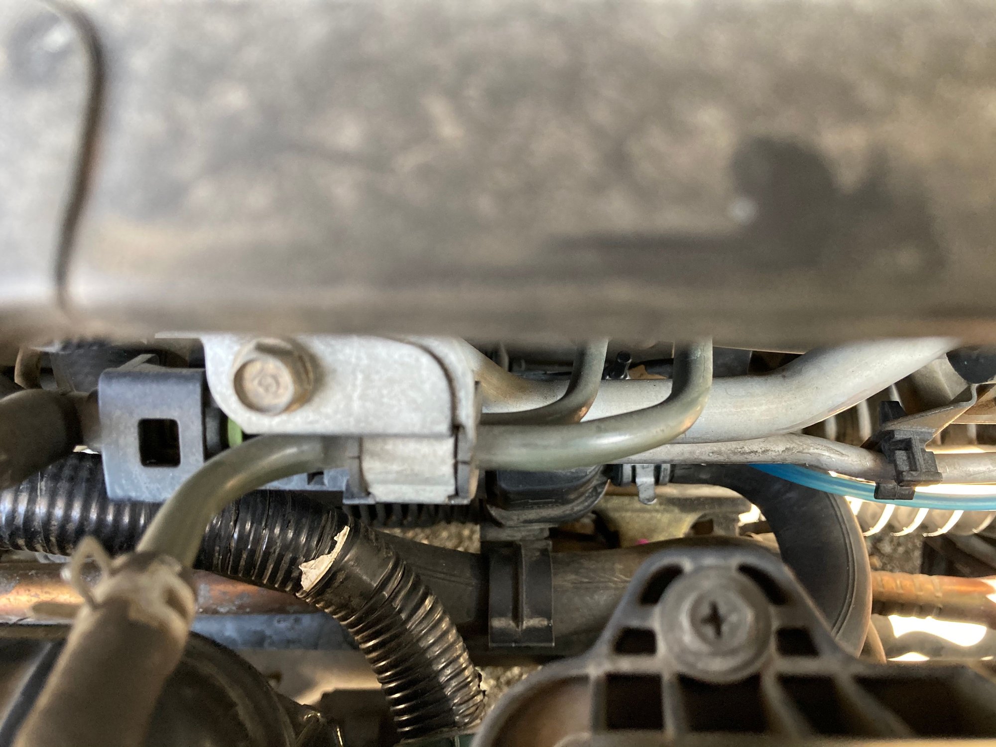

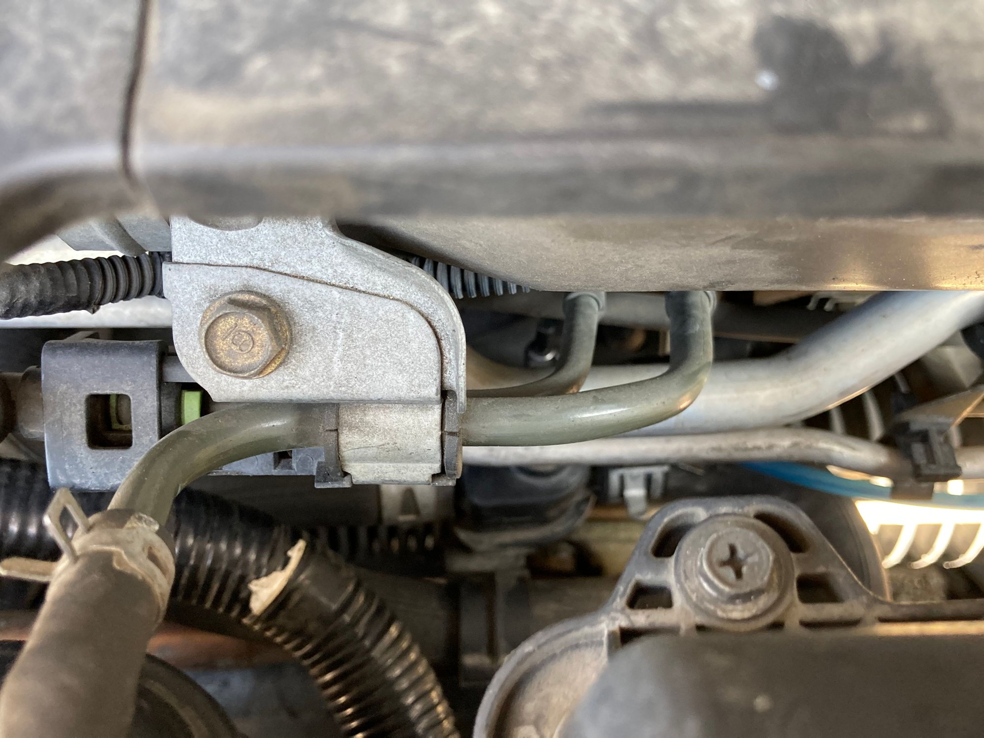

Echoing the same issue here. Heat will only come on with about 3000 RPM, and when it does come on it works fine.
I replaced the coolant, bled the system, flushed the heater core (rather gently) and replaced the thermostat. No issues with overheating. I'm wondering if it could be the heater valve or linkage. The other common suggestions have been poor circulation (clogged core/water pump). Can anybody comment on how much "throw" the heater valve is supposed to have? It looked fine when I took it all apart, but I didn't pay close enough attention to remember how far it has to rotate to fully open. Looks like I'm only getting about 30 degrees of rotation.
Full cold
Full heat
