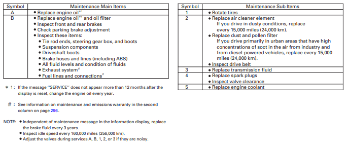

All these captures are from the Honda owners manuals on their website.
For the 2013:
The 2009 should have a similar system, actually. On the instrument cluster, switch over to the oil life meter and you should see the same A/B12345 codes on the left hand side
And here are the code meanings
