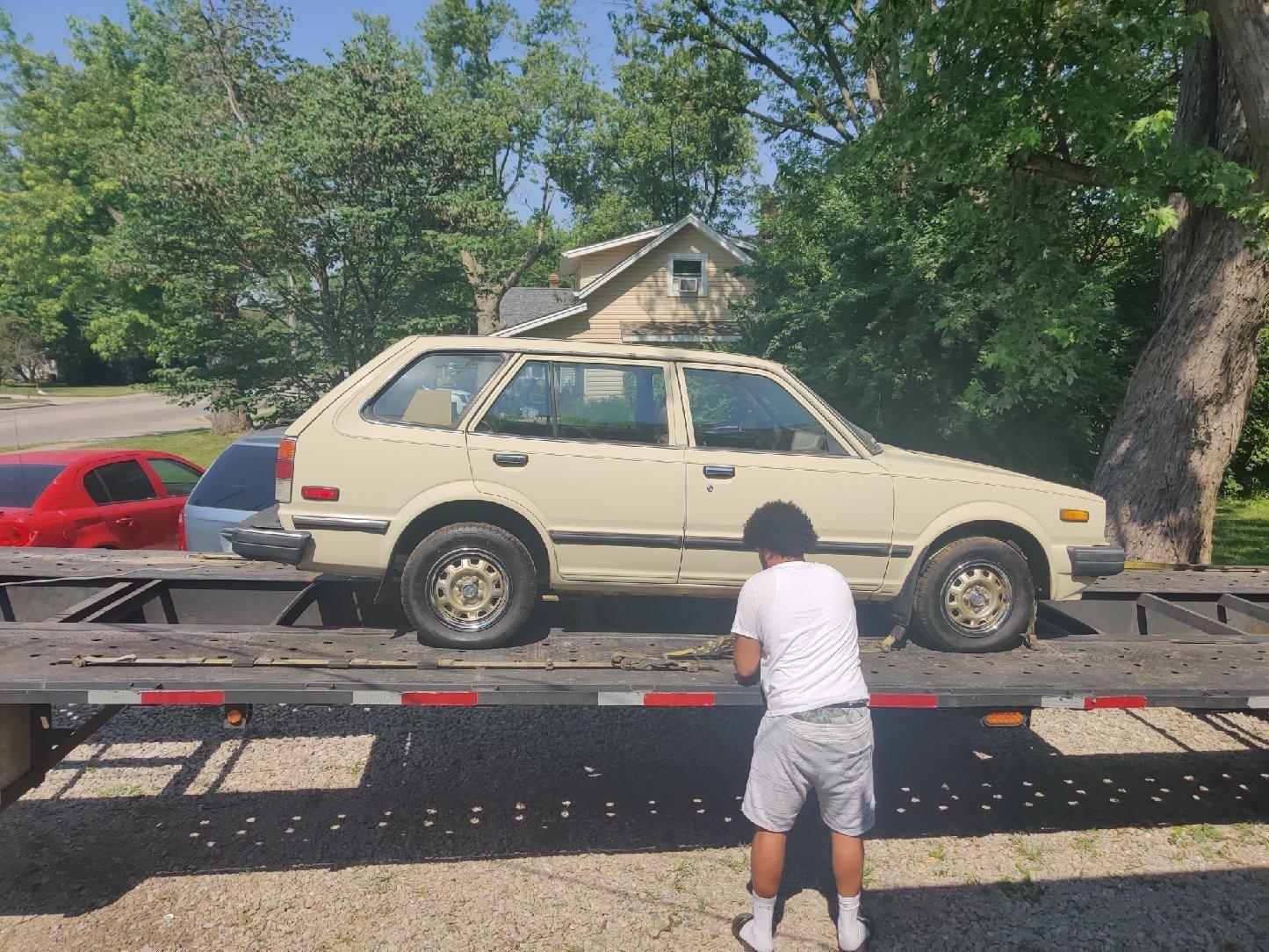

Hi all,
I have a shell here that needs some love. She's a 1983 civic wagon, no rust, garage kept. The motor is toast. The 5 speed manual transmission seems fine.
There is a 1.8L 1984 Accord motor with very low miles at a junkyard close by for a reasonable price.
Does anyone know if the civic 5-speed trans will bolt onto that motor? Will the accord motor bolt into the existing civic mounts?
I could not find a replacement motor for this civic anywhere in the country.
