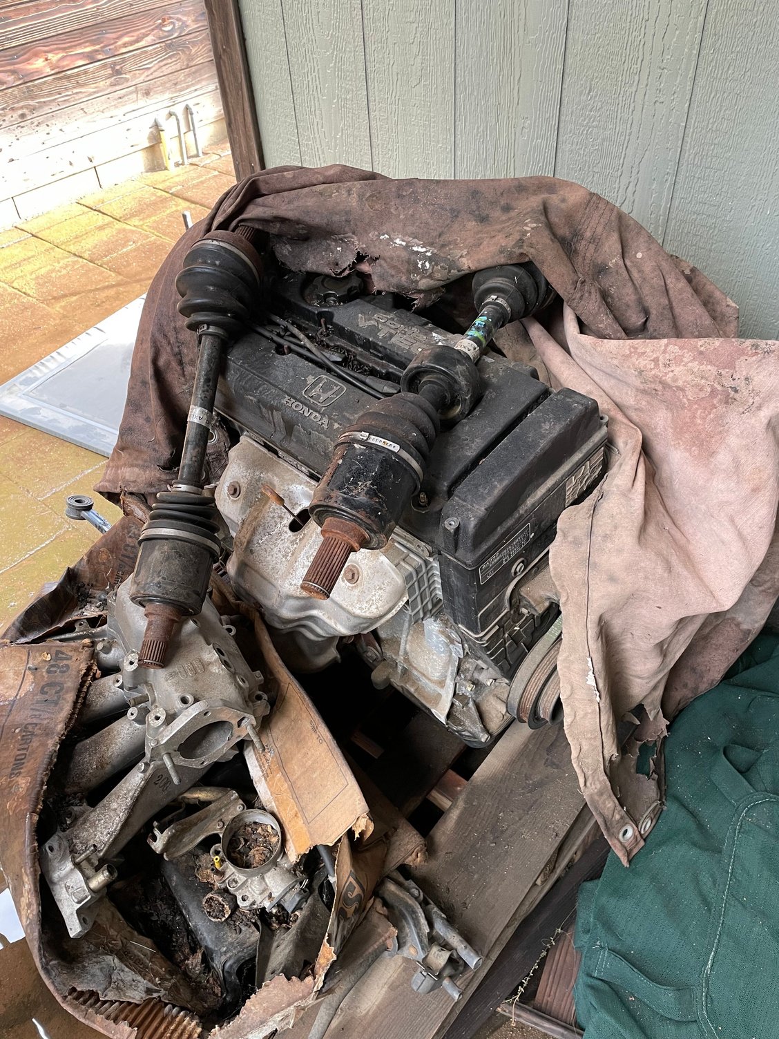

my friend has a photo of the engine but is in a bad angle to see the engine code sticker. but if you look at the photo the information at least is in Japanese. I dont know if this helps but if it does, thanks
. My friend is going to look at the car more tomorrow and take photos for me.

Yeah, nothing there helps me in the slightest. All I can see is that it’s a VTEC b series.
Does your buddy know how to check the engine code or was the code simply what he was told when he bought it?

here is a better photo of the engine code.
so any b series transmission will work? and where would be the best place for him to get one? thanks

Well that engine has a trans attached to it...
Get that one

That’s a GSR engine. Much more common but still awesome. The YS1 is geared short so it should be pretty quick. Highway driving will suck though.
