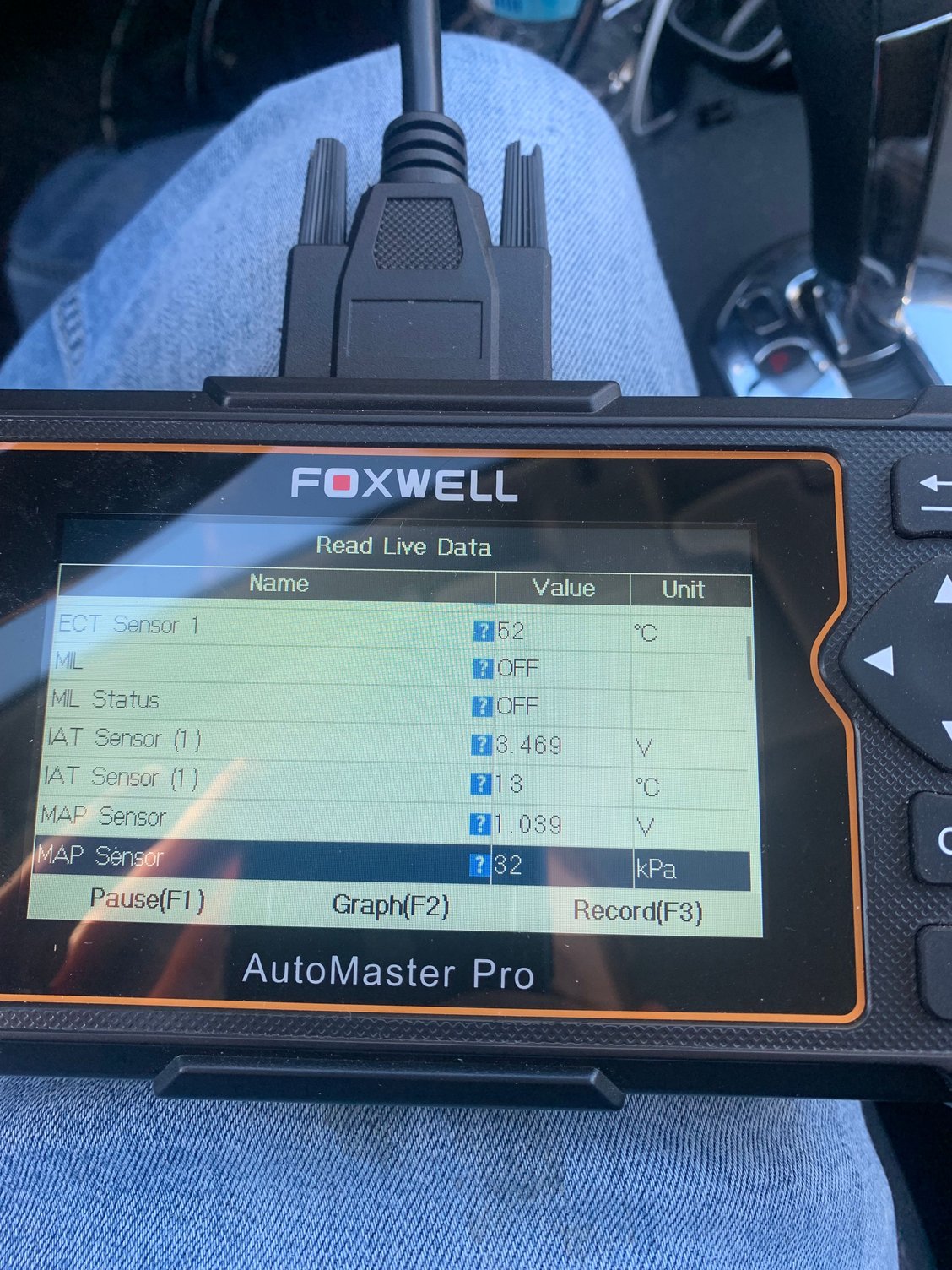

Hi all, hoping somebody can guide me in the right direction. 2002 Acura El (Canadian version, it’s a 2002 civic ex in the US) won’t start after -4 celcius. Cleaned all grounds, checked all electrical connections, replaced ECT sensor, no engine codes. Replaced battery, car cranks fine, turns over nicely. Runs great otherwise. Any suggestions?

Got a scanner that will do live data?

Yes, everything seems as it should.

Iat temp should be pretty close to ambient if the car is cold

The temps are usually within 1 degree for cold start. That photo is taken just after I pulled it out of the garage.
