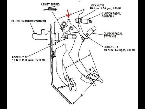

if this is a manual, have you checked the upper clutch safety switch at the pedal?
It’s an automatic so I don’t think that would apply.
