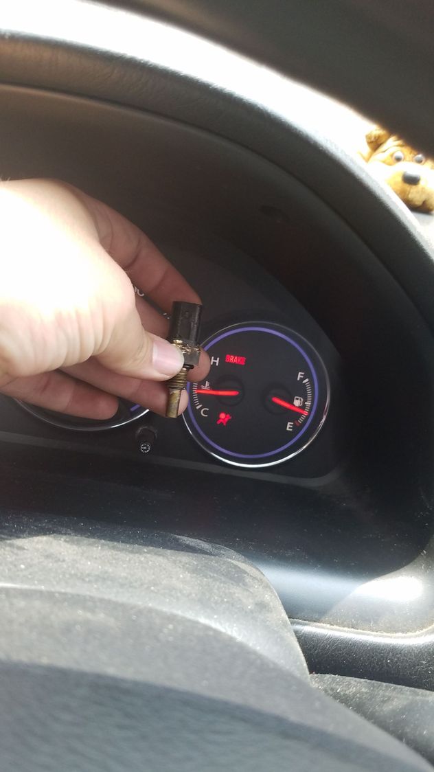

So, I would like to share some updates on this case... And I'm proud to let you'll know that my problem has been SOLVED. So today I'm gonna share what I found as the most reliable solution. Since I cleaned everything on the car, changed some parts, Thermostat had been change with little to no success at all I decided to stop looking for a solution and leave the car as it is... until I realized that the temperature gauges now did not responded at all on any state except when the cooling fan stopped working and engine went to overheat, that way I always had a reading on temperature and gauge never dropped like it was doing when i started to have the issue so i decided to check for a replacement ECT Sensor and when changed... OMG, all problems disappeared almost immediately... And that made me think that the main and only issue that I had was a Faulty ECT sensor that did not read the right amount of temperature making the car get non-durable gas mixture making it hard to start when engine was warm.
Old Apr 4, 2019
Re: Car Crank but won't start and when it does...
That's what I suspected long ago, but I always try to get some reasonable proof instead of just throwing parts at it: Glad you got it solved though!
I know, but i didn't had the tool in hand to let you know... it's been one day since symptoms had disappeared (And honestly I hope it last a long time) but if something happens I'll let you all know!!! Thanks for everything thou!
