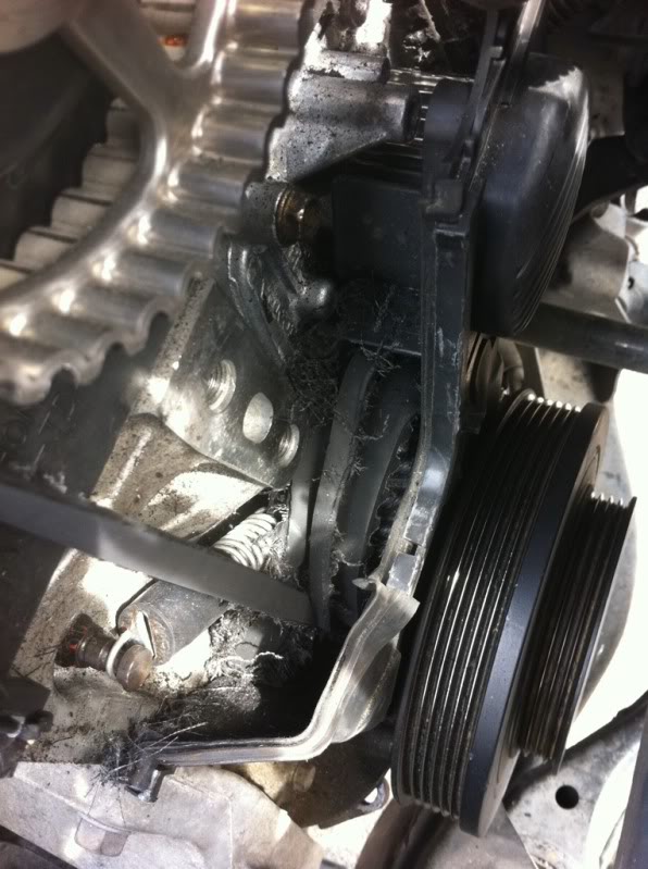

Official verdict on my car: 16 bent valves

It would be nice to know what the actual failure was though that caused this

I'd also like to know the exact cause, this thread has me very nervous about my timing belt.
When I pulled everything apart, a 1/4" wide piece of timing belt was still in tact all the way around, and the rest of it was gathered at the bottom by the crank pulley. The bolt that was holding the TDC sensor was also in the mess of remaining timing belt. Also, the ribs (I guess you'd call em) on the 1/4" wide timing belt were all mutilated. When I replaced the timing belt, I didn't pay attention to the TDC marks until I went to put the engine at TDC, and that's when it appeared as if the cam gear had advanced by a little less than a quarter rotation. So, timing undoubtedly slipped by more than 15 teeth. More like just over 3/4 rotation of the cam gear.. Or however you wanna call it.
Thats most likely the cause of the piston to valve contact across all 4 cylinders.
Here's what I was staring at once I got both the upper cover and motor mount out of the way

Was the cause an installation error on your part Josh?

Yeea I wanna know why the damn belt broke or slipped... is it possible the TDC sensor bolt came out and in some way caused the belt to slip/break? Or possibly the sensor itself ended up where it shouldnt have. That's a mess you have there

I guess installation error is what you can call it. I tightened the crankshaft position sensor down the same and that didnt vibrate loose
The bolt is undoubtedly the culprit for the belt's failure. A little metal piece in contact with a belt attached to a pulley going at least 700rpm? Yea.. When I pulled the bolt from the mess, the threads were destroyed

Wow, that sucks, did you torque the bolt to spec or just by feel?

in retrospect, I think I just did it by feel. But I tightened it to the threshold of when I felt the plastic housing on the TDC sensor felt like it was gonna crack.
The second time around, I put some threadlock on the bolt
I hope I didn't really deter you from doing your own belt. Go for it still. Learn from my mistakes, and just be cautious. Take the few extra seconds to double check ****. I mean, we're all here to help each other out and learn from what everyone else does, right?
