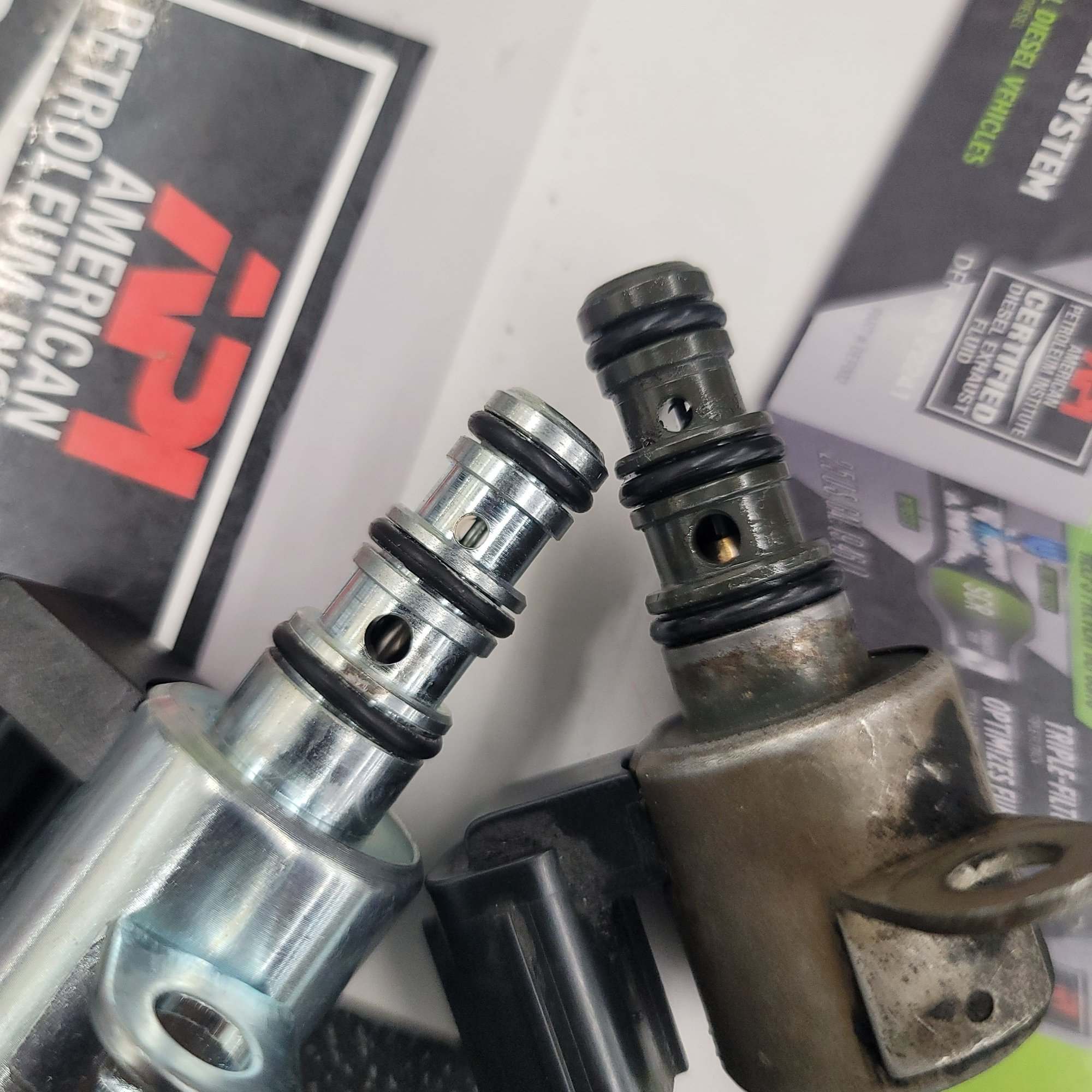

I am having weird issues with my trans an I'm not having any codes... I tested an cleaned my linear solenoid, replaced shift solenoid just because it was relatively affordable and TCC solenoid because it was stuck, checked an cleaned all grounds an wires an connectors.. Especially the notorious G201.. but my trans issue i swear is electrical because i have no slipping, but after i put in gear it drives perfect then it is like it goes into neutral an will just rev.. I can put car in park cut it off an back on crank it no wait time an put it in gear an it goes into gear smooth pulls good then repeat.. I did a drain an refill 2 times so far.. an 1st time was just as clean an red as the 2nd.. no debris magnet was pretty well clean.. even all the screens on all the solenoids were clean.. fluid does not smell burnt..
im ADHD really bad an my hyper focus has me 6days digging an checking an im just curious of what else electrical could cause this... i know tcm/ecu is all tied together.. an i had a random knock sensor code P0325 pop up but i may have caused it cause i was gently bumping throttle to get it to engage into gear b4 cutting car off..
You can see the brass on my old TCC solenoid an the new one was not showing... the old was more of a spark tick with a buzzing where it was locked up an new was a nice solenoid click sound... so any ideas what im dealing with.

That sounds mechanical to me. I'm not sure what your mileage is but it just sounds symptomatic of your clutch pack beginning to fail.

Car has 206k, trans pull good no slip then it does that.. I took video of it.. it's definitely weird, because I can do it over an over an by cutting car off then back on its like it it resets what ever it is electrical.. an I'm getting NO codes so I'm lost on it.

Yeah, I'm guessing your transmission is just toast. The lack of codes is what's telling me it's not electrical. It's almost certainly an internal mechanical failure. I'm not sure how long you've owned the car either but it certainly sounds like someone previously has tried fixing it.
