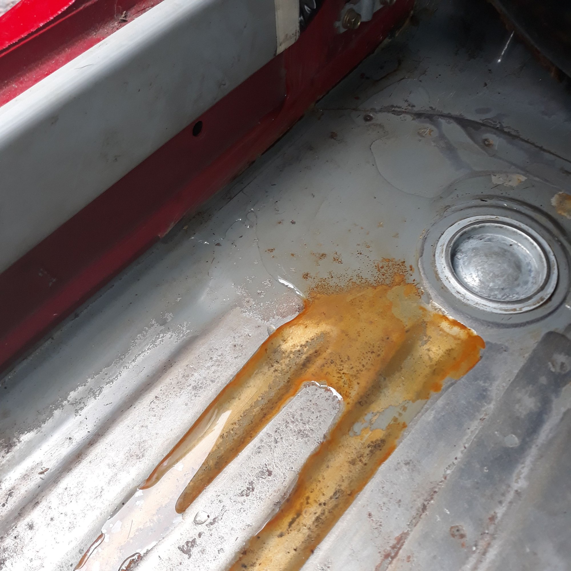

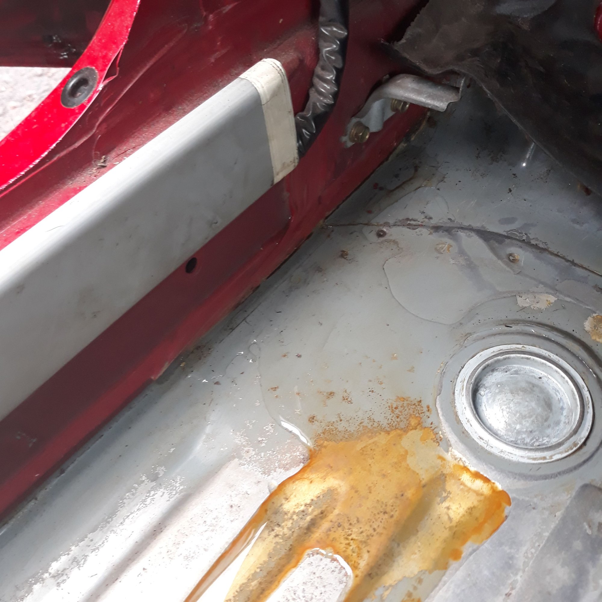

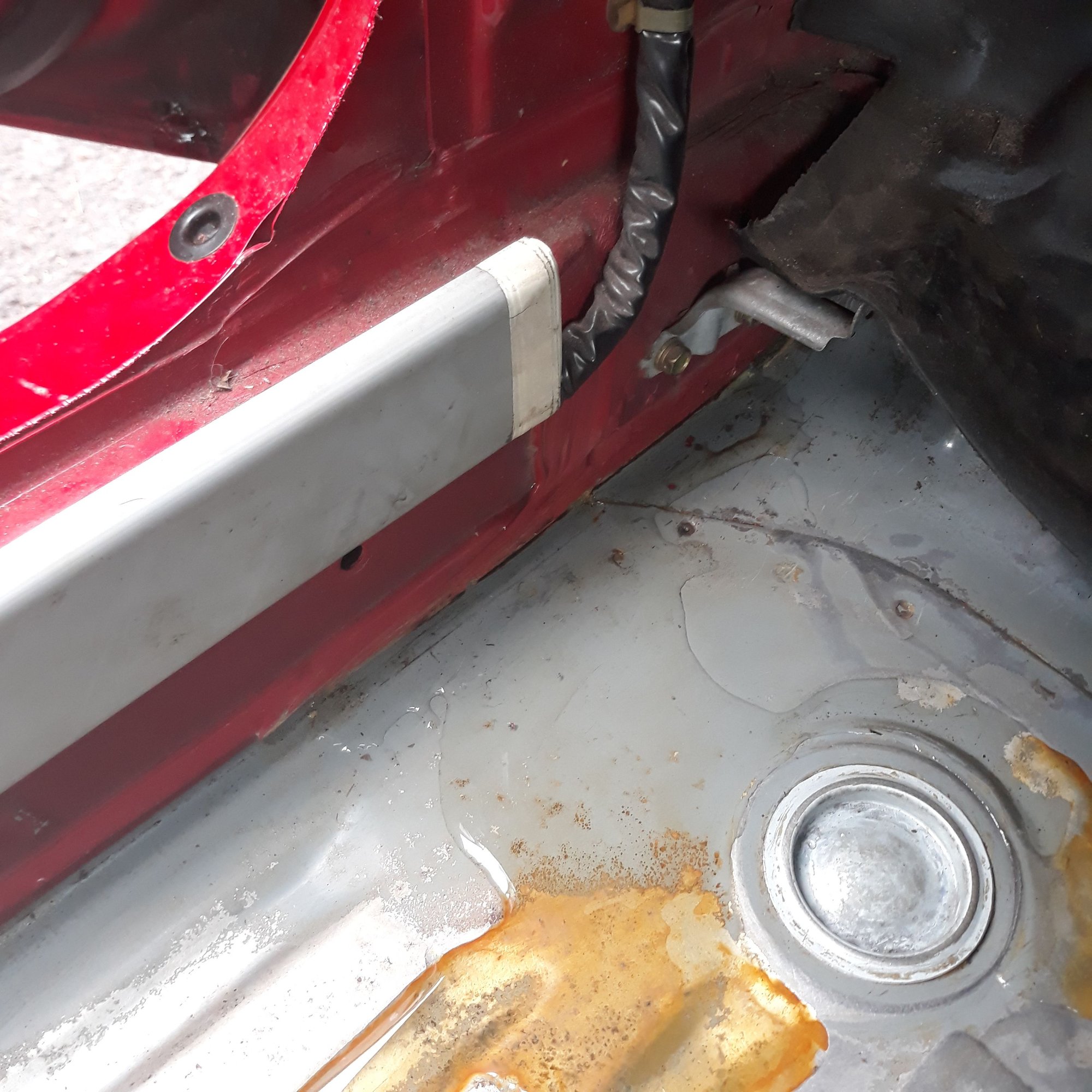

Hi, I just finished cleaning up the front drivers side interior floor panel for painting. Removed some minor rust. Overnight we had some heavy rain and in the morning I noticed water was sitting on the floor panel (see pictures). It seems to be coming from the side bottom door. The night before it was dry. I removed the sound deadening material a couple of days ago. Just wondering if I might have damaged some sealing by the door, in the process ? But most likely something else, as there was long term rust on the drivers side panel but not the passenger side.
There is likely a leak from somewhere else. Rubber sealing around door drivers side door looks okay. Any thoughts ? I was thinking to test with the garden hose, as mentioned in the previous post.

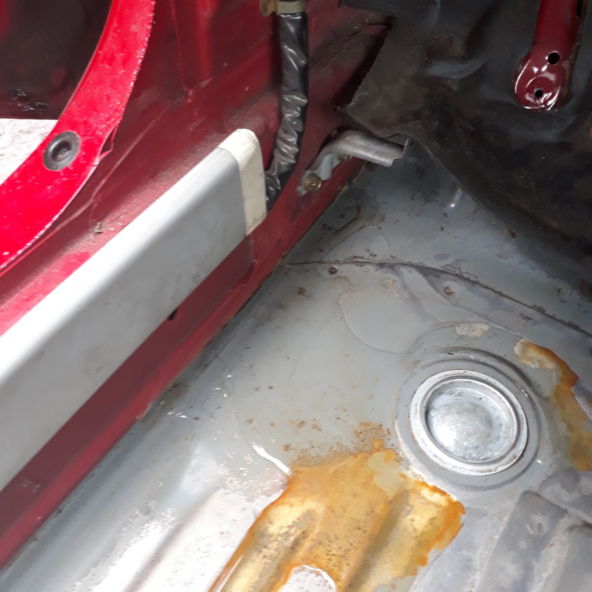

Took the hose to the top of the car and the driver's side door. No sign of leak. I wonder if condensation could have caused that (see pic) ?

Leaking windshield or cowl maybe
