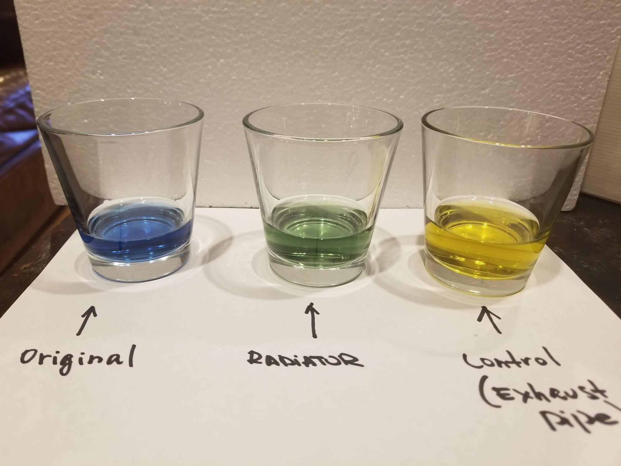

[img alt="Block test rsults
"]https://cimg7.ibsrv.net/gimg/www.civicforums.com-vbulletin/2000x1504/20251102_160837_58d1838029727c4a8fd8ca000b043cb78d c88824.jpg[/img]
I conducted the block test and I don’t know what to make of it - a little leak or the test is not done correctly.
Left glass - liquid out of the bottle, center - after radiator test, right - control, by bubbling exhaust through the liquid straight from the tail pipe.
The attachement rubber plug does not really fit the radiator opening. I pressed with one hand real hard to create a seal and have been pumping that thing for may be 10 minutes straight.
While at it, I made sure to pay attention to bubbles coming up the radiator opening - did not see any. I was revving the car, engine was at opetating temperature.
I must say that years ago, when I had a Subaru and when it finally had HG blown (Subaru trademark), the color of the test liquid was rather similar, but in case of Subaru I had all other classic symptoms - oveflow resevoir overflowing, “boiling” and engine overheating when it has pushed all the fluid out of it.

overflowing coolant reservoir is all the clue you need. Headgasket. All written in the link in my post. Also, have a fail-proof test video in the first post...
chemical tests does snot work on this engine for the gasket.
some say aftermarket worked for them, some reported failures.
no need replace studs, they do not stretch

In my case it is not overflowing, it is empty after about 1-1.5K miles. I keep adding coolant (and oil). TBH, that’s the only “inconvenience” - I have to be mindful of coolant level. But yeah, folks say if tets liquid became greenish - there are exhaust gasses.

so, looks like yours is pushing a lot of exhaust gases. The gaskets in these cars start pushing the gases very little at first, then worsens over time (early cases there is not enough to react and change color). But enough to push the coolant over the overflow.
When car cools down, coolant goes back to engine. Just go to the link and do the tests linked there.
But my cents are that you have a gasket job in your future.
