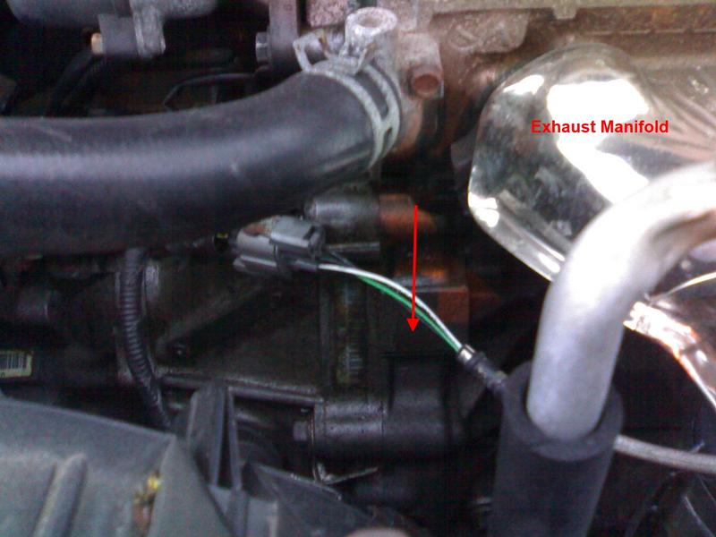

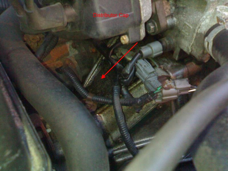

To check whether it is smoking in gear I asked a friend to watch and revved it high in first gear. There was that grayish smoke again. I just thought to check under the hood to see if there are any leaks and noticed some fluid dripping near the places marked in the pictures. The fluid felt more like water trickling rather than oil just under the distributor cap and onto the transmission. The other spot was near the exhaust manifold. This area has always been wet since I started checking under the hood, but the high rev somehow seemed to have exacerbated the situation. I think it could be coolant, checked the radiator cap and it looks full and the color is a translucent green. The reservoir though has gone quite below the MIN level.

The antifreeze will prevent the coolant from evaporating as quickly. Yes I would add coolant, you don't want to overheat. Use Honda coolant!
I would start by looking around the radiator and all of its hoses. Chances are that if you could see the drip spot then you should be able to jack the car up and see where the coolant is coming from. Maybe someone with a 6th gen will know of a spot that is more likely to leak then others.
