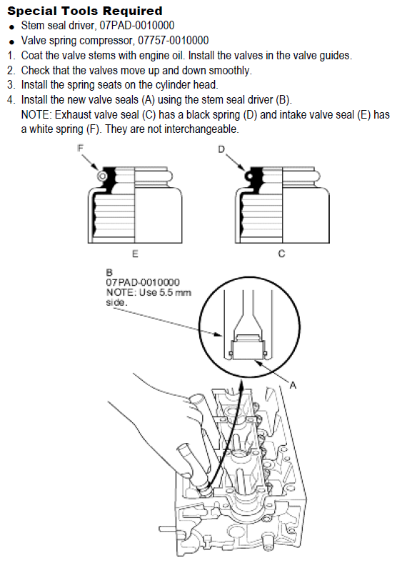

I was browsing this thread and didn’t see anything about actually removing the valve stem seals. Everything I can see online suggests they either pull off with pliers or can be pried up with a screwdriver. I tried both ways and they didn’t seem to budge. The videos make it look like they slide right up without much force but mine don’t. My chilton manual doesn’t even mention the procedure.
Do I just need to use more force or am I missing something? Just worried about wrecking something.

This is all that's in the service manual. They should pull right off with some force. Shows a special tool being used.

To remove them, I used a pair of ViseGrip groove lock pliers and a lot of "gentle" force and wiggling to get it off. I didn't find a way to take them off non-destructively, at least with regards to the valve seals. Just be careful not to damage the valve guide itself
To install them, I used my thumb and they clicked in place just fine. I didn't use any special tools for removal or installation
