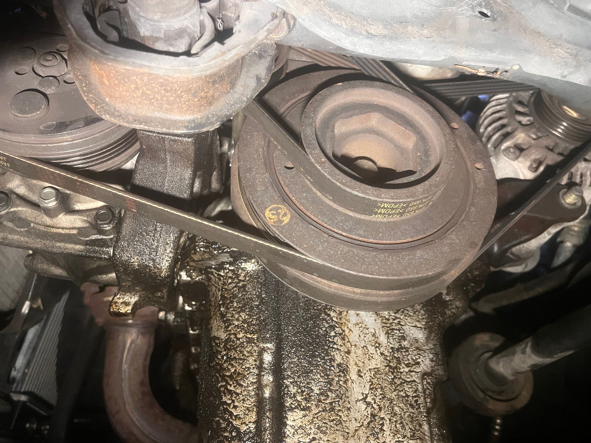

Hey I had my best friend replace my distributor but I think the timing is off because the car cranks but will not start and I don’t know where the marks are and don’t know which marks need to be lined up to what.. I have a 2000 Honda civic ex it is a automatic transmission please help
I have no idea what I’m supposed to be looking for but I do know that it doesn’t look right

The distributor ahould only bolt on to the engine one way.
it's one the other end of the engine up top.
you need a timing light to set it properly but you should be able to get it close. The holes are slotted so you can loosen the bolts and rotate it back and forth.
do you still have the old distributor?
Did it get replaced because the car wasn't starting?

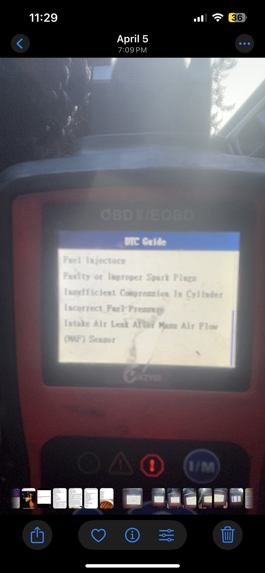

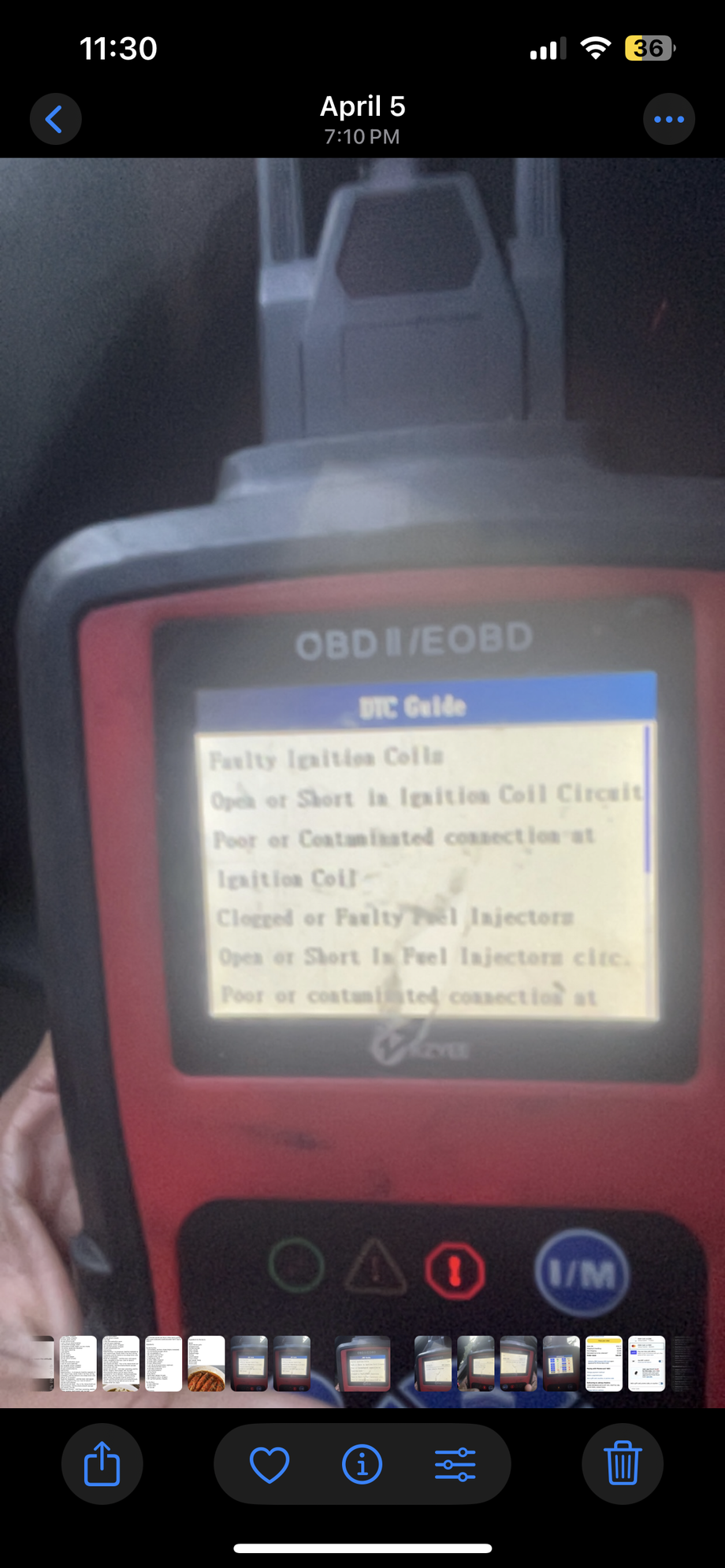

you was correct the timing isn’t the issue it’s tdc but still not start
This came up on obd tool before I replaced all the parts I replaced
ing

Doubt it would lose compression all of a sudden, unless the belt broke.
what was the code that came up on the scanner?

I was thinking the same thing but since the scanner said something about compression I wasn’t sure. It was a P0301, P0113, P1399

P0301 - cylinder 1 misfire
P0113 - intake air temp code
P1399 - random misfire
Make sure the iat is plugged in, shouldn't affect it starting though
The other two are probably from you trying to start it.
Have you checked for spark on the old distributor?
the cylinders might be washed out or flooded from all the starting attempts
