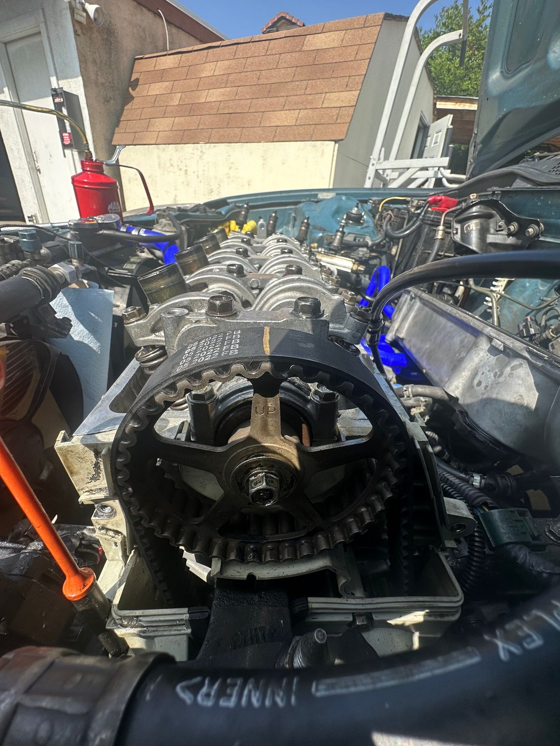

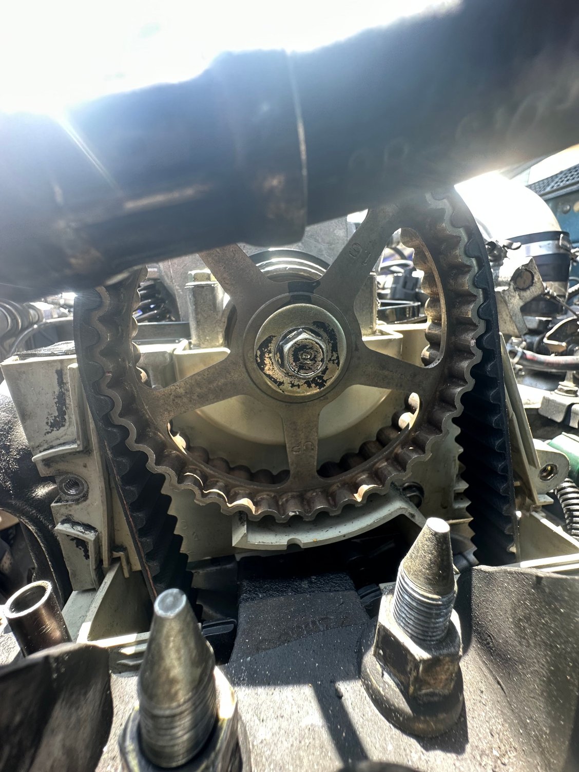

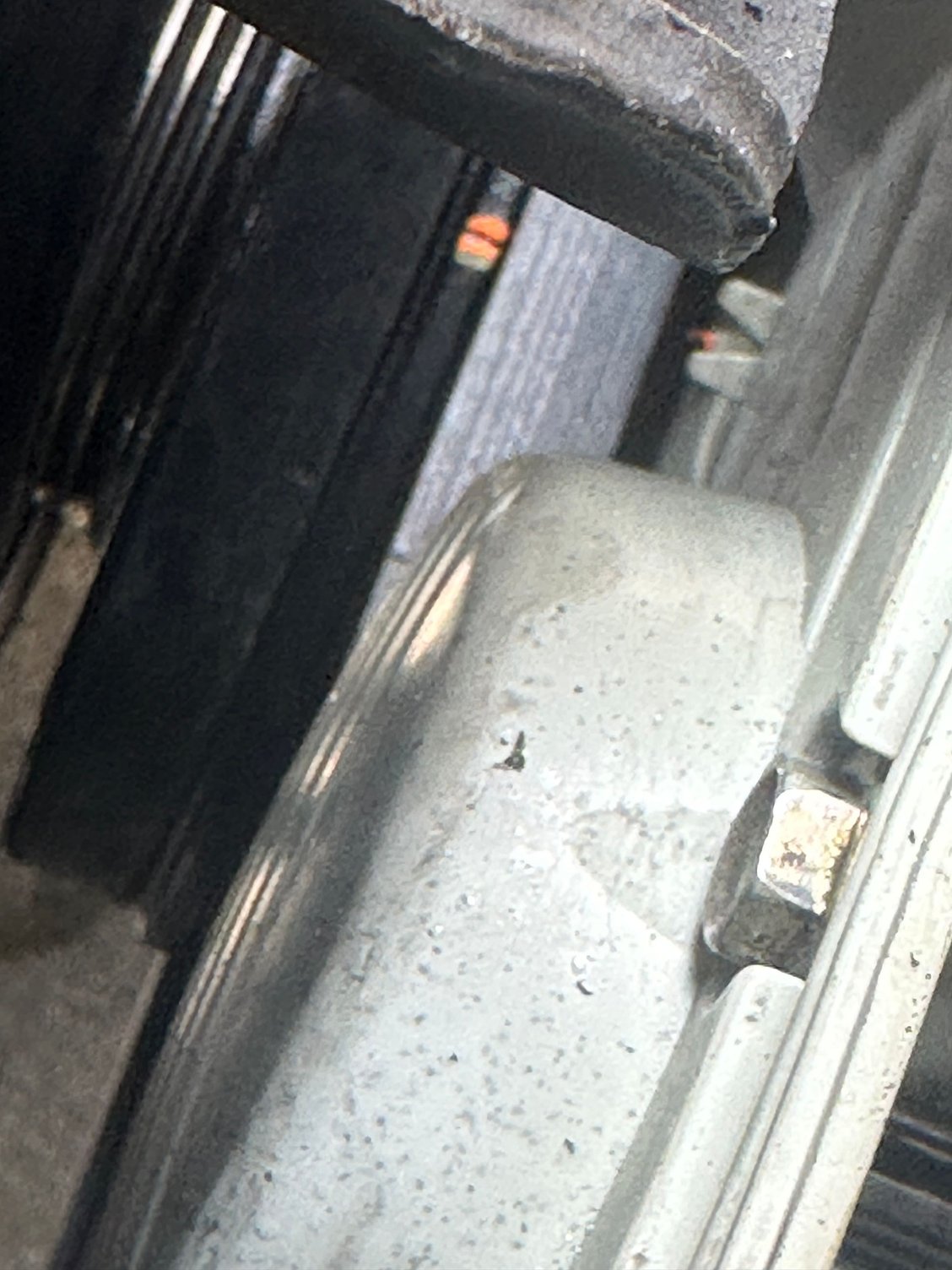

Originally Posted by Maqcro
this may be a dumb question but… I’m at TDC Cylinder 1 currently. How will I know if I’m TDC compression or TDC exhaust. Or does this not make any difference.
Doesnt really matter, the head and cam dictates whats going on

Originally Posted by sdaidoji
with the head off?
you will need to check the dizzy position (I am unfamiliar with the dizzy in D engines, sorry) there might be something in the manual in the link
dizzy is one way only. Can’t mess it up.
thank you. I have TDC cylinder 1 set prior to removing head. Cam is set to “up” at top of gear. Head going on. I’ll assemble rest tomorrow morning.
thanks all. 🙏

Re: 98 civic misfiring [solved]
Guys, 180* off is not possible. With the cam "UP" mark pointing down, cylinder 1 is still at TDC. So, you would rotate the crank one full rotation bringing the camshaft 180* to TDC with it ("UP" mark now pointing up). This is why I mentioned the crank turns twice for every one rotation of the camshaft.
well I feel better now that I’ve checked the valves. 😂
possible timing was off a tooth?
Well can’t argue timing now. Crank and cam are lined up.
You can still see the timing marks on the cam pulley in this picture, one on each side. They should still line up with the top of the head even though the "UP" mark is pointing down. Looks pretty close to me but who knows. No reason to worry about it now if it's driving well.
