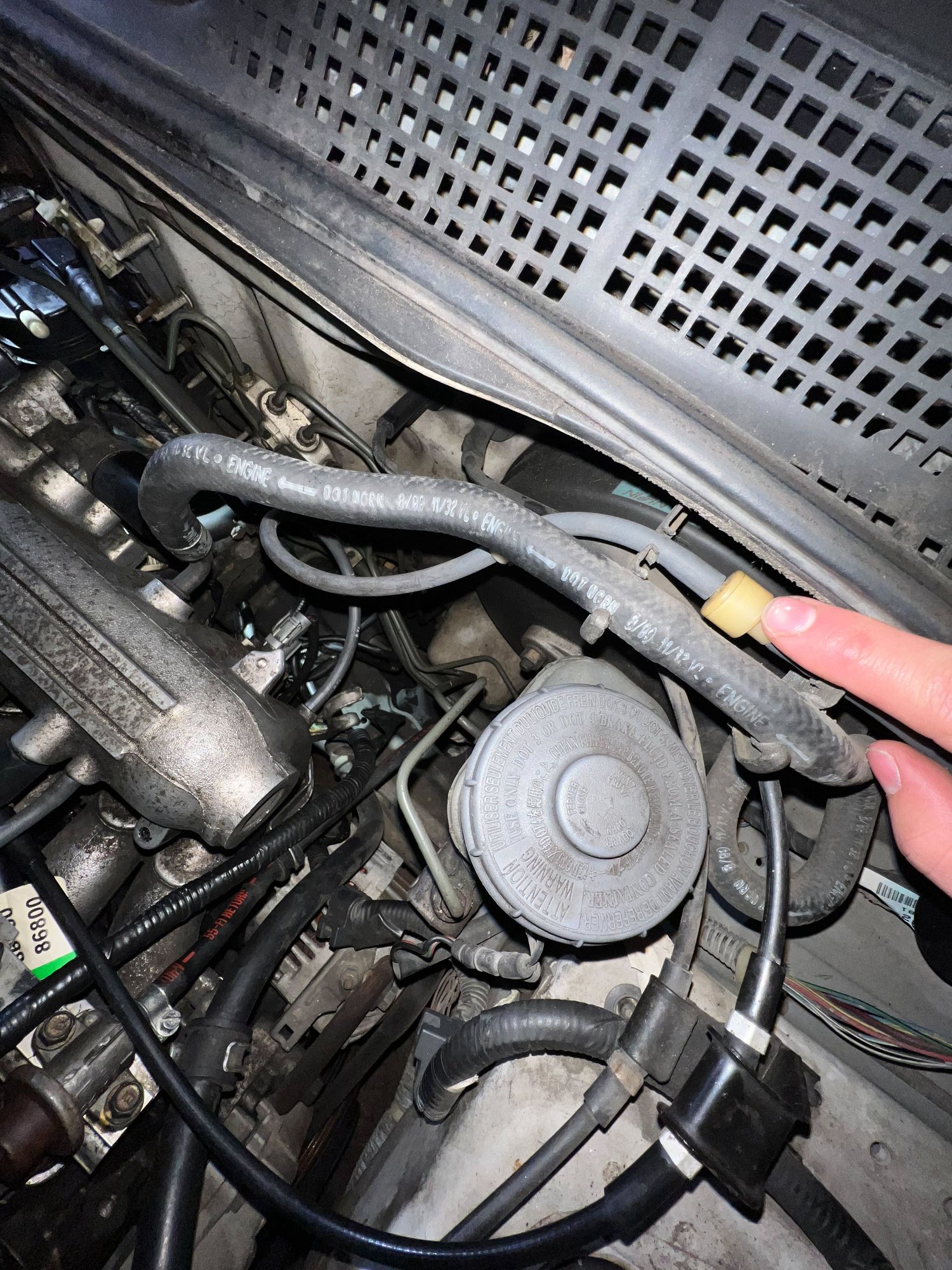

This is the white plug over the purge valve

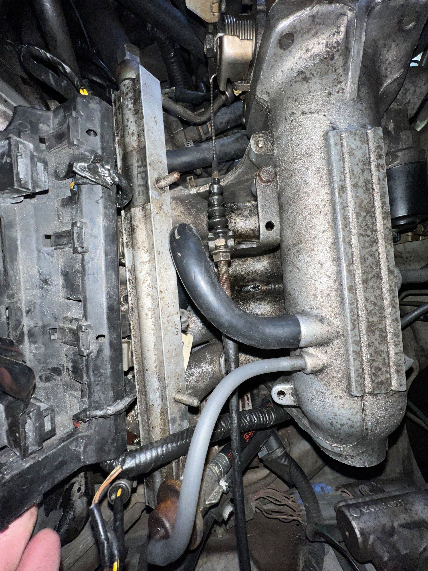

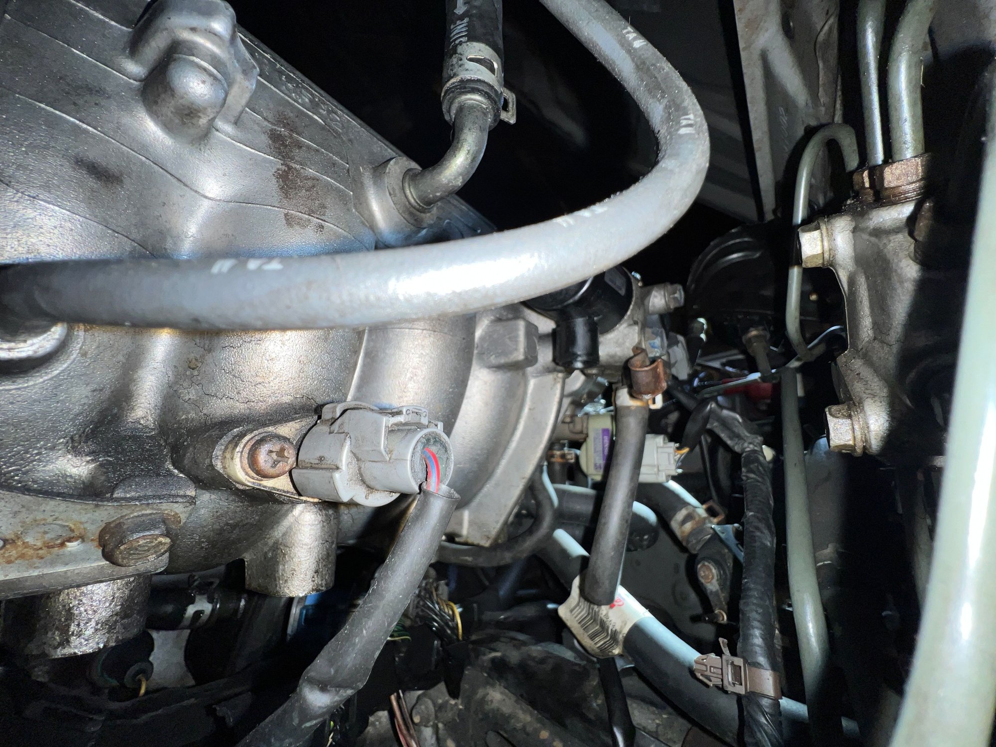

There is no purge solenoid anywhere, not in the plastic of the fuel rail and there is no extra inlet in the intake. The only connecter that would fit a replacement purge solenoid that I've found was on the air filter intake map sensor and another sensor on the vapor canister. All having blue inside the connector.
back of intake
where the back inlet connects to

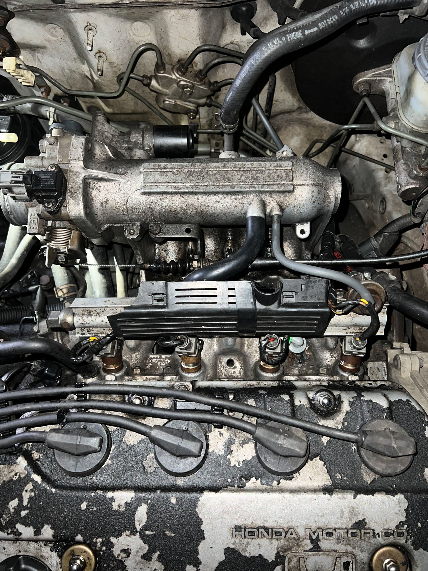

the previous mechanic bypassing the IACV valve... I do not know what to think
top photo of the intake

I have looked at factory parts and the diagrams, but had little luck. The back of the intake has a spot where an old evap solenoid bolts onto and the inlet hose has something else connected to it, which I can T up to that with a solenoid I can install. But i cant find the 2 pin connector on the wiring harness I have for the solenoid, if I can look at the diagram of that would be helpful but I haven't been able to find it yet. Still learning the different civic configs.
