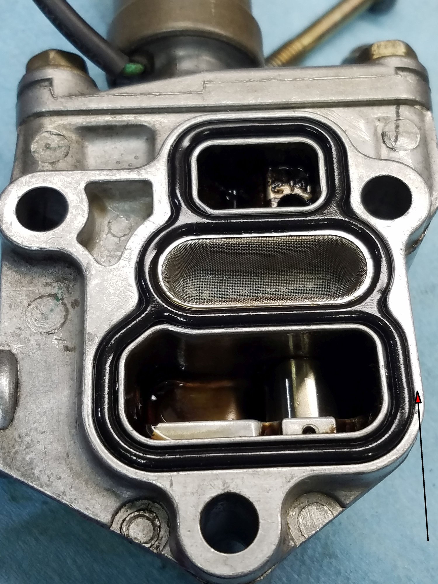

2000 Civic with ~200k miles, D16Y8 engine, the VTEC has been leaking. The leak is clearly visible with an inspection mirror. I took steps to replace the gasket (VTEC to head) with OEM gasket but the leak continued. After trying numerous times to clean and re-torque, leak was persistent. Then one day, for no apparent reason, the leak stopped! I drove it for several days (at various speeds/driving conditions) and it was completely dry. Then again, for no apparent reason, the leak resumed. Sigh.
1) I have no known issues with the VTEC itself.
2) The upper gasket (base gasket) of the solenoid is completely dry and clean. It has not been replaced or altered.
3) I have tried a layer of HondaBond to see if that would help with the leak. No change.
4) I've closely inspected the head surface and mating surface of the VTEC (with loups) and smoothed them with Scotchbrite, I don't detect any imperfections.
5) The bolts were stretched a bit, so I've replaced them.
6) I've torqued the bolts with 3 different torque wrenches (and done a reasonable check of their accuracy).

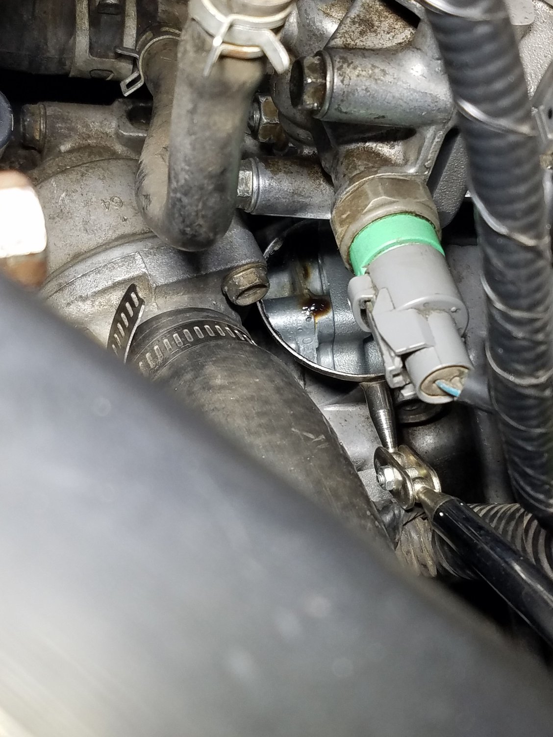

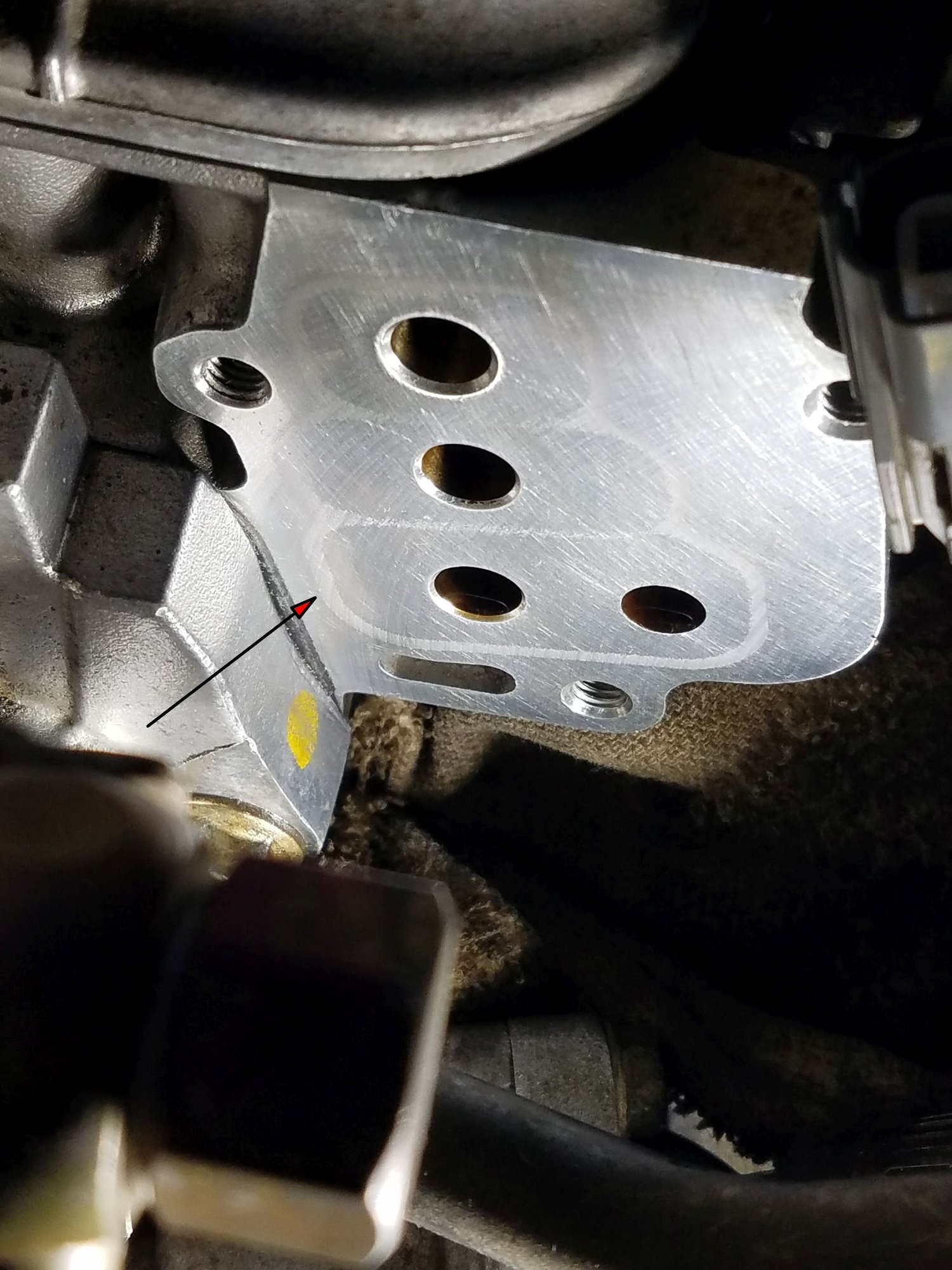

I've marked where the leak seems to show up in the pix below. OEM gasket in the last photo is new.
I've read as many forum discussions as I can find . . . and the "impossible" seems to be happening on a regular basis - anybody with any good ideas?
This is where the leak appears to originate.
This is where the leak appears to originate. Photo shown is with new gasket.

what about the engine block side?

The engine is really clean. Can't see any oil on the intake manifold (side or lower flange), engine block, or clutch housing. Of course, if I run the engine for awhile, the drip will eventually drop and migrate forward to the front of the engine, as so many on theses forums have posted.

  • Your photo shows what looks like some slight screen filter clogging, though minor.

  • the image isn't quite clear about this - the filter is brand new and there isn't a speck in it.

The Vtec solenoids body tends to warp, but you won't see warpage via visual inspection. A professional straight edge and feeler gauges would likely prove warpage. Anyway, I've had this happen on several 6th gens and careful use of Hondabond
Amazon Amazon
on the rubber seal (avoid getting on screen) will likely solve the issue. It did for all the ones I applied it to. Use an inch/pound torque wrench to service manual spec on bolts.

Looks like a used one is your best option. You might want to call machine shops in your area and get a quote on milling the Vtec solenoid mating area flat, could be a cheaper option?. Hopefully the mating area on the cylinder head is not the issue. You mentioned that the upper (spool) gasket doesn't look to be leaking, yes?

Tape a sheet of sand paper or emery cloth to a flat surface and "machine" it flat yourself

A glass top over wood table would work well. Or this maybe

But having the solenoid surface machined might be good to inquire about. I replaced the head gasket this summer (and removed the VTEC), had the head surfaced and the mating surface for the solenoid looked good, but we didn't do anything to the intake side. With the head being so large and the VTEC being so small, the machinist and mechanic and I all agreed that the head was far less likely to be out of spec.
