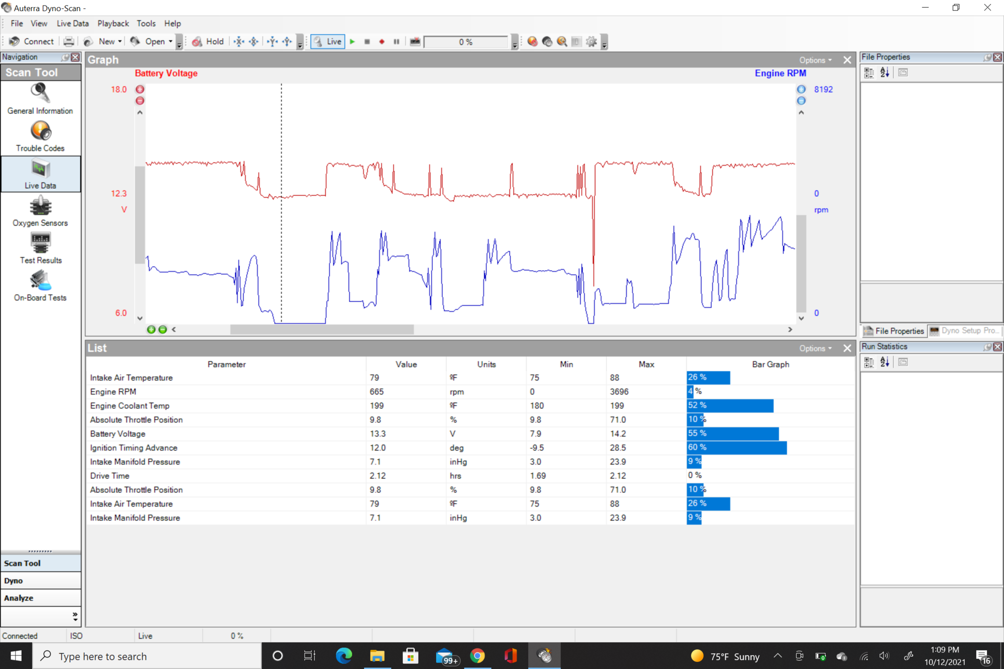

my 97 civic with a d16y7 runs perfectly then randomly stalls, mostly while idling at a light but a few times as me or my wife were driving. no pattern with stalling some times it wont stall at all other times its relatively frequent

-alternator was replaced with duralast remanufactured (see picture for its health but im some what questioning if it was a dud, lifetime warranty so i could replace with another for free)

notice when it stalls at least once the battery drops to ~7v which is weird and when putting a full load on the electronics (lights brights ac radio brakes etc, when parked) i was able to see the voltage dropped way down when measured right at the battery
but when it was driving fine it was charging fine considering the ELD hondas run and that the voltage shown was from the obd2 port it was still 12.3v+ so that should be enough to keep it running (its above 12.5V when measured directly at the battery not the port)

ive also thought about battery/charging but both the battery and alt are new, i guess its possible the new alt was bad but i do get 14+v charging but im not sure why it dropped to 7v the second time it died on the screenshot
