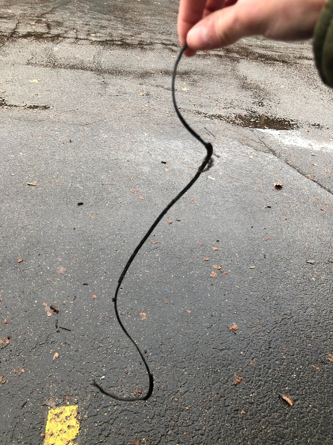

My uncle came to check it out and the timing belt has most definitely slipped. So Sunday we’re going to fix that and while we’re under the hood fix the TPS too.
I knew she was going to be a project but I didn’t expect major problems before I even put insurance on her haha.
Also, this bad boy is from my power steering belt. So well fix that as well.
