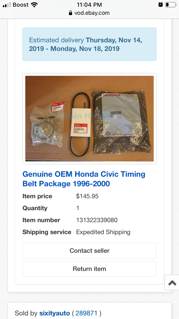

I kept
looking until I found a good enough deal on the genuine Honda stuff.
