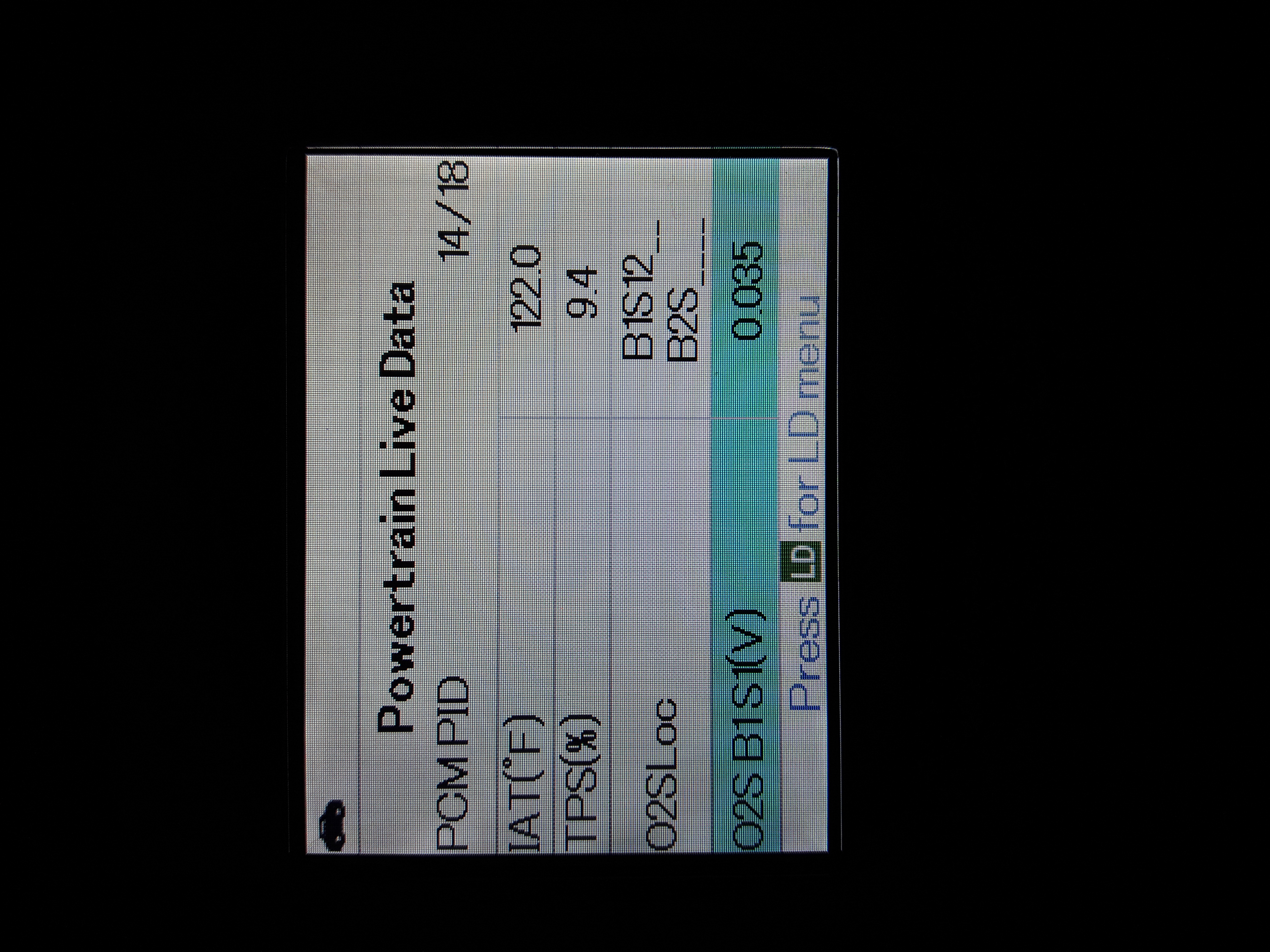

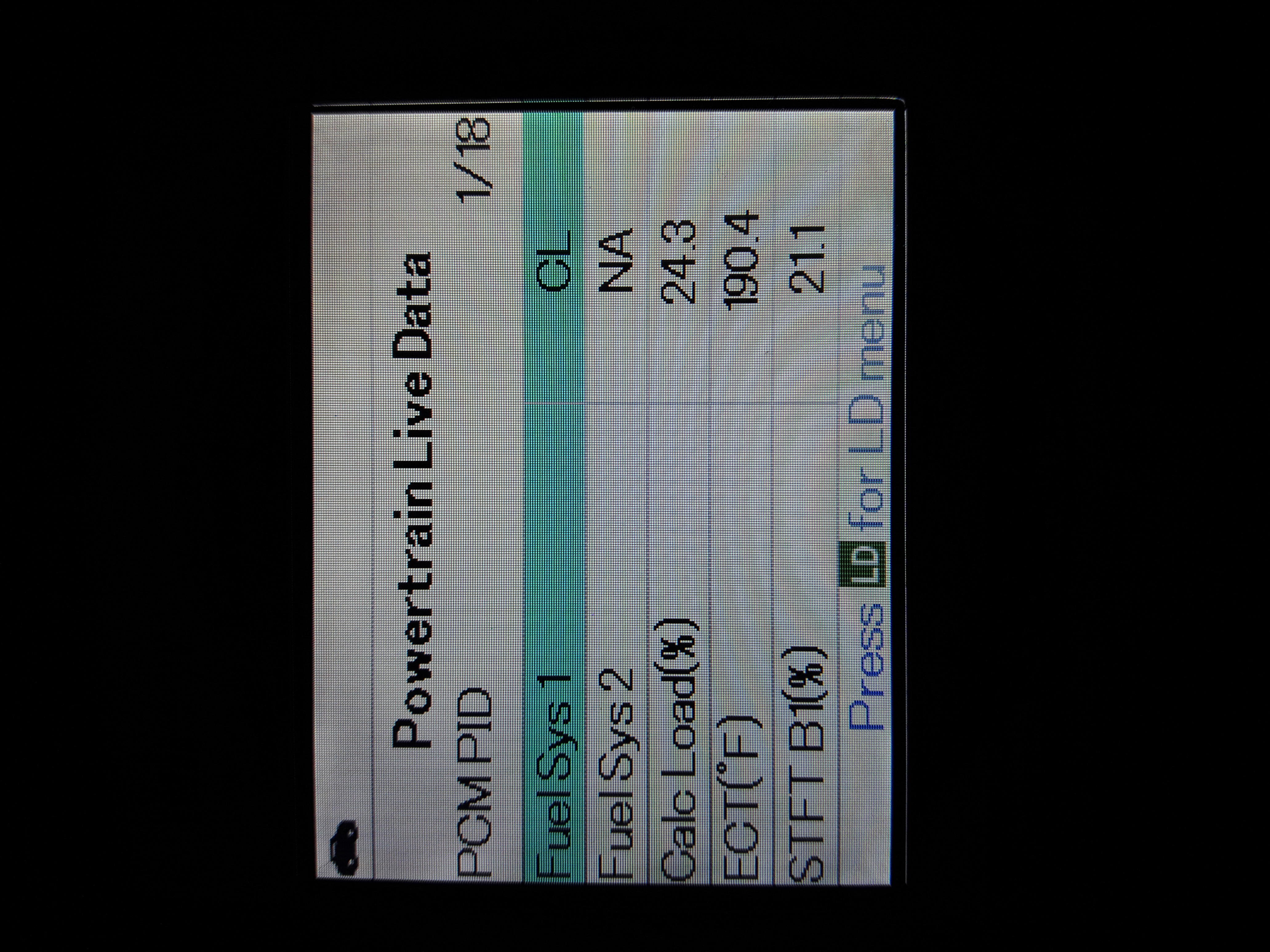

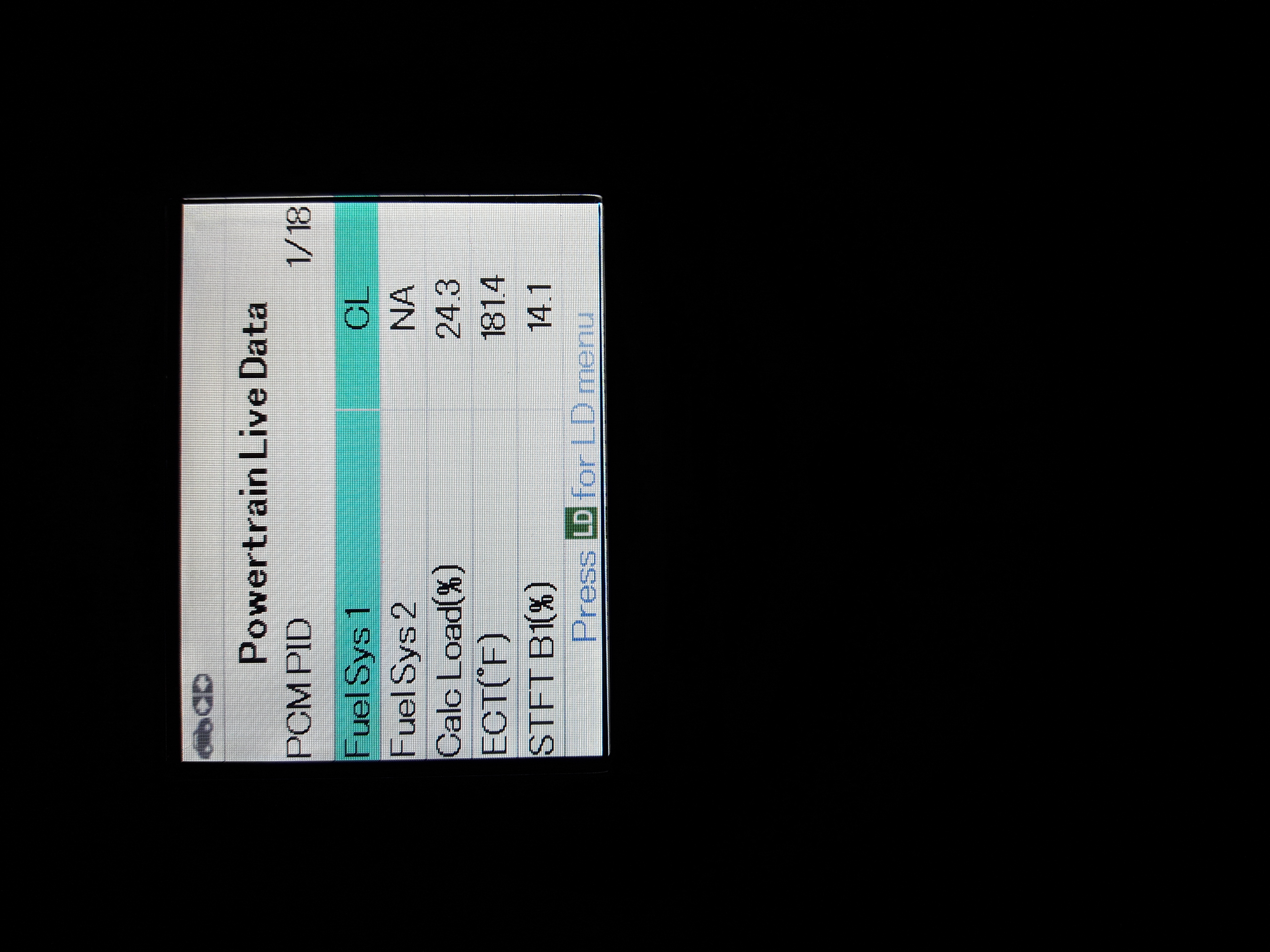

After todays "diagnosis" after research and buying a 120$ OBDII reader I popped P0505 and P0509 along with my missing 02 due to the header..
Its all IACV related BUT I have noticed from day one my intake manifold gasket was garbage...too the point I sealed the gaps with exhaust paste. Again horrible idea but at the time was desperate..so unless I come up with a new final solution later today I have a fresh intake gasket, coolant, and hosing. Going to install the intake manifold gasket after cleaning off all dirt and exhaust glue...find the correct routing for vacuum lines. then do the proper idle relearn. proper coolant purge according to the Haynes manual...also battery will be fully disconnected and 15 fuse pulled.. if that doesn't do it...I'm not sure...ill take it to a shop. Need it for another month or so then it'll get a new motor/trans
my main question is how do I go about "resetting" the TB screw/accelerator cable back to a starting point? This way I know where I'm adjusting from etc.. ANY HELP/INFO appreciated....to whoever read this especially at this time.. thank you. Will post an update later today...need some sleep
P0505 is simply a wrong RPM that the ECM isn't able to control correctly for any of several possible reasons.
P1509 is a circuit code, you need to figure that one out before doing anything about messing with trying to adjust idle rpm.
Aftermarket parts are a crapshoot (so are used parts). There may be several different versions of the IAC depending on which engine type you have and which transmission type you have. A wrong part may bolt in place but not be right electrically.

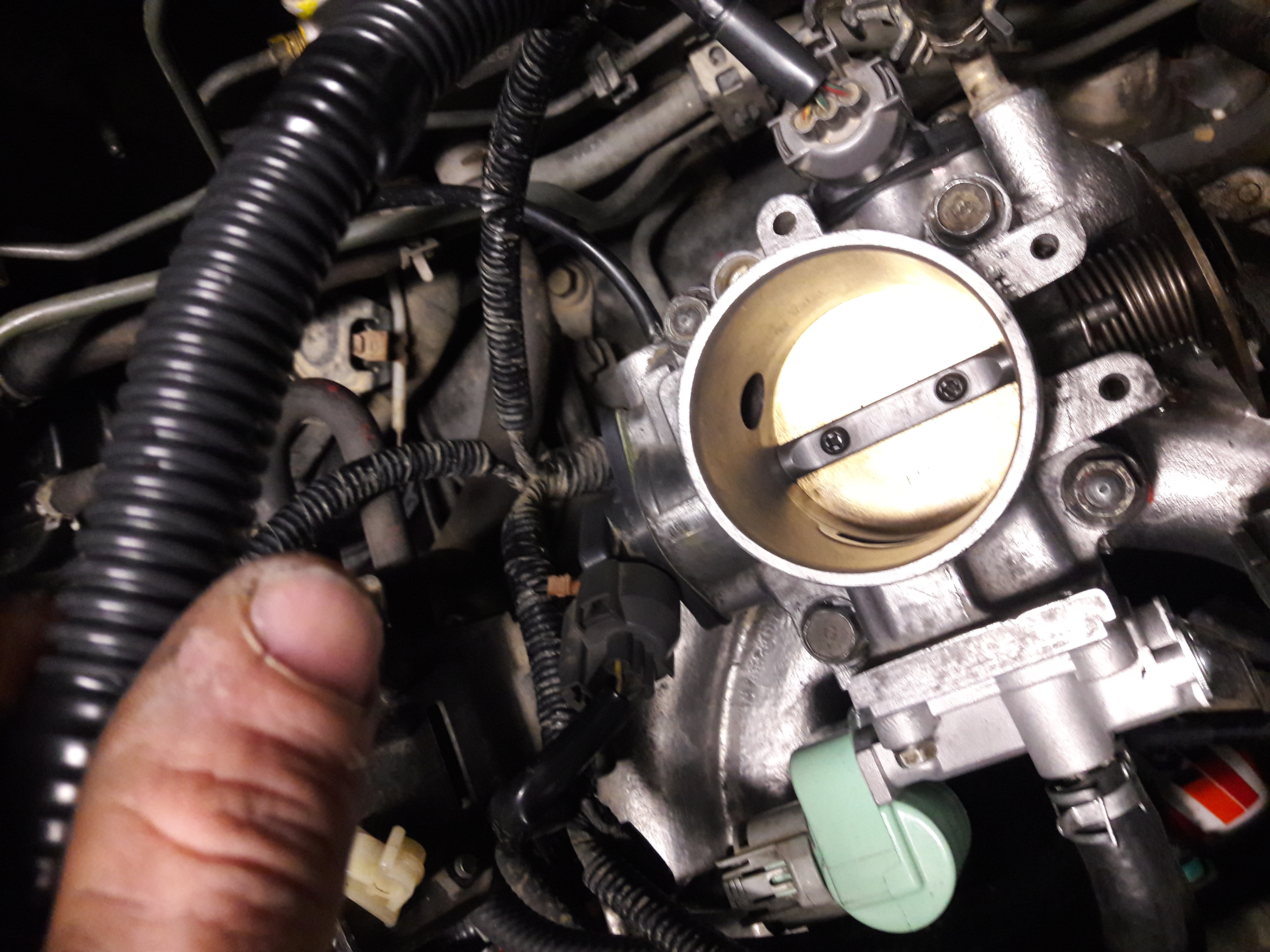

Clean the throttle bore and plate of carbon buildup.
Clean the passages for the large screw. If they are clogged up, adjustment may not be able to do anything.
Reassemble, install, run engine and get all warmed up to operating temp.
Use your fingers to block the air passage in the side of the throttle body that lead to the IAC valve.....
Now adjust the big screw to obtain the spec idle RPM.

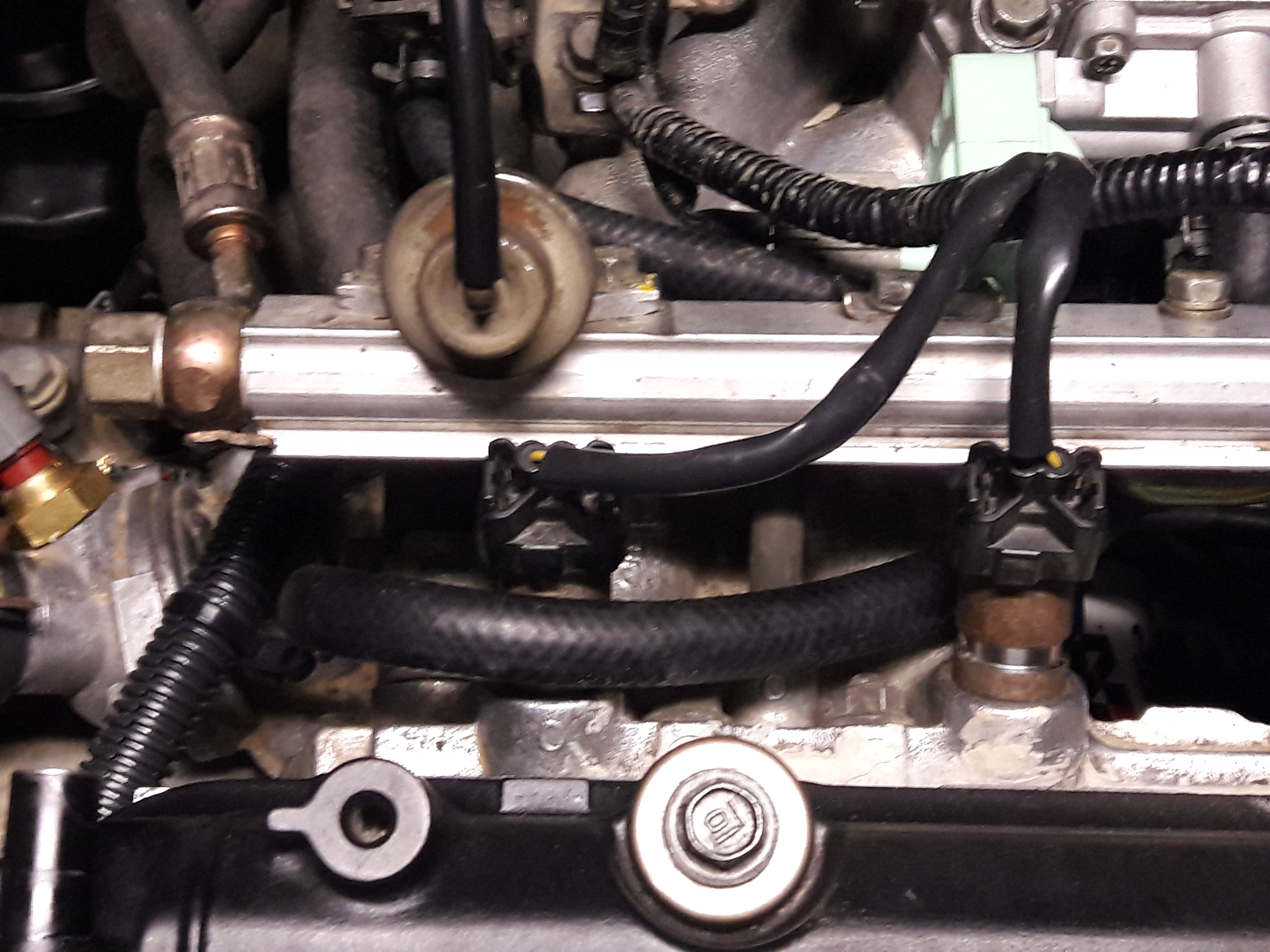

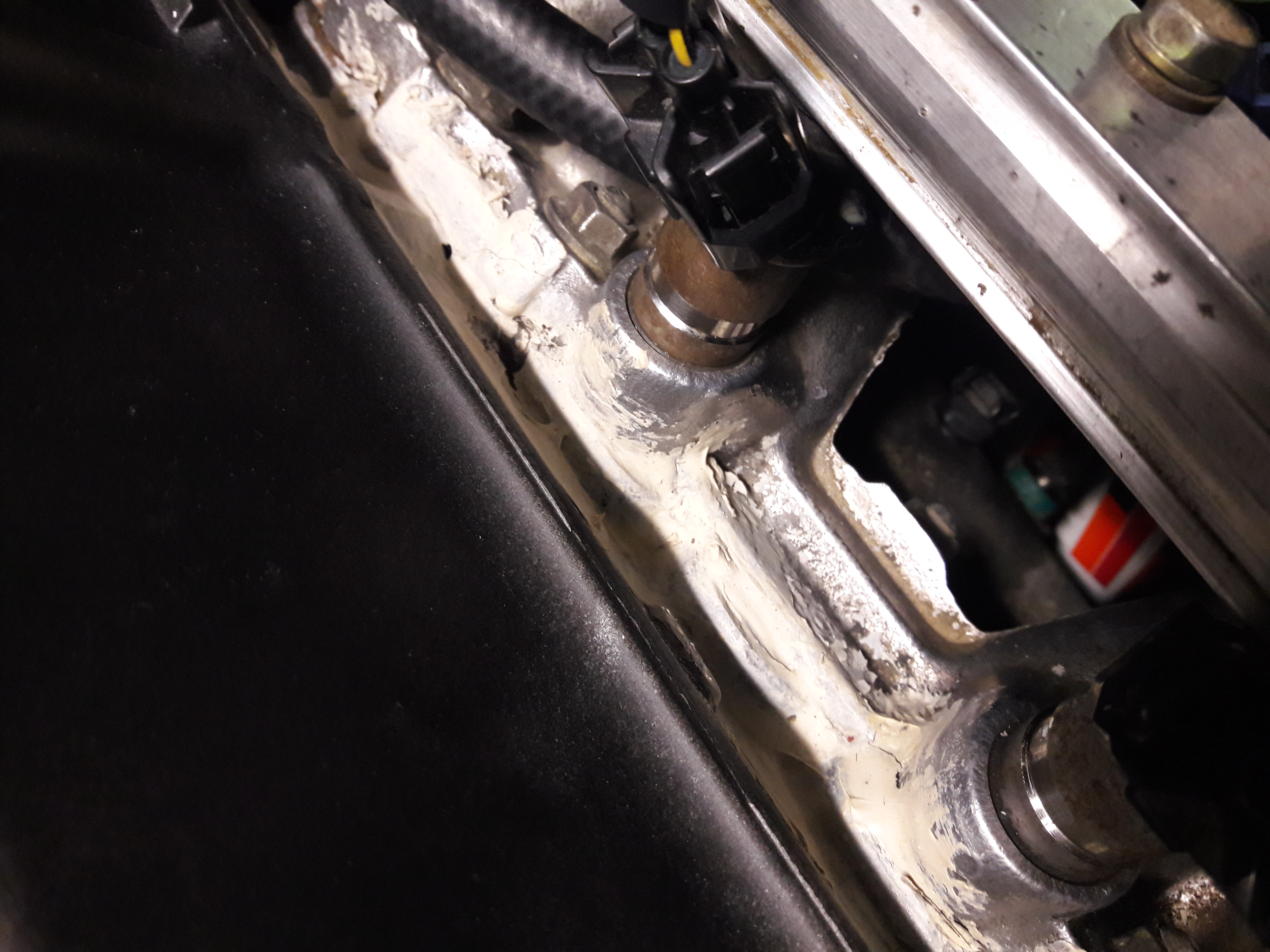

first area of concern for me is when I pull fuel rail with injectors. They are nasty...being on somewhat a time limit I do a quick wipe and keep on
https://drive.google.com/file/d/0B_t...ew?usp=sharing

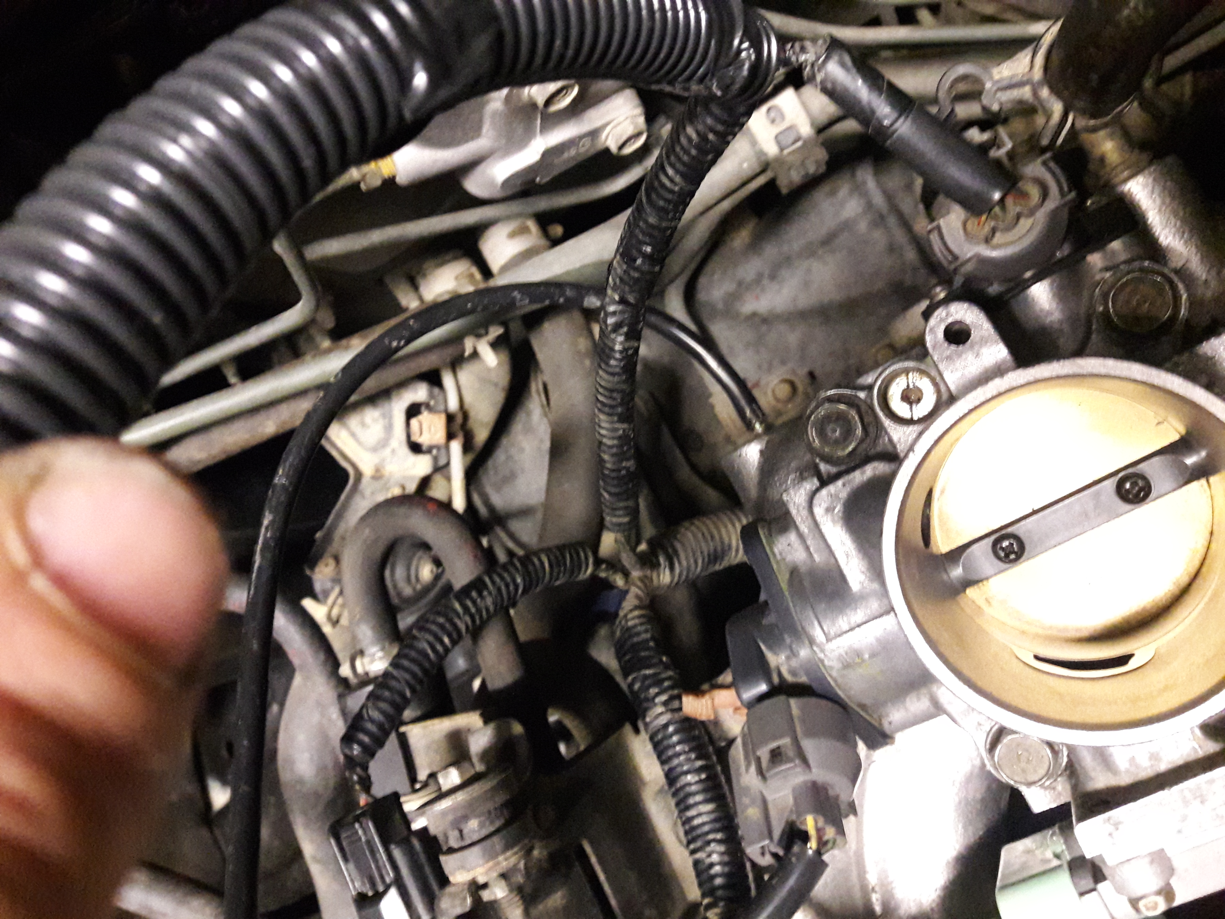

I start to see the pcv valve, check it - its not rattling...add that to cart on autozone app...some of the lines are routed wrong = different hose types, clamps etc...so I figure undo it all clean it up and begin fresh..since I'm in the area of one of the grounding points at the thermostat housing why not change it out as well...when I go to pull the bypass off it tears into two pieces
https://drive.google.com/file/d/0B_t...ew?usp=sharing\

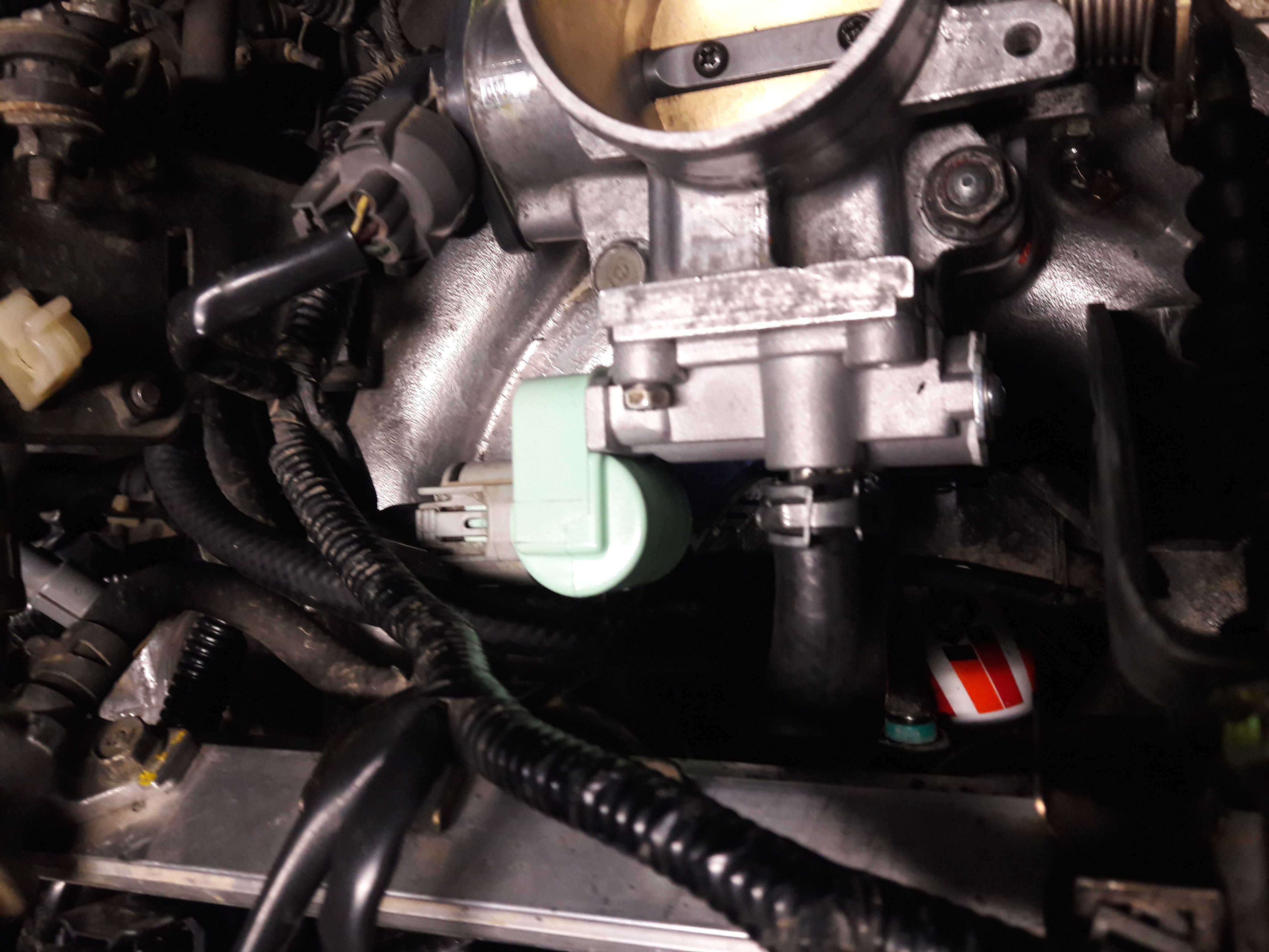

so I add a new bypass hose to the order and determine majority of these lines are going to get replaced...
at this point I take a break for other obligations and to pickup my order of a new TB gasket, thermostat/gasket and plenty of hosing...oh and a scraper for the old gasket which took at least an hour to fully clean/prep... now its getting later and I decided to get the manifold back up/torqued for the night and pick up again tomorrow..commected pcv with new line and original Honda clamps. as well at the middle S looking line....I end the day with this view
with the intake gasket on and manifold torqued along with the TB being cleaned and remounted on fresh gasket I quit for the day....I do have a genuine Honda accelerator cable because mine is frayed pretty good,,,FedEx says noon tomorrow...hopefully can finish routing lines correctly fill/bleed coolant & a PROPER idle relearn...
anyways, saw at least two reasons for the idle issue...horrible lines/connections...and dirty fuel injectors/ports??

Injector crud is normal. Wipe off if it bothers you, and reinstall.

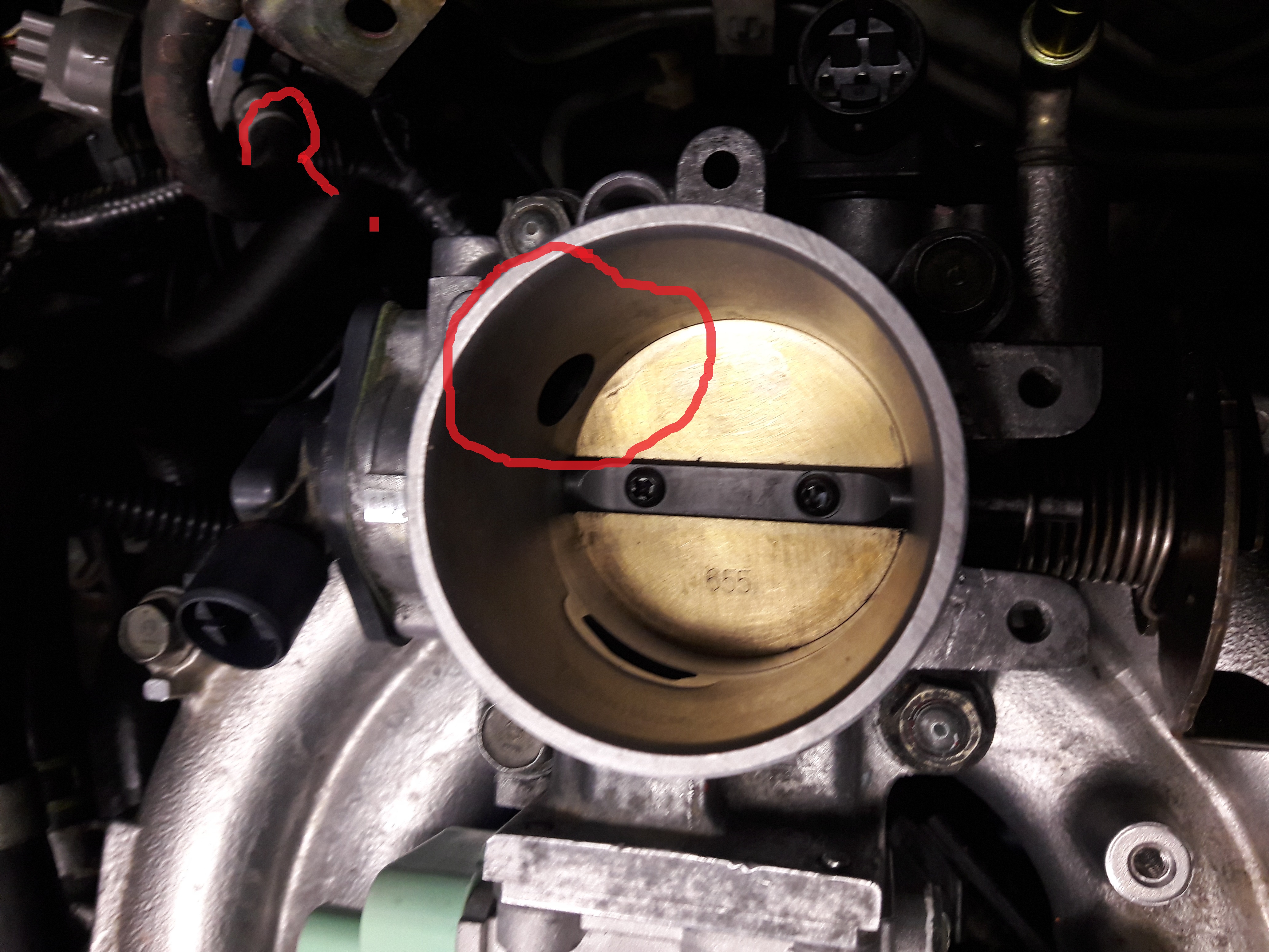

To whomever is still following this thread...today I got the manifold back on. my new throttle cable showed in the mail finally so it went in...reconnected everything with new hosing etc and original honda clamps...started up first try purrr'd beautifully while i started bleeding the coolant...sat back and thought "nice - done.." then slowly and i mean veeerrrry slowly i notice the rpm is raising and slowly lowering...$@%($$@
agggh!! so i find a steady rpm to hurry this air purge and the surging stops momentarily and then comes back. My idle screw was removed and cleaned prior to reinstallation so i have no idea on where it needs to be i tightened all the way down before start up...then for some reason I covered the port next to the TPS and the surging stopped, the idle lowered...and evened out... perfect...so now my thought is TPS is bad....between a LOT of air in my system and tps I believe its solved...i bought a tps just in case for the AM and tonight ill research some more about it...so close..

It's not a TPS problem.
The open port you circled leads to the bigass screw that you keep asking about.
Cover the OTHER port (leads to IAC valve) and see where idle RPM goes.
No change?
Keep this IAC valve port covered with your fingers and run that bigass screw down until you reach the idle RPM specification.
Bigass screw will probably need run in all the way to til it hits the stop then back out somewhere around .5-2.0 turns to reach idle spec

Will try 1st thing once I get up...kind of hard/pain to bleed coolant while trying to correct surging issue...assuming you're right then that's 50$ back for me... 😀
Also..during the slow surging I unplugged the IACV connector remembering that if idle levels out IACV is bad or is it the other way? When I unplugged it it surged even faster Also..this IACV was literally replaced 3 weeks ago..

EZONE you are a genius....im sitting here 20min in at an idle rpm of 930-37....not one miss...never heard it sound so smooth and quiet....not calling it fixed yet though I will call it finished when I drive the 50$ tps back to AutoZone hahaha

Your idle RPM spec should be more like 700 (actual spec may vary a little depending on engine and trans and location). Reset and recheck.
The spec may be on an emissions sticker on the hood or in the engine compartment
Then after the hot idle RPM is set, make the ECM to do the idle relearn.

codes yes same Ho2s (s1) heater failure
h02s b2 s1 heater circuit malf
a/f sensor b2 s1 malf
TPS i want to say had reading of 9%
and open loop fuel sys - sensors i guess?
Old Feb 23, 2017
Rep Power: 517
Re: idle/surge/bogging (lots of info/pics)
O2 sensor failures can keep the system in open loop......that could be making it run funny. Might be a good place to start, but sure can't tell if that's the entire problem though.
What are the fault code numbers? (in the "Pxxxx" format)
Did you ever try to adjust your TPS?
I was trying to figure out if the (video) tach quivering while driving might be associated with the idle surging...damn hard to tell from just a video.
Can you backprobe the TPS signal wire to see a true voltage? (volt reading on a DVOM instead of % reading on your scanner) Looking for target of 0.49v at closed throttle.
