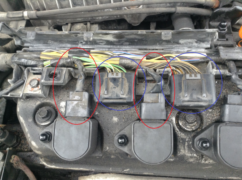

Is there a way to check the Ignition Coils to see if they are bad or just not operating correctly? I know on older models with a distributor you could check the ignition coils with a multimeter, but the coils are different on my 2001 Honda Civic.

I have a wierd issue going on. On my 2004 Honda Civic SI (CDN) it throws p0134 CEL sometimes. I say sometimes because it will occasionaly shut off and I won't have a CEL anymore. The car does have 125000km on it and I dont think the sensors have every been changed. It also idles poorly. I'm wondering why my CEL will randomly shutoff from time to time?

so after idk how efn long ive found my popping and slight misfiring culprate. another thing to add to the vacuum leak list, is the reservoir. It is apparently a common problem as well. Most people that have it dont even realize it unless they are under 2k rpms or at idle will cause a slight pop in the exhaust.

I have a 2001 Civic LX, and I'm getting error codes P0300-P0304 (all cylinders are misfiring). The only symptoms as far as I can tell is that it is idling roughly and it sometimes doesn't start as easily as it used to. Spark plugs are new. There isn't oil on them. Someone suggested changing the wires. I know I have coils, unlike the older Civics, but is it possible the wires connected to the coils need to be changed, either the ones circled in red or the ones circled in blue (see picture)?
Any help is appreciated. Thanks.

What is seafoaming? And what are the circled wires/plugs called? It is possible that they are the problem, even if I can't replace them?

Those plugs are ground junctions. Highly unlikely they are the problem. http://ls1tech.com/forums/general-ma...-your-car.html
Do this and get back to us after your results. Make sure your air filter is clean first. And all of your coils look good
