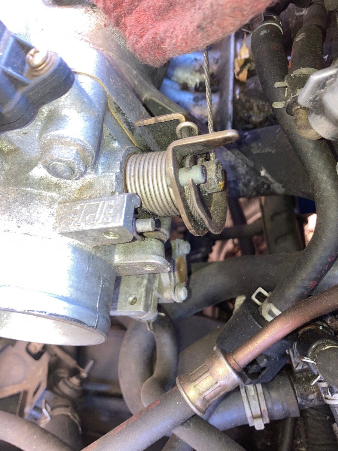

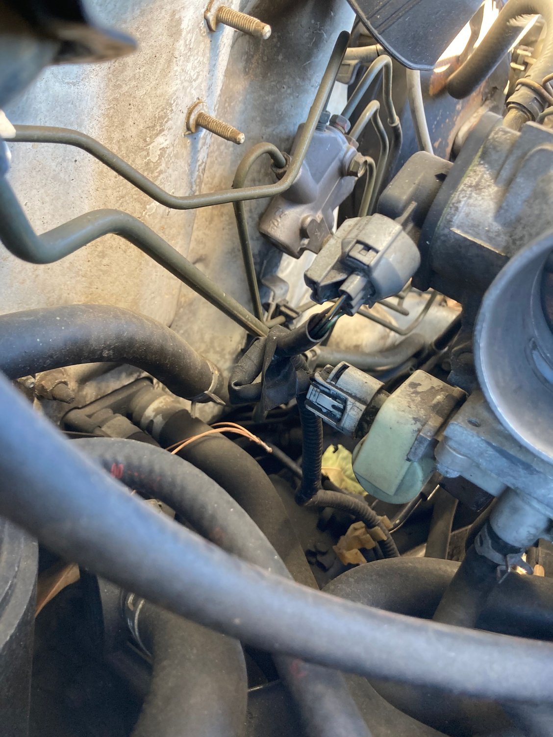

[ QUICK ANSWER: Maybe just blow throttle body cleaner through the intake/throttle body? ]
Could be a dirty IACV, throttle body (as mentioned earlier), or a loose vacuum hose when I reset all the hoses.
Don’t want to tear up the gaskets on the IACV or throttle body, they look good and I don’t need more work.
See pics attached.
Originally Posted by GolNat
Could be a dirty IACV or throttle body. Carbon gets built up and causes idle issues.
^^ Air filter assembly removed from throttle body.
2000 Honda Civic EX Coupe
D16Y8
Rough idle

^^ Near PS firewall.
D16Y8
Rough idle
