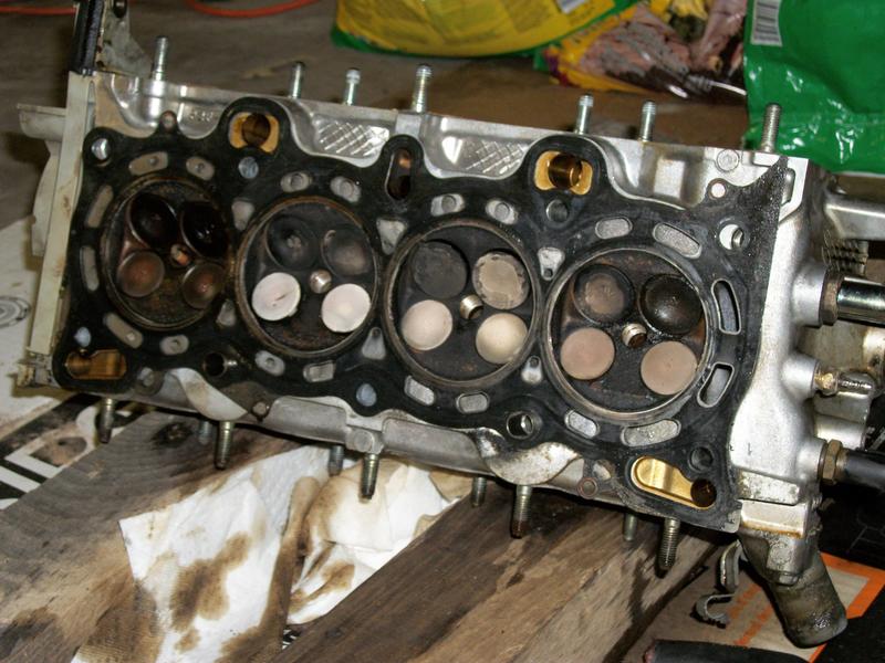

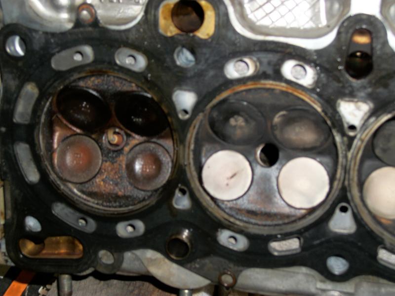

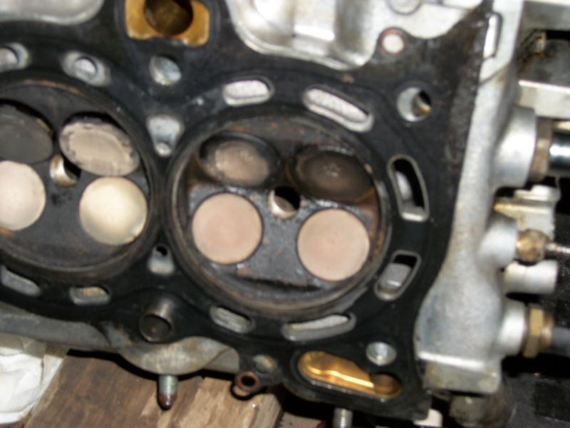

Hey guys I'm working on a civic right now and I just pulled the head today. I was expecting to see a chunck missing from head gasket between 3 and 4. The gasket was fine, so I was wondering if it could possibly be a warped head? It failed a CLT by making connection from cyl 4 and 3. Also his valves look funny lol, they got like white orangish looking chalky type stuff on 3 of the cyl's exhaust valves, I guess these would be burnt valves? (pictures attached). cyl 1's valves looks completely normal. I was just wondering if any ones seen this before and knows what the problem and probable cause may be. If ya read this far then thank you for your time and your input would be greatly appreciated.
Customer complaint: Overheating, replaced temp sensor, check engine light, drove aprox 5 times after car started over heating, car has 250k miles on it, never replaced head gasket
In addition: Radiator is leaking (which would be one reason for overheating), 4 codes; 3 cyl skip codes and 1 general skip code,
Thanks

Radiator leaking caused the initial overheat. Which caused the head gasket failure. You often can't see it on the head gasket itself that it has failed. Get the head machined by a professional shop, they will check for warpage and such, get them to make sure the valves are okay. Might cost him 200 bucks but it's well worth it. It should fix his overheating issue.

If the car overheated, you might need to check it for warpage, send it out to a machine shop, many times a head gasket repair fails because many shops overlook that step.

Already told you its probably the head gasket. What else could possibly cause it? Just because you can't visually see it has failed does not mean it hasn't.
