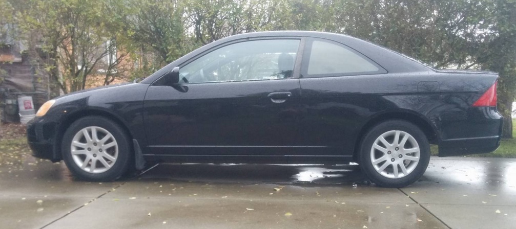

Hi there, I have a 2002 Civic Si with the heated mirrors option.
The problem is the passenger side heated mirror heats up fine, but the drivers side doesn't at all. The mirror adjuster works fine on both mirrors too.
Would I have to buy a new heated mirror? or is it fixable
