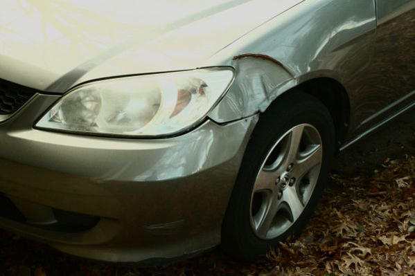

Hi Everyone- New here. I've attached the photo of lovely 95 civic with some damage. About how much would this cost to fix, would you guess? And is the damage only cosmetic?

You could pop it off and push the dents out yourself for a little bit of nothing. Although with the tear it would make it worth just getting a new fender (unless your a fan of bondo) Fenders can run under 100 bucks easy, go to a pull and pay and only pay 25 30, or any other junkyard and pay a bit more.
Go to a few bodyshops and find out. No guesses.

Thats not a 95 civic..
That fender needs to be replaced..

About a grand at a body shop. They'll replace the fender and primer, seal paint, clear and blend the paint. They might have to paint the door and A pillar as well to color match.
About $200 if you just slap on an unpainted new fender you self.
