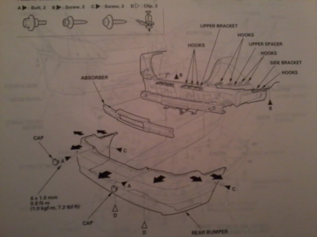

I know this is the wrong forum probably, but now that I got my car going, (see trans ordeal...) I am the second owner of it, the po slightly hit something with the drivers side of the back bumper. Not bad at all, but the bumper cover is pushed forward a tad and wont sit down behind the rear quarter. How do you get the bumper cover off so I can try to straighten the bumper a bit...

Re: Bumper cover
