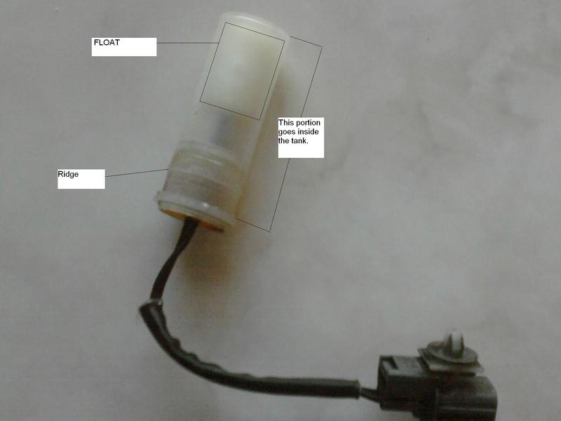

Good day all,
I know that not all 7th gen civic's have this specially in the US but i thought this would somewhat help. the Canadian version has a sensor inside the tank that tells the driver when the fluid level is low. A common problem with these sensors is they go bad and the reason why is because the float inside the sensor (see attached image) gets stuck on the bottom, this is caused by dirt and gunk accumulation inside the cylinder where the float. The float is designed to rise as the tank is filled and lower as it gets empty, when it reaches a point where the fluid is very low, the light come on the dash. So if it's stuck in the bottom then the light will always be on.
Allot of people say just disconnect the cable to the sensor. That will work but personally i hate leaving things disconnected. So here is what i did.
- accessed the reservoir through the driver side tire by removing the liner.
- emptied the tank by removing the tube from the pump.
- once the tank was empty i disconnected the sensor and pulled it out of the reservoir. you simply have to pull on it and it will come out.
I could have gone to Honda and bought a new one but decided not to.
$60 dollars is a little pricy for something i can fix.
So instead I cleaned mine. i sprayed it with brake cleaner and rinsed it out with water.
You can also use CLR or mineral spirits.
On the top side of the sensor there is 4 holes. so you can spray in them.
If you really want to you can even open the cylinder and remove the float completely to clean it (that's what i did)
in the image that i have attached you can see that there is a little ridge, you can pry it gently (there is 2 small plastic grooves, be careful don't force.
I decide to take mine apart to clean it. Once it was clean and dry I put it together and used some silicone sealant around the ridge.
put it back in the tank connected the cable and that's it. Works like a charm
By the way, do not use RainX windshield washer fluid the one that is yellow the de-icer one.
That stuff will kill the **** out of the float. it has some sort of substance that sticks and that's what caused mine to stop working.
Hope this helps.

I'm guessing the black object on the side isn't the sensor right? It's labeled Denso and I'm pretty sure that's the motor. So, is the sensor on the bottom?

This fix only works given that the magnetic switch from what I can tell is working properly. Mine totally crapped out. I went ahead and cleaned the sensor as well as the float and mine wasn't stuck at all and not even dirty. It's the element inside the sensor itself. You can not open it since it's completely sealed due to electrical components. It was worth a try. I'm hunting down the part. So far it's around $50 the cheapest I find. It sucks we don't really have junkyard here . Great Info by the way.
