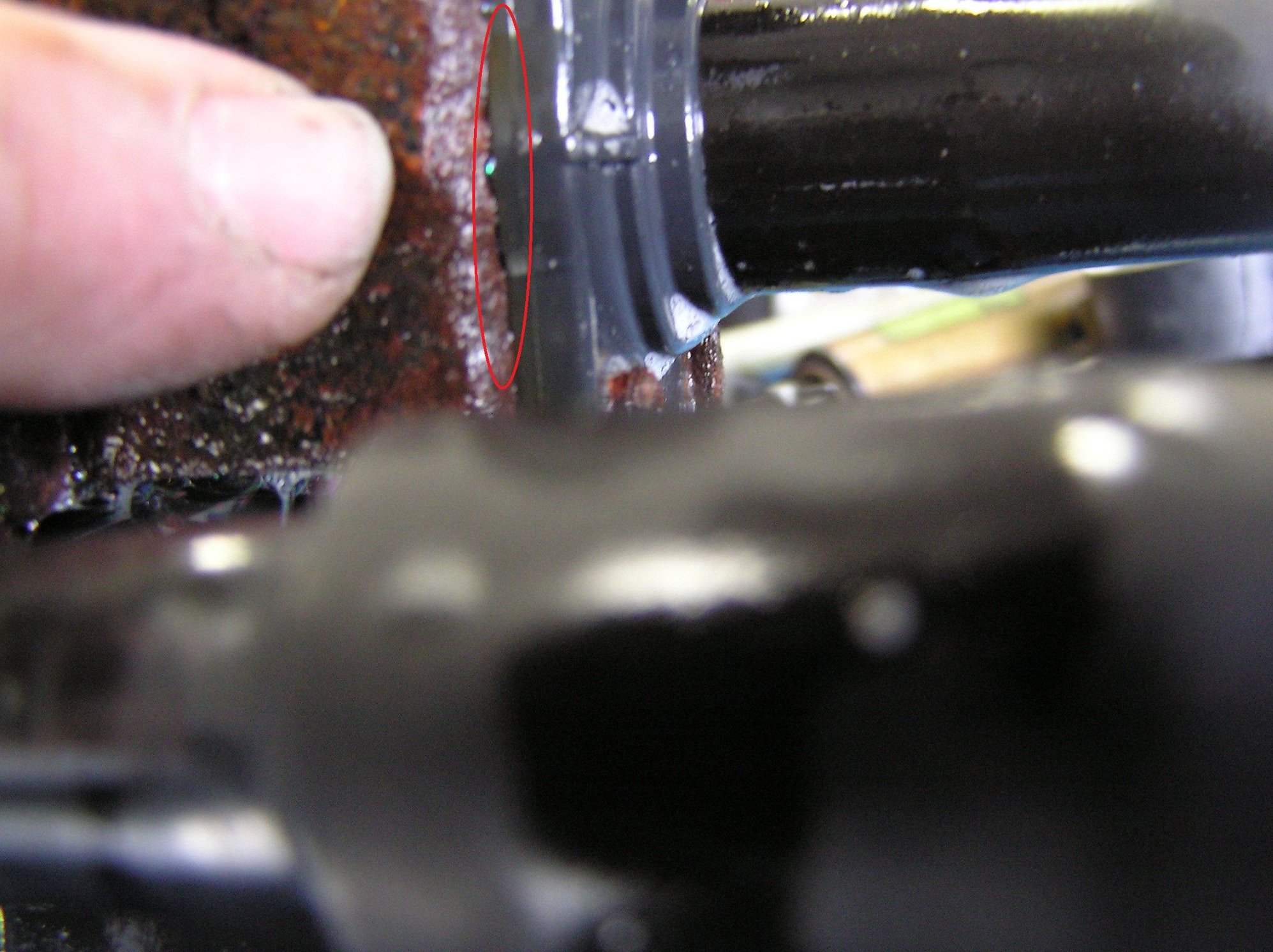

Thanks to Ezone pictures pointing the location of the leak of the CVS valve!

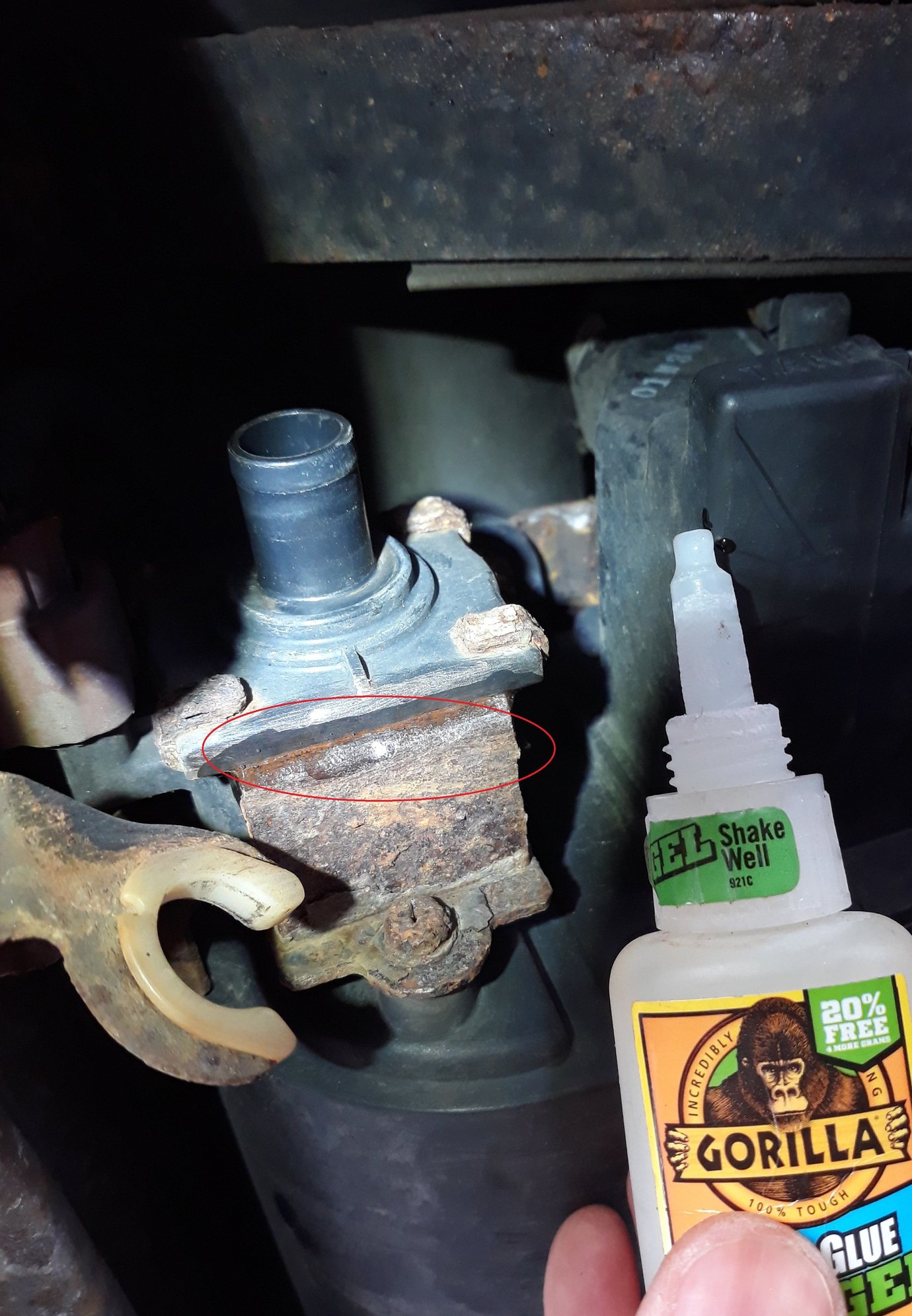

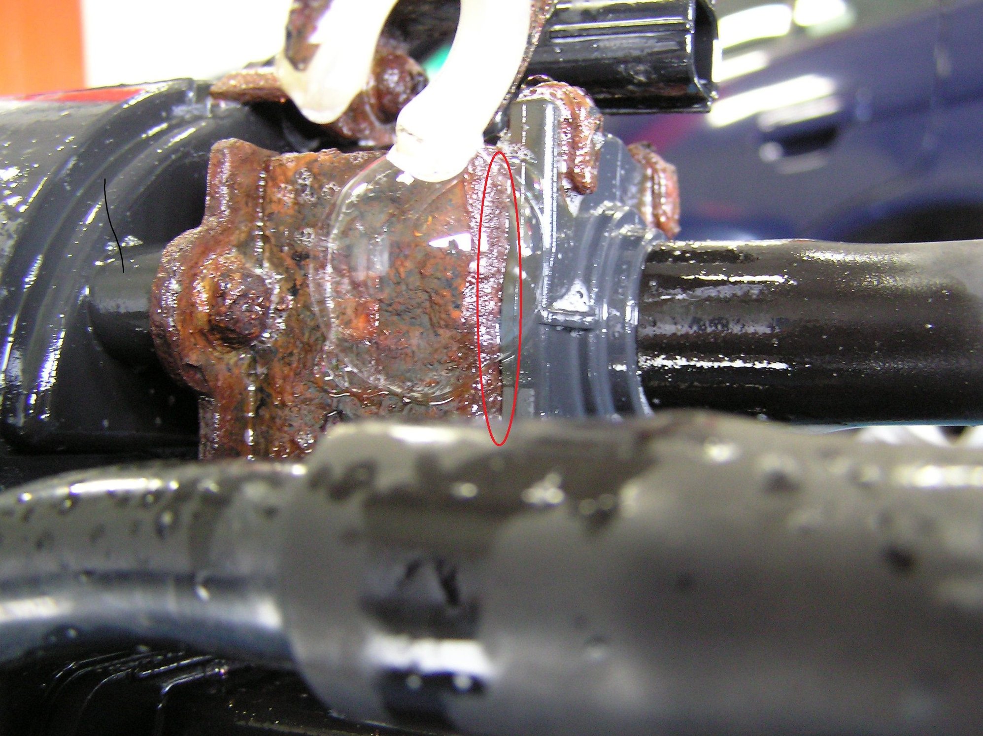

Here is the easy superglue fix:

May work as a temporary fix but I would not expect that to last long.
Yep, it will be back after the next winter, maybe even after a couple heavy rains
