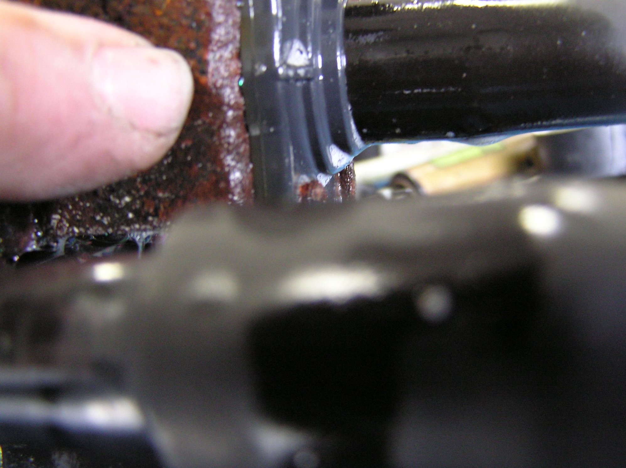

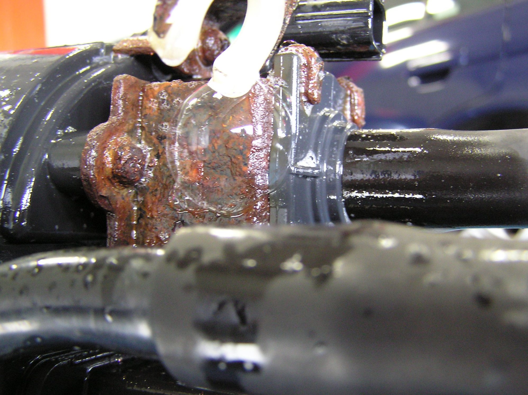

If it looks like this, it's junk.
Pressurized to 1 psi, and sprayed with soap+water

i had code P1457 before, my problem was the valve in the pictures,
i removed the screws by grabbing the head with vice grips and turning them, you will never do it with a screw driver
