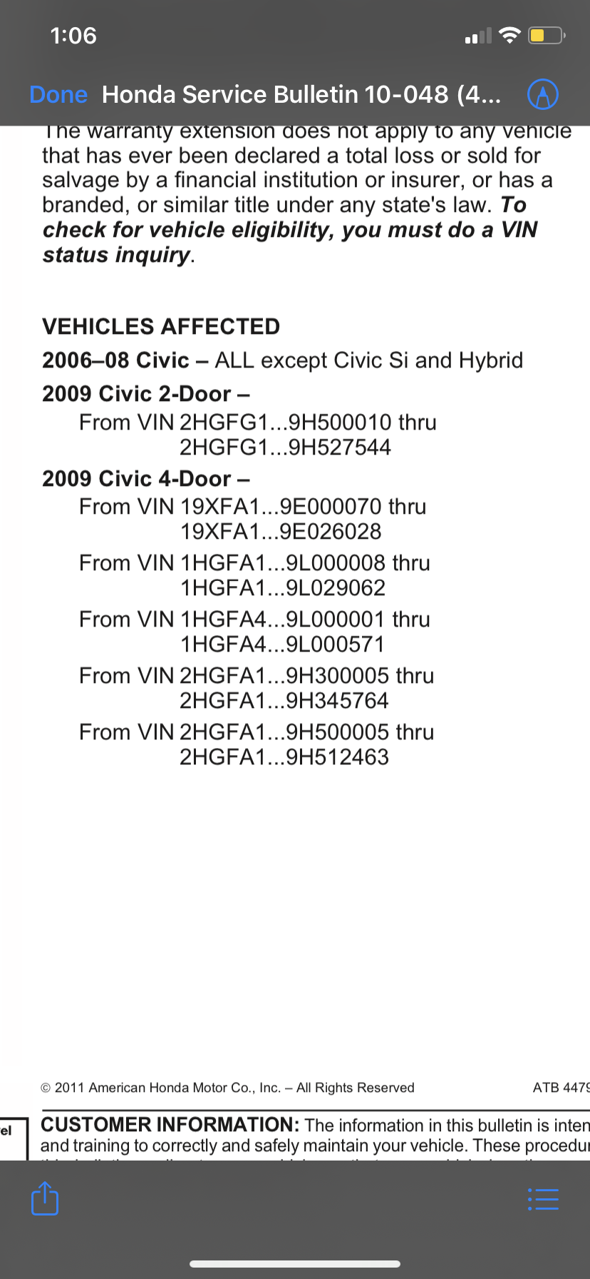

I am looking at an 09 civic. I know of the issue with early production #s that had the cracked block . My question is the TSB only states the 1st 3 digits of the vin> I had a website that had the actually range in serial # range but lost it. Does anyone know the FULL range of serial #s ? The TSB does not.
ALL VINs beginning with 1HG, 19X, and 2HG – Check eligibility with a iN VIN status inquiry.
The local dealers are useless. Thanks

Search for Honda bulletin 10-048, you can easily find it online. Also moved your thread to the appropriate section. There are other threads here for this issue.

just found this! Hope it helps!
