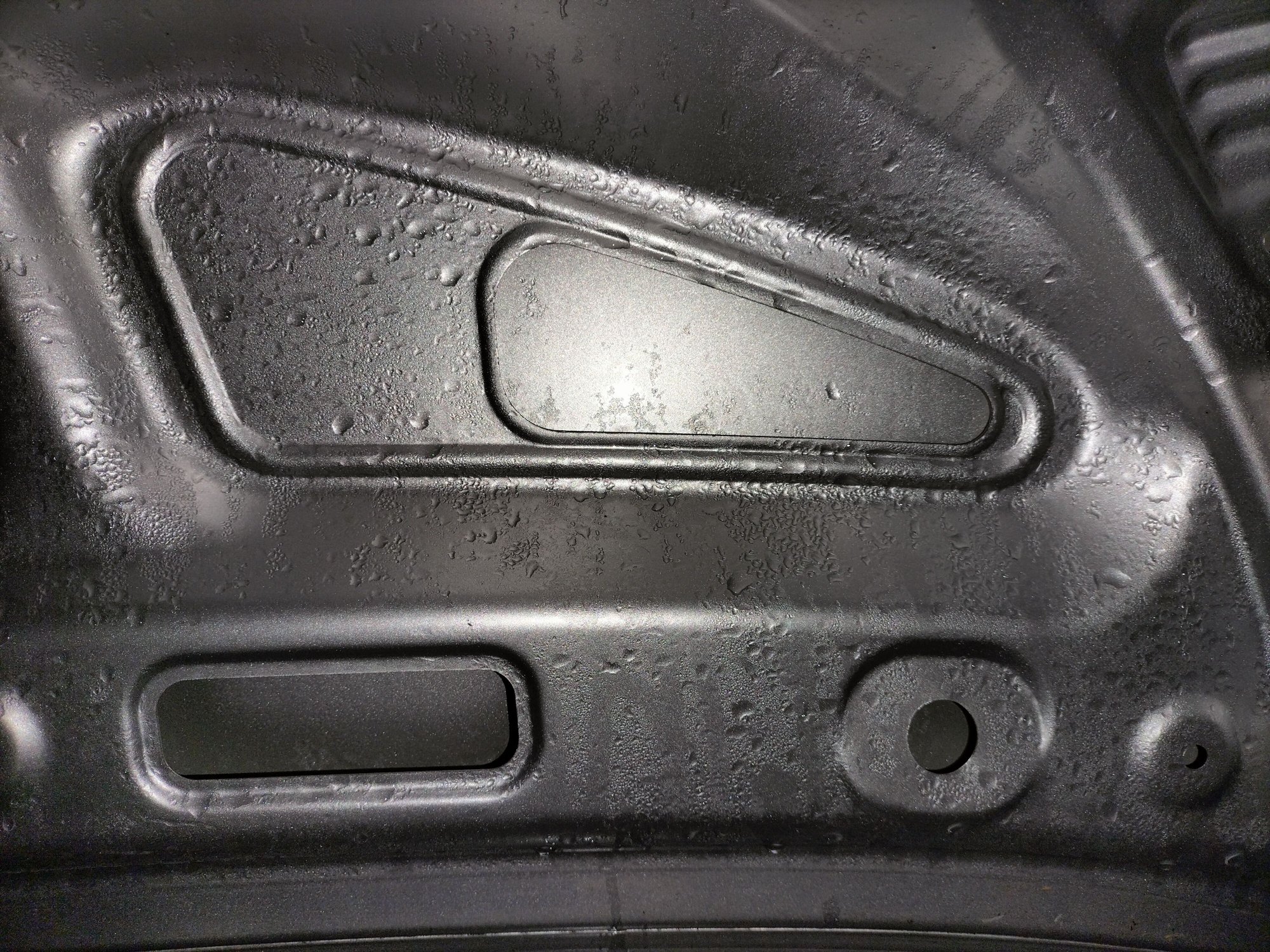

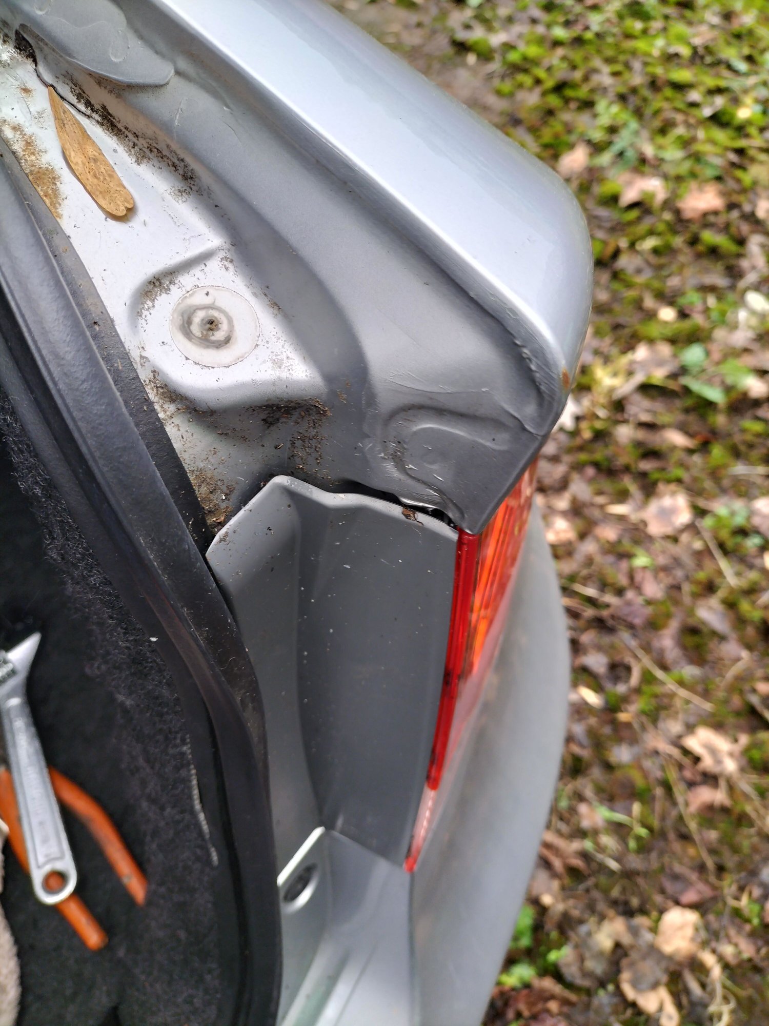

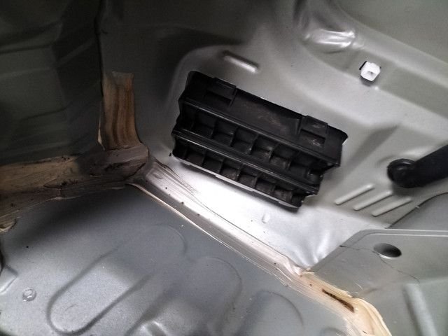

I have a 2006 civic saloon, and there is water in the trunk in and around the spare tyre, which I found to forming where ever there is metal inside, and dripping after forming in the trunk's ceiling which is metal as well, due to cold weather, I live in a rural area, and car is parked in open parking.
The car is not used often, and I'm worried about rust which is now visible under the spare tyre.
Any advise on how to find the source of opening, and stop the water from forming in the trunk ceiling, or dripping into the spare tyre area.
Of note is that the water forms on the inner side which tells me there is no water sliding and leaking inside, but because its very cold water forms on the inside from some opening.
These are the openings I have found so far.
Water forming inside the trunk underside

I couldn't find a leak on a 2007 Civic sedan I had either. Ended up chalking it up to road spray coming in through the vent or the rusty fenders. Sold the car afterwards.
The little flap for the key cylinder in the truck lid was also stuck open. That could have contributed but it's not a very big hole.

Seems like it would be in the seal around the trunk lid. The one time (on a previous car) I had that it was the weld at the seam in the upper corners of the trunk lid which was not completely flat and therefore not allowing the seal to close onto it. I added some silicone sealer and that stopped it.
But that was after I was able to identify the leak as being in that corner.
