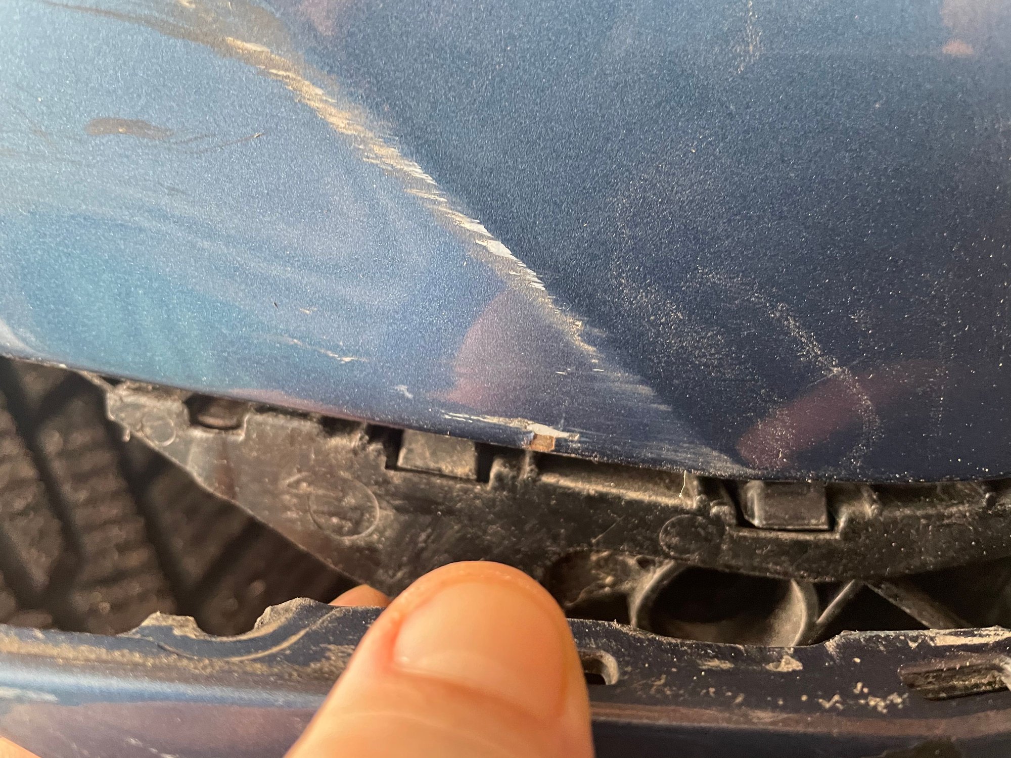

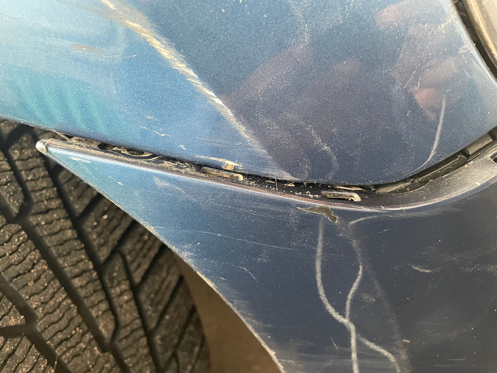

Hi,
Is there an easy and relatively inexpensive way of fixing a front bumper on a 2009 Honda Civic that came loose or do I need to take it to a body shop?
Thanks!
Top Answer
Jan 16, 2021
xRiCeBoYx
Rep Power: 513
Re: Front Bumper Came Loose
You can always pop it back in the clips and hope for the best. Unfortunately, the part that actually holds the edge down is broken (the broken piece to the left of your thumb is supposed to be a hole for a screw to pass through and secure it in place)
I don’t see why you couldn’t just zip-tie it back on
Is that safe?
Ok thanks. I was wondering why it wasn’t staying when I tried to pop it back into the clips (which I wasn’t very successful with either).
I was able to attach the bumper back on using the screw that was still there. It’s secure now.
