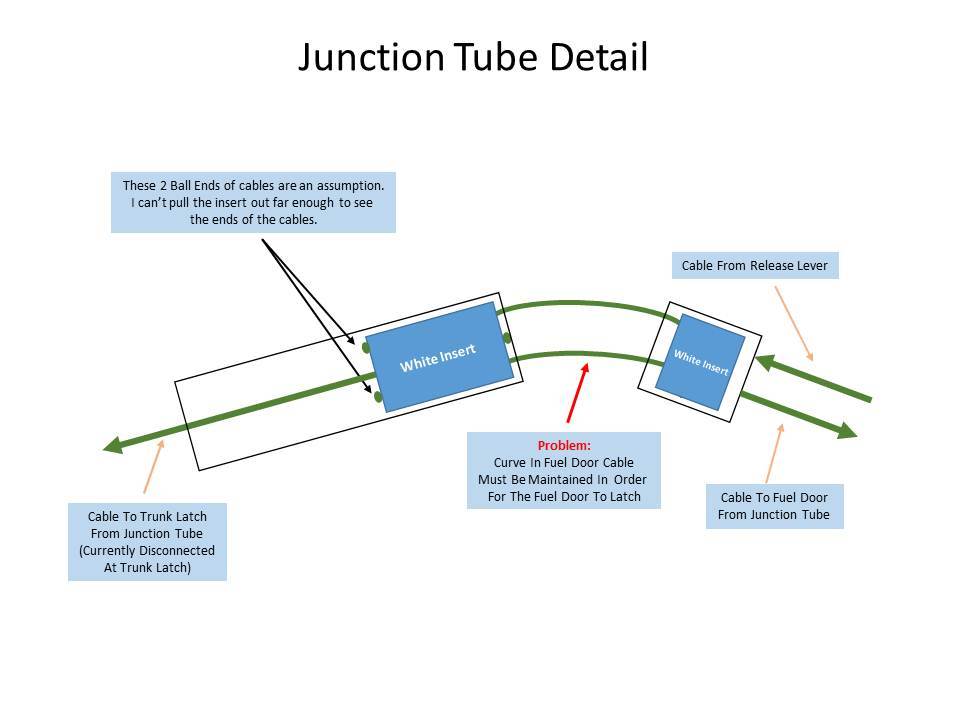

After putting the release mechanism back together, I went into the trunk and pulled the felt back to see what was going on with the cable. The attached images show what I found. The position of the junction tube is kind of it's "natural position" at this point based the tensions in the cable. I can move it all around and it goes back to it's current "curved" position. The "curve" is kind of the main problem as described in the text.

As you can see from the text, I can't put the junction tube back together because just as soon as I begin to rotate the long side of the tube upwards to insert it into the short end, the fuel door pops open and won't latch again until the tube is opened up and placed in the position shown in the pictures.
Now, I will admit that I did not try to put the junction tube back together and then reattach the trunk cable to the trunk latch. Perhaps pulling the trunk cable will do something to the fuel door cable, but it doesn't seem like that will help. Since I have never seen the cable in it's "proper" position I'm not sure if hooking it all back up will change it's behavior and lead me to the root cause of the problem. Has anybody seen anything like this before?
Am I looking at buying a new cable and replacing it?
Thanks for any advice you can offer.

Your "curve" is where the housing split apart and won't stay latched together.
I'd replace the cable.

Yes, the curve is where in the housing is split. However, it will stay latched together. It didn't "split apart" on it's own, the previous owner opened it up. I can easily latch it back together, but as soon as I start to do that, the fuel door plunger retracts and the fuel door opens. The plunger stays retracted until I open up the housing again and the curve returns to the cable.
As I mentioned in my post, the previous owner open it up in a effort to get the fuel door to work. He correctly felt that having the fuel door work was more important than the trunk since the trunk can be opened with the key.
I probably will.

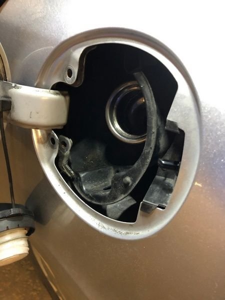

DerbyDad03, there's no need to damage the plastic adapter (plastic "housing" that surrounds the fuel filler tube) without lowering the fuel filler tube.
Push the adapter INSIDE the body instead of pulling it out.
The procedure for the cable replacement like you mentioned can be found at: Trunk Lid Opener Cable/Fuel Fill Door Opener Cable Replacement
... but BEFORE step 4 do the following:
a. Unscrew the two 10 mm bolts holding the fuel lid hinge.
b. Starting close to the hinge carefully push the end of the fuel filler cap adapter INSIDE and going around the perimeter walk the whole adapter INSIDE the body.
c. Remove the lid with the hinge
d. Turn and tilt the fuel filler cap adapter as you need and you will have plenty of space to do step 4 i.e.: remove the grommet (B) from the body while pinching the hooks (A) from inside the vehicle.
Do step 4 and complete the procedure listed in the manual.
Assemble in the reverse way.
