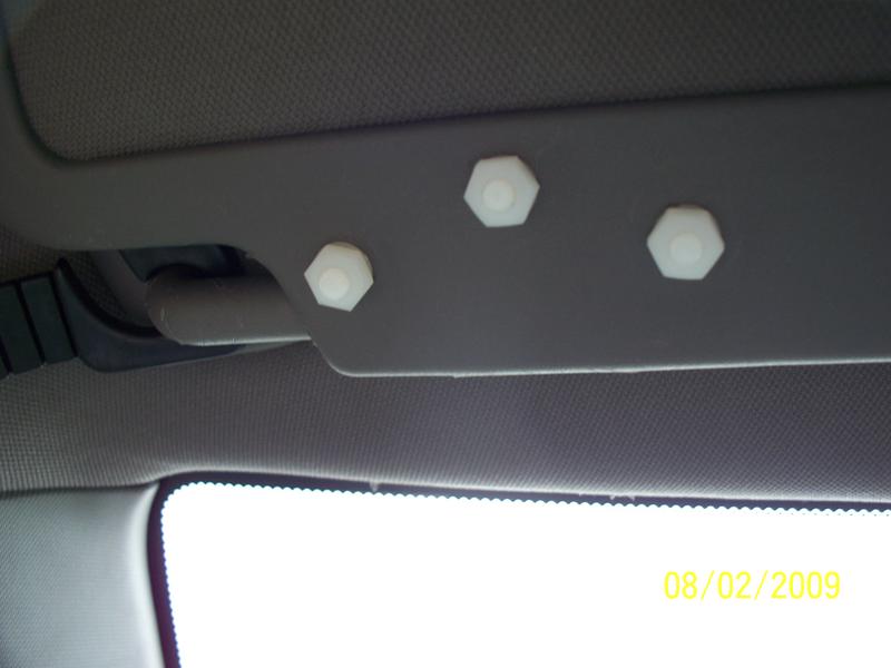

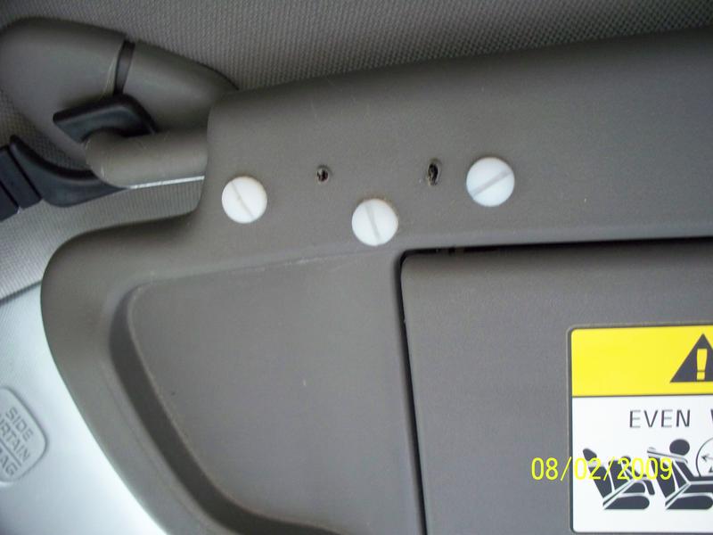

My visor on my `06 Civic LX coupe split at 108,000 mi. These pictures are of the fix I did by fastening the two halves of the assembly together with 1 ¼" long nylon machine screws and nuts. Note the placing of the holes, to stay clear of the steel spring assembly inside. It works fine. This is best if done before the housing splits so far as to break the plastic rod guides.
Name:	Civic visor 001.jpg
ID:	77247   Click image for larger version
Name:	Civic visor 002.jpg
