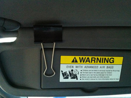

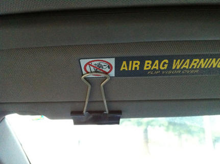

Fortunatley mine still stays in position but the plastic has broken. So it doesn't go back up without special treatment. Been thinking of this cheap fix and finally did it today. Metal spring clip (big one). I just put it on and seemed to work so I'll give it a try the next few days. If that fails, I'll follow up.
ID:	81626   Click image for larger version
