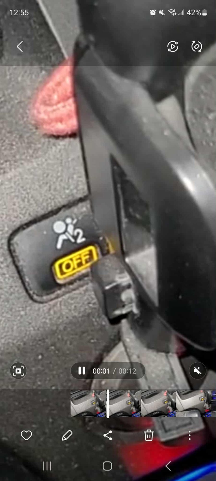

Hi. I have honda civic 2007. This thing shows off. It looks like airbag function is off. But on which side, I do not know. It is off sometime and on sometimes. Nothing shows on the dashboard.
Last year Honda dealership called me and said something like recall issue and they replace the airbag one driver or passenger side. Now I am seeing this for at least 6-8 months.
Can you please tell me what is this? how serious is this? and How to fix this?

does it indicate on (i.e. the "off" light not illuminated) when there's someone sitting in the passenger seat? There's a weight sensor that disables the passenger side airbag if someone <65lbs is sitting there (of if there's no passenger)
