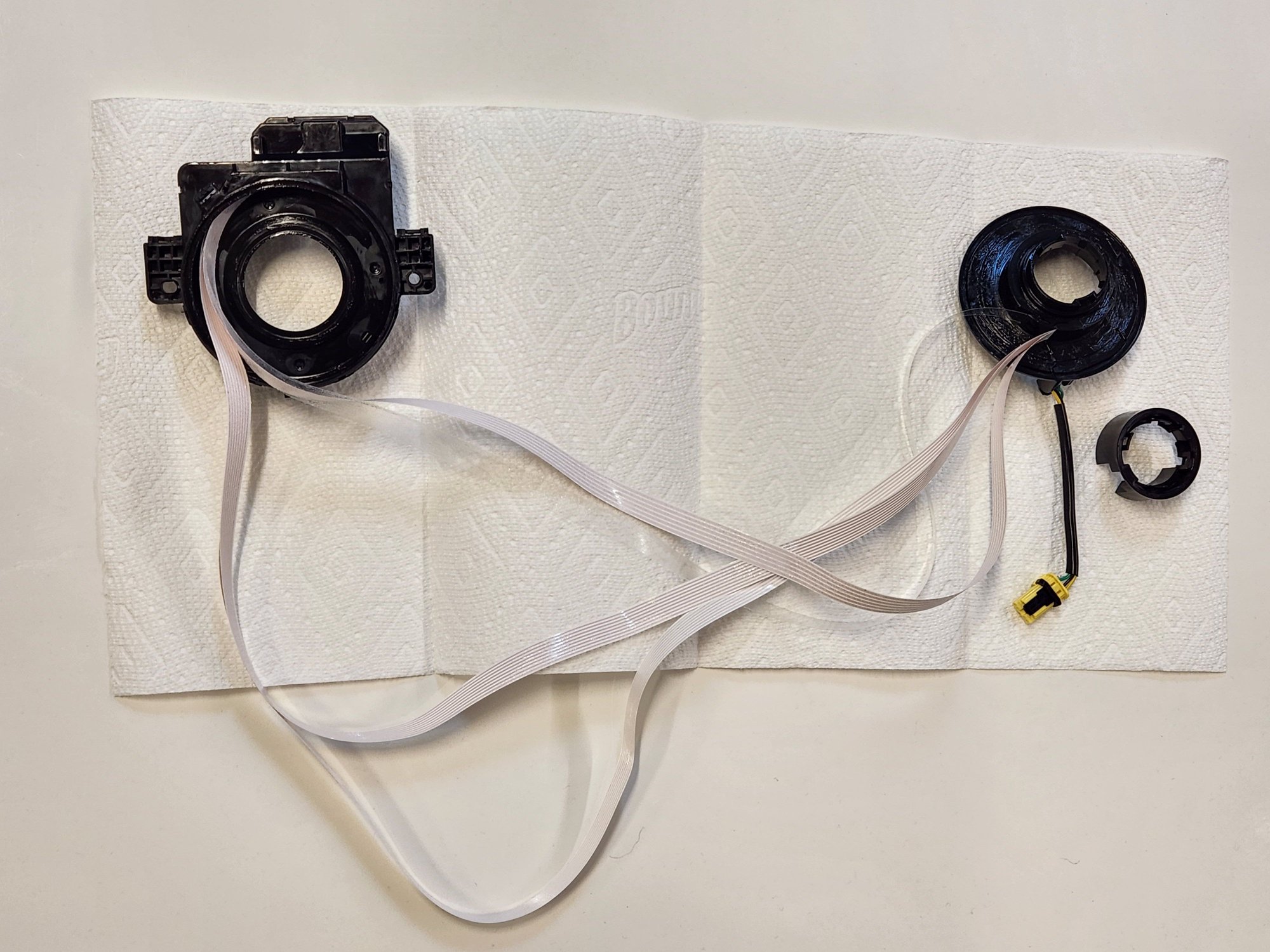

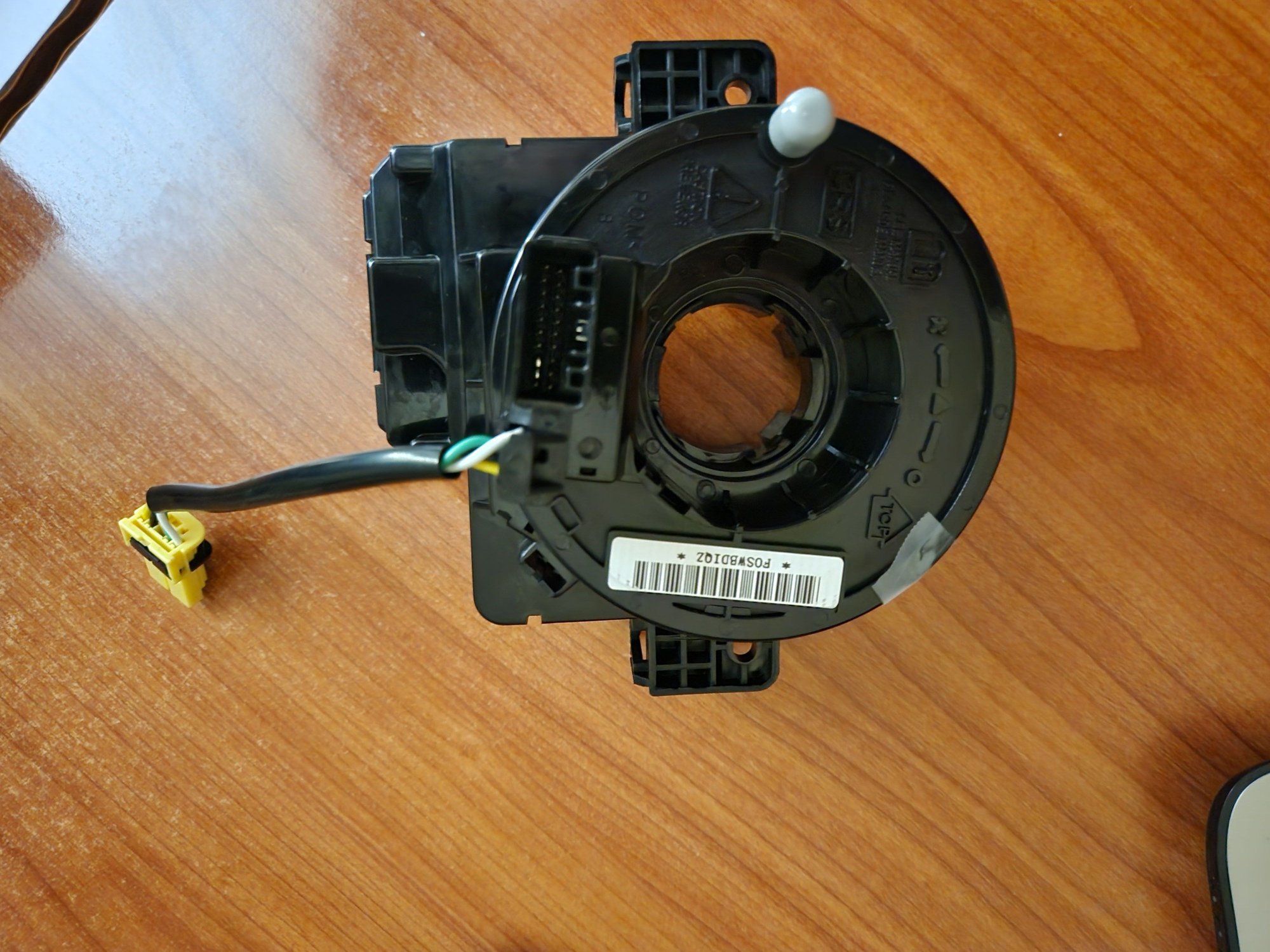

Second point: the steering wheel airbag and ALL the steering wheel switches connect to the car via a "clockspring" -- it allows you to turn your steering wheel back and forth without tangling up all the "wires".
The clockspring is a complex part which has long "flat-flex-cables" all coiled up. There's a kind of slippery grease which allows the cables to slide on each other. I bought a cheap clockspring on eBay and took it apart to see what's inside. Attached are some photos -- the flat-flex-cables are very long, about 3 feet.
The photos show an intact clockspring and a clockspring taken apart. (To be continued...)

Hi Jeremy, here's Part 3, "long answer (cont'd)":
You can see the clockspring is pretty complicated -- I think a weak spot in the design. The internal grease allows the cables to slide, and I'm GUESSING that -- if the grease dries out or gets stiff (as in my case, the car sat idle for MANY months) -- the cables can pull on each other and perhaps intermittently disconnect (??).
Anyway, Honda charges about $100 for a clockspring, but you can get one on RockAuto for about $40. There's actually a YouTube video on how to replace it, if one is DIY-inclined. (Search YouTube for "2012-2015 Honda Civic Airbag Clockspring Replacement DIY" and look for the post by "Civic Minded").
