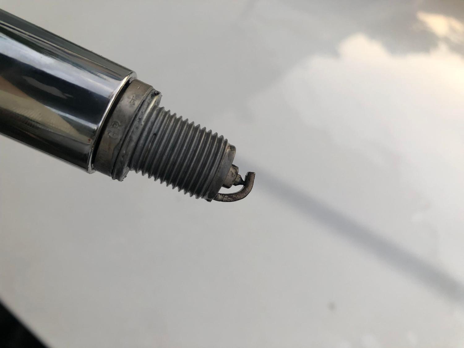

So another update. So during this process I had put some pregaped plugs in. And the engine was knocking. No codes thrown. I then put in the original plugs in and same noise. Yday I took the old plugs back out and put the new ones in and the noise disappeared. I also unplugged the coil on each cylinder while running one at a time to see if the noise disappeared. I inspected the old plugs I pulled and notice the 3rd cylinder plug had looked like it wa hit and closed the gap almost to it touching. This was also a plug I had to let soak in on blaster and put a nice ammt or force to brake it loose to get it out. Now the sound is gone. Still no code thrown. Engine starts perfectly fine with either plugs in now as well

so after replacing the spark plugs i had a misfire in cylinder 3. i pulled the plug and no gap again. i replaced the plug and problem happened again. i have now noticed the knocking noise is coming right after the plug gap closes. i noticed the ignition coil doesn't seem to have the same resistance when i pull it off the plug like the other 4. so i put in another plug and then i swapped the ignition coil from cylinder 4 and 3 and the plug closed on cylinder 4 and not 3.

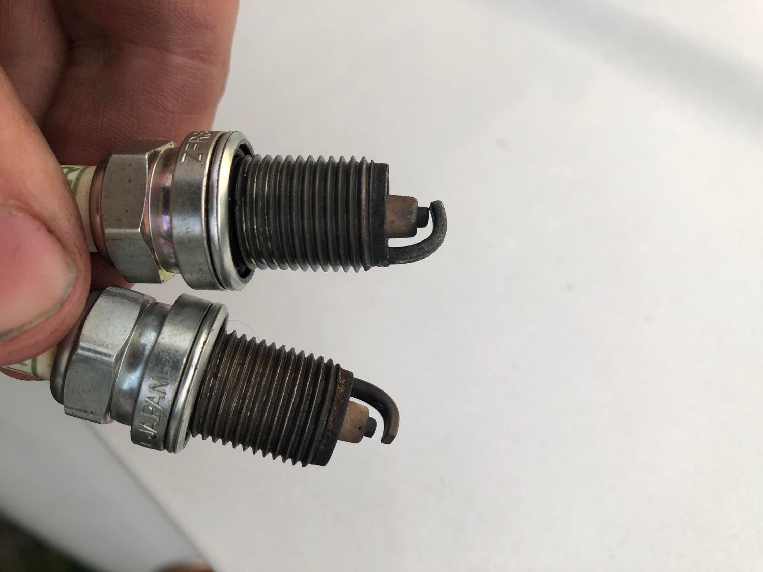

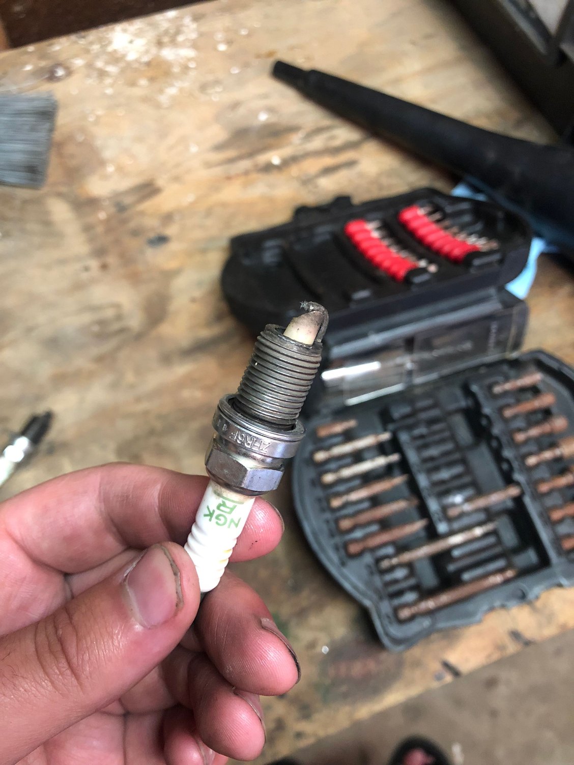

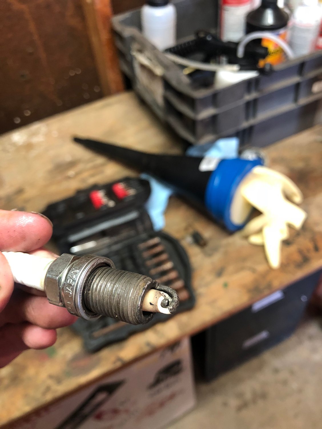

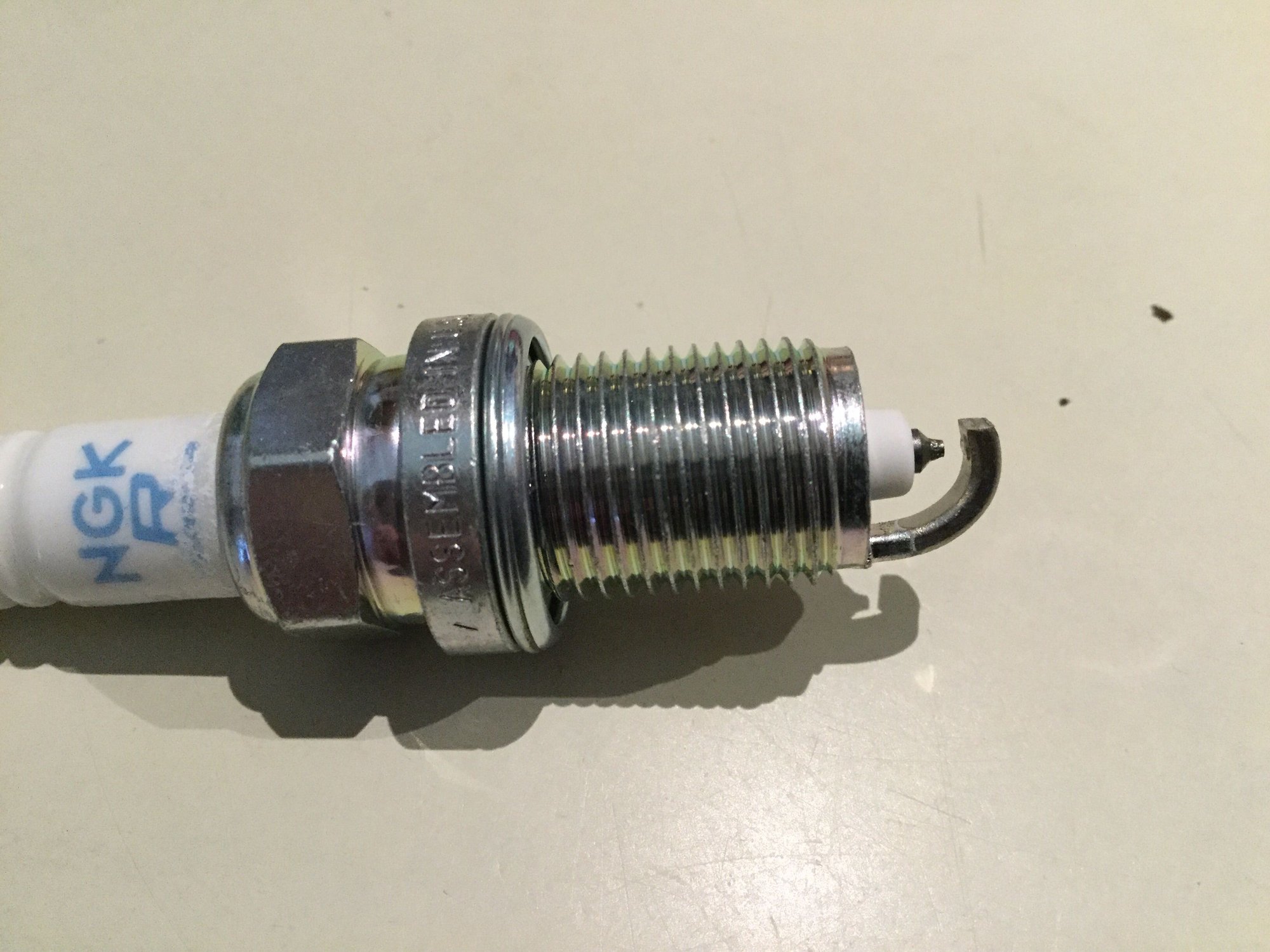

i agree i am going to try to change coil and see what happens. the 2nd picture are ngk plugs that was in before i owned. the higher picture are bosch double iridium plugs. all parts installed on car are from local part store. those plugs were like $11/each

Both of your pictures show a closed gap plug, top picture looked like older plug due to compression ring being caked in gunk.
Bosch looks similar to NGK

top plug is new plug. that is anti seize you are seeing

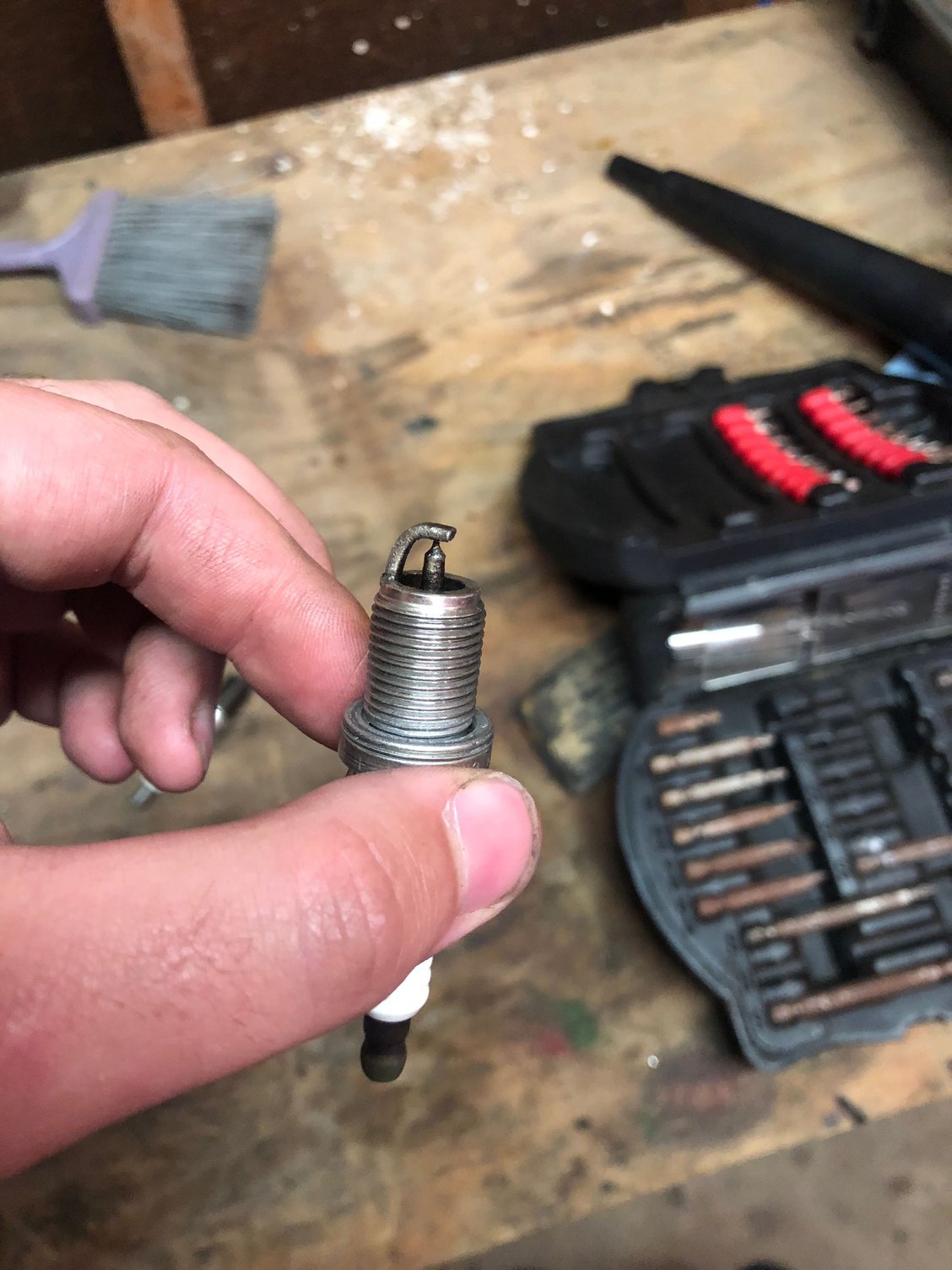

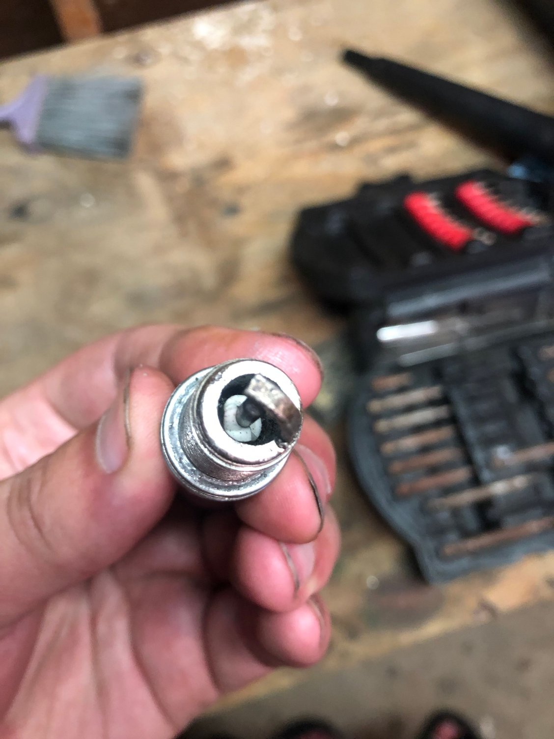

So now it has actually broken the spark plugs in cylinder in 3 and 4.

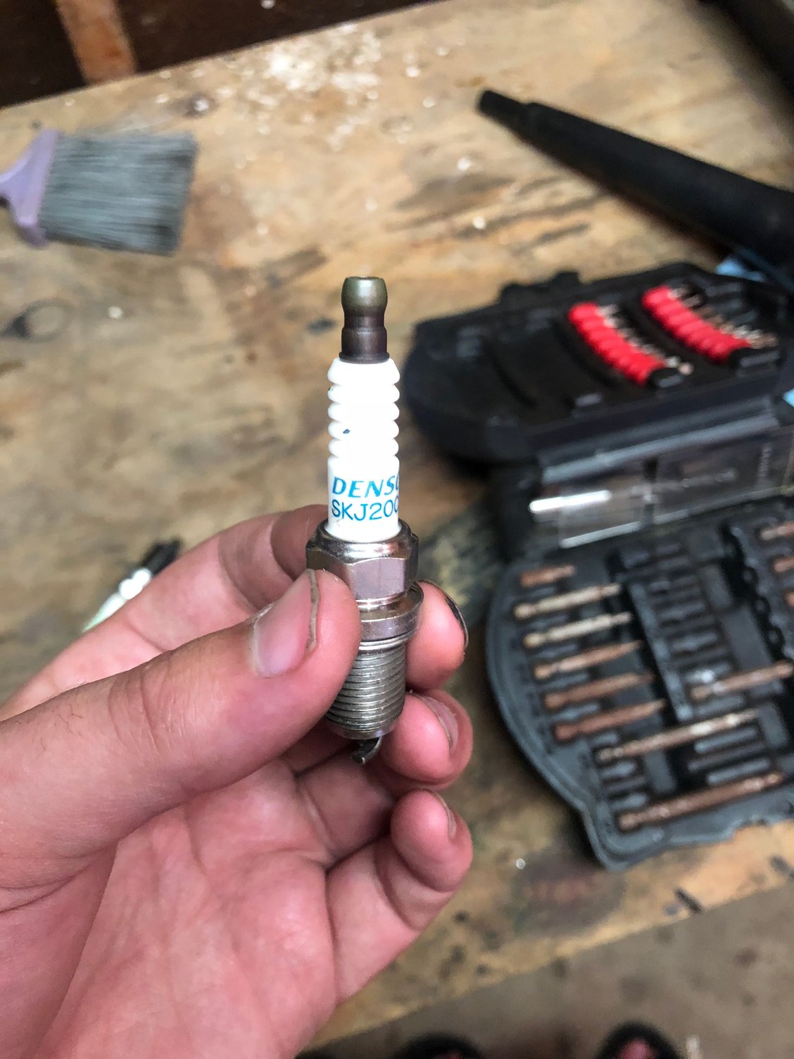

I was wrong though. They arnt bosch they are Denso
